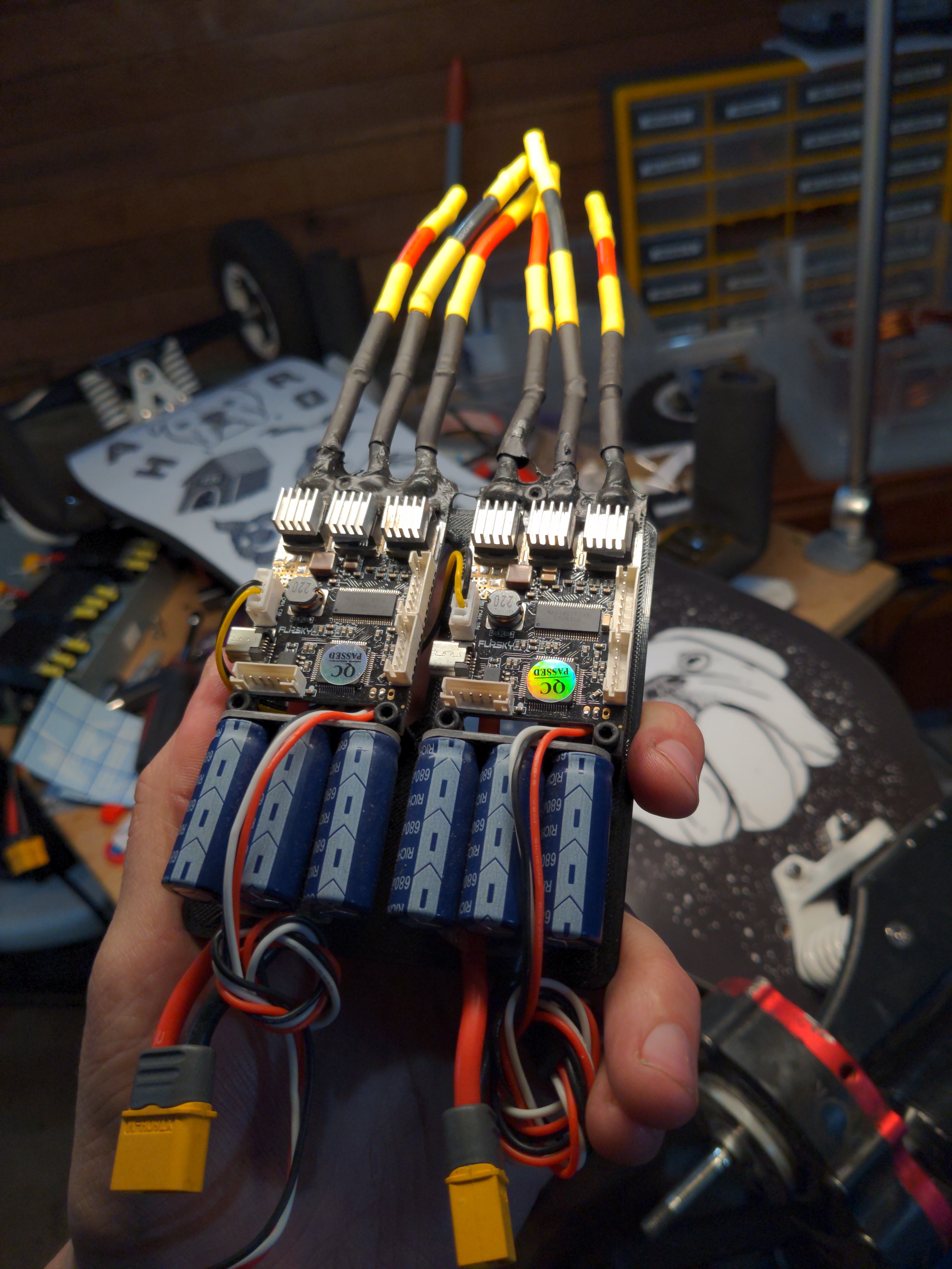

Well, itā€™s possible itā€™s damaged. Itā€™s also possible itā€™s just a Flipsky. Interesting it failed at exactly 35amp on two drv over current errors
Try it with 35 motor amps, 25 battery.
Be careful, please. You might have a bad ESC.
These are the pair I have. I can safely run them at 45-50/35 motor/battery, but Iā€™m not sure of this revision vs yours. Theyā€™ve changed a lot but thereā€™s a lot of old inventory floating around. None of it is great because flipsky :confused:
Yeah itā€™s strange it performed so well one day and the next itā€™s almost wrecked. Iā€™ll turn it right down and take it slow for a bit and if it continues at that level I am going to have to assume its bad.
Although it isnā€™t getting DRV error.
Actually the above errors first two are from the previous time I had not cleared the terminal the latest error that really let me know there was an error (after changing the settings) looked like this. - 62.3 current? @DerelictRobot
