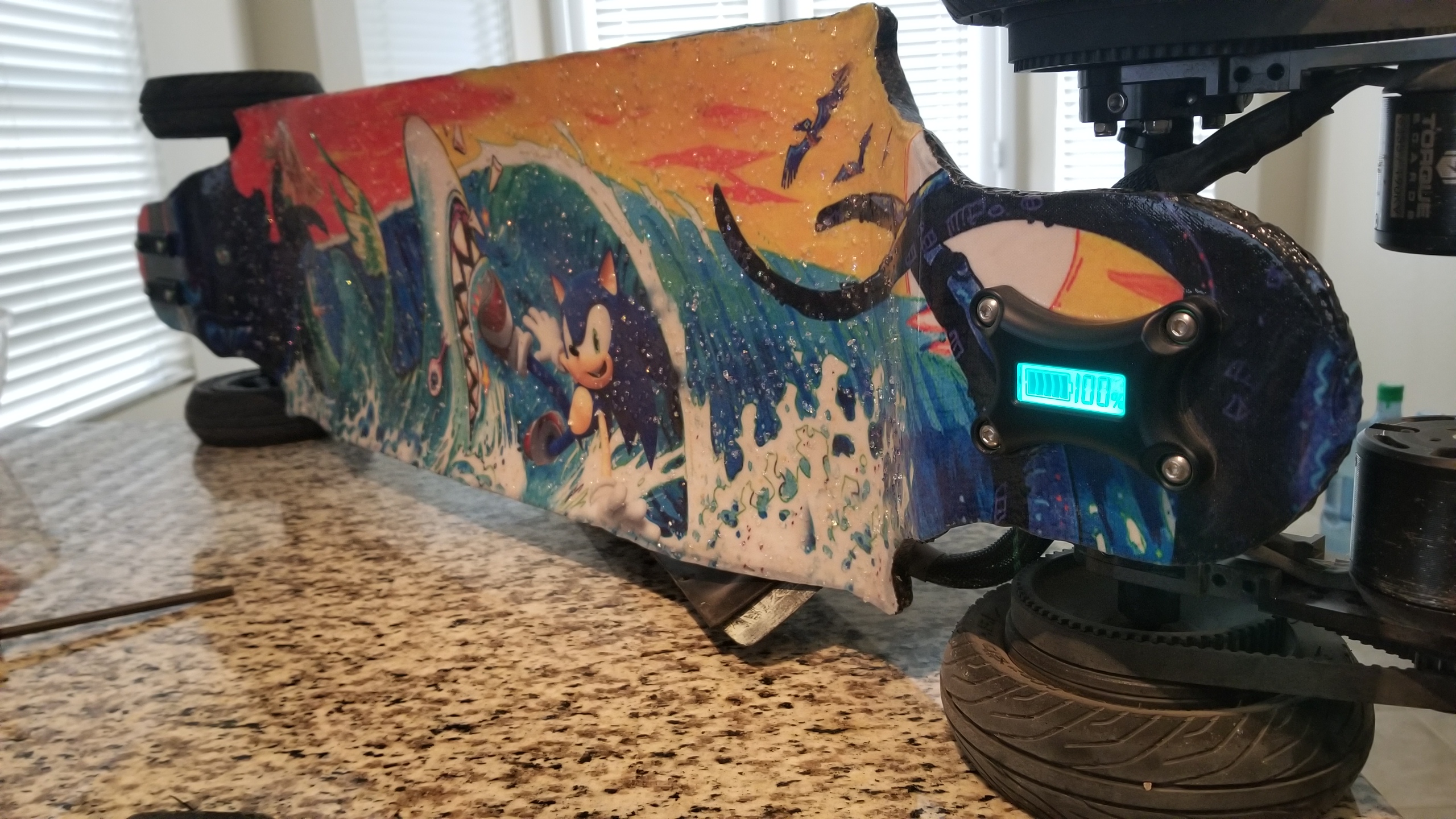

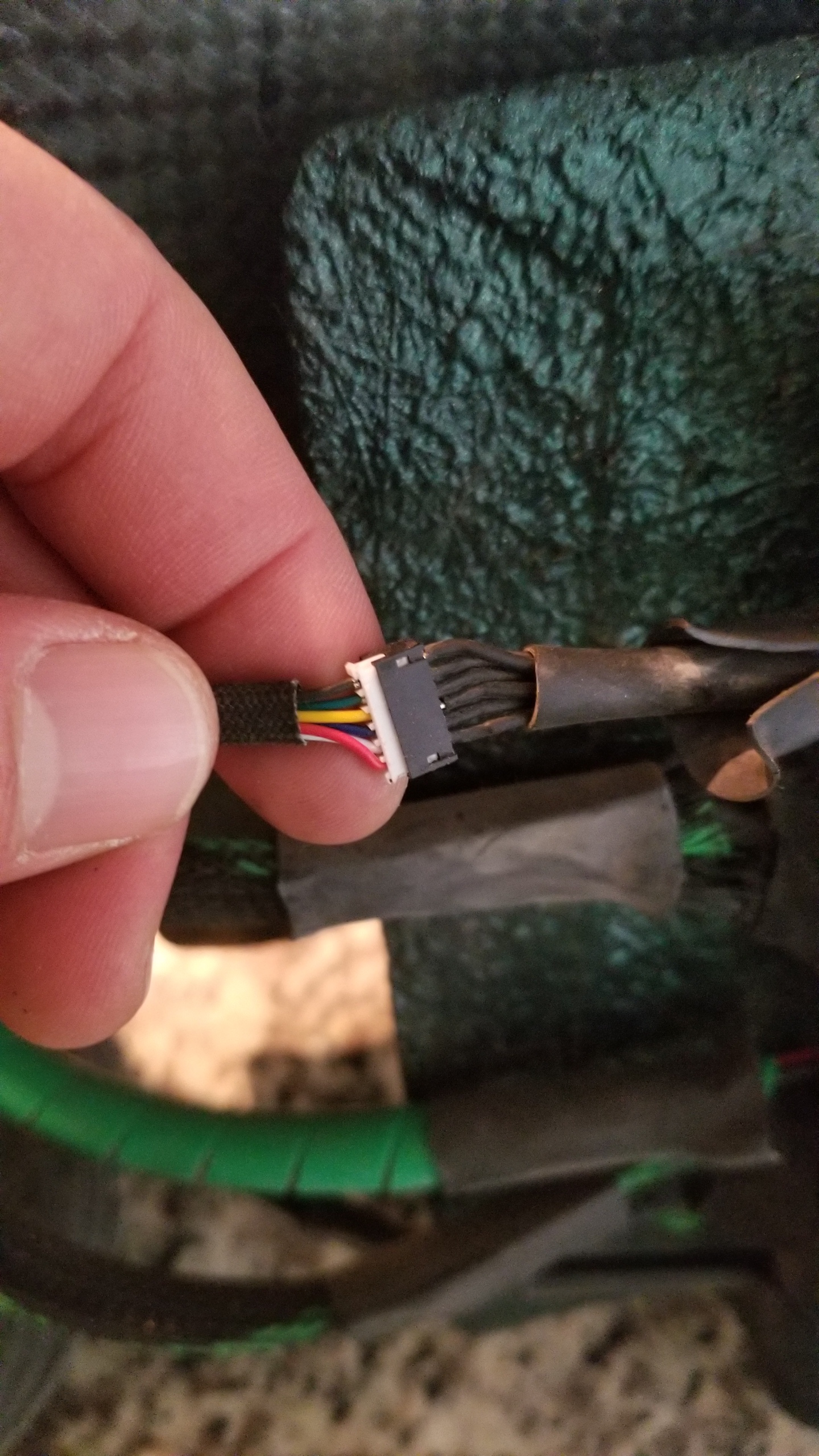

I was riding and noticed the power is only like 60% what I’m used to, I looked back and saw my battery meter was at 100% after half mile when usually it’s already at like 75%, I noticed This connector came loose, I plugged it back in restarted board and it’s still showing 100% battery even after I rode it another 1.5 miles. I check and battery meter solders are still in tact. Any ideas on this? Also should add I have a 3dsevisas anti spark inline too.
To give any kind of intelligent answer, we need more information, including but not limited to such details as: What does that connector go to? What’s your battery configuraiton? What’s your vesc configuration? Is your battery meter set correctly? and many more.
As it stands, your question is equivalent to going to a mechanic and saying “my car is making a funny sound after I unplugged a thing. What’s wrong with it?”

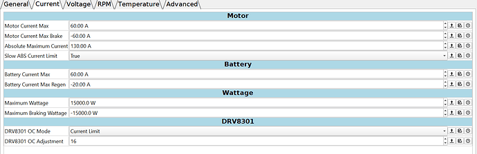

I’m happy to have more conservative settings if it means it wont die like this. at present its very powerful anything I should change?
Everything is pretty much default from ackmaniack tool except regen

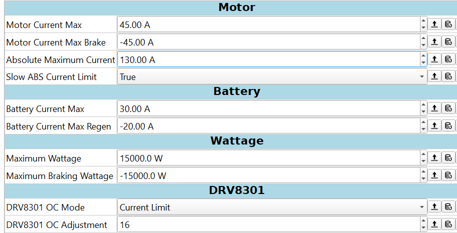

I can give you some settings to try if I know what your battery can deliver
That is good to hear!
5 of these in series / 10s2p
So you’ve got plenty of battery amps available, more than you’ll need to power one motor but your ESC will handle how much current to use.
I would recommend 45 motor amps and 30 battery amps to start with. You might try 50/35-40 motor/battery next. Your reverse current/Regen is fine, and usually to preference of brake responsiveness at high/low speeds.
Let me know if you have any further questions!

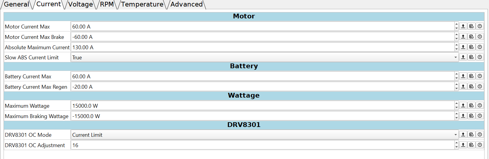

So does below look better? If it’s lacking in power (as I have hectic hills here) what the max I can really afford to go to without breaking stuff? 50a?
@DerelictRobot main question as you already answered the above really, is do I need to change the “Absolute Maximum Current” or is it fine as is?
