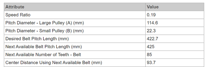

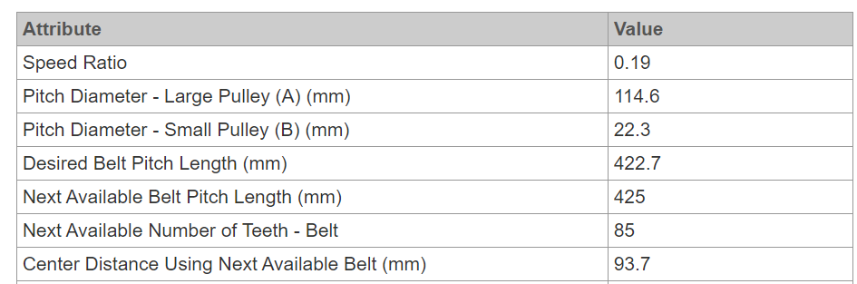

I usually do the string trick to figure out my belt lengths.
But I’d like to order my belts before my pulleys got here this time.

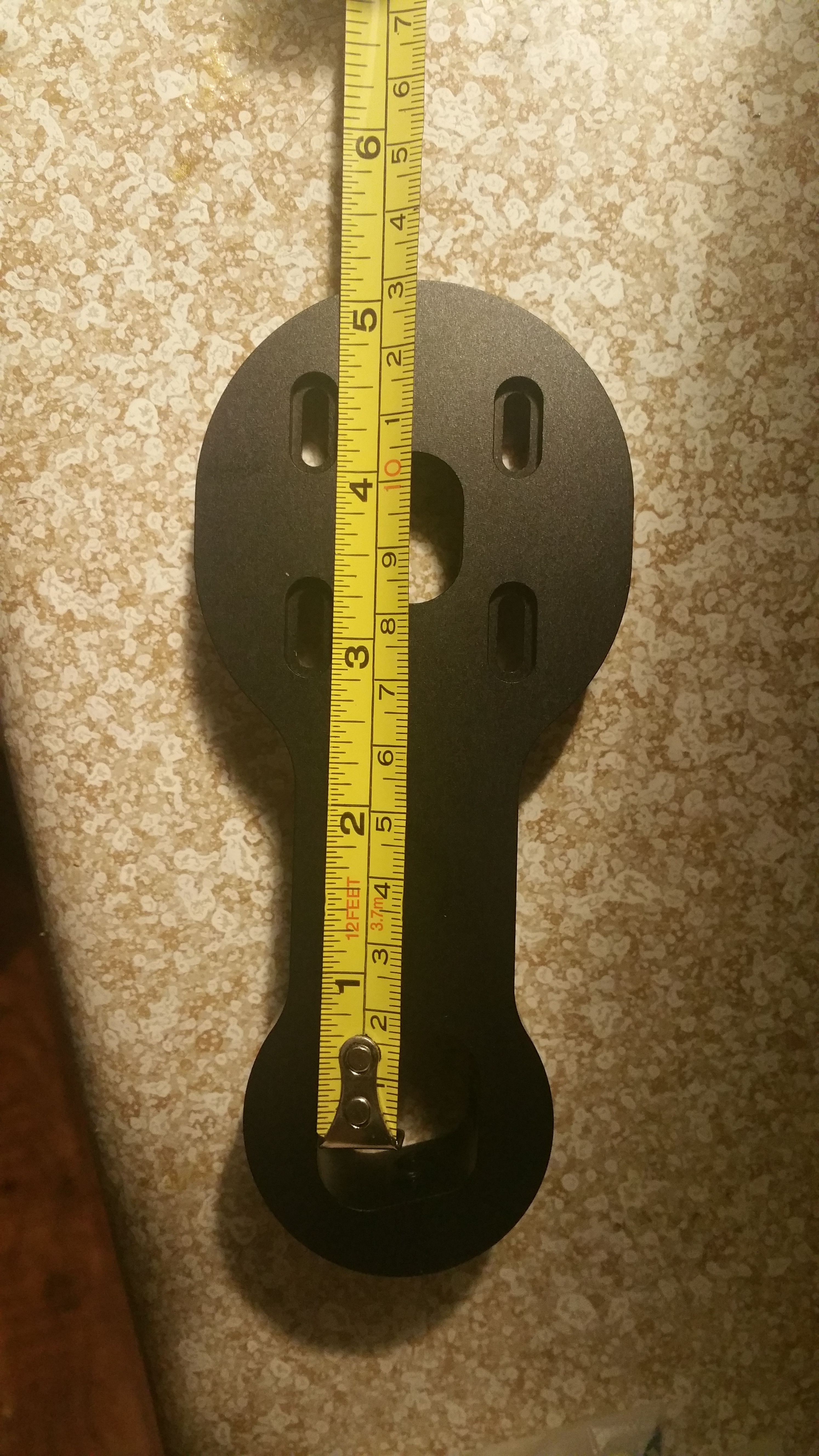

Could someone help me figure out what I needed with just measuring the mounts and knowing what size pulleys I’ll be using?
14t/72t
Its just over of 92mm (about 92.075)
Center to center
@DerelictRobot

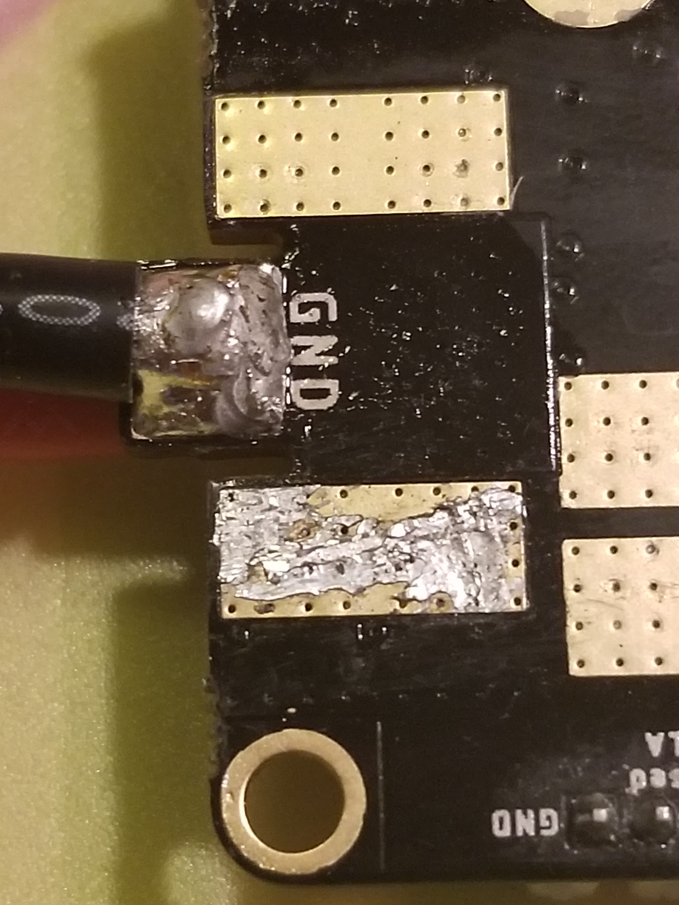

Got some solder on the back of my unity while trying to solder on some better wires. Is this okay?
14:72T - 92mm CTC
Looking like 425mm is about on the money.
Damn okay. I was thinking 420. But the only belts eboard solution sells with the mounts are 410 ( but thier wheel pulleys are 68)
Thanks dude
Is there any adjustment on your mounts?
68 to 72 is a 20~mm increase in circumference at htd5
Yeah.
Might try and find 15t x20mm motor pulleys too
Nevermind that, I think it is okay, seems fine running my board around the block a few times. Though can’t figure out how to limit my erpm on the unity electronically. Anyone using unity know how to limit max erpm?
Try SDP/SI, that’s where I got my belts.
They have loads of pitch lengths, should be able to find 425.
Actually, here’s a link to some 425s of various widths.
Damn they go from 15 mm with to 25mm. Néed 20mm
Hmm…
You sure 15 isn’t wide enough? I’d assume it’d be plenty strong for most use cases…
Unless you’re climbing like 90 degree hills or something :stuck_out_tongue:
I bothered getting 20mm pulleys. I wanna use them lol
Fair enough. If you’re really set on it I think they do custom cuts, but don’t quote me on that one.
