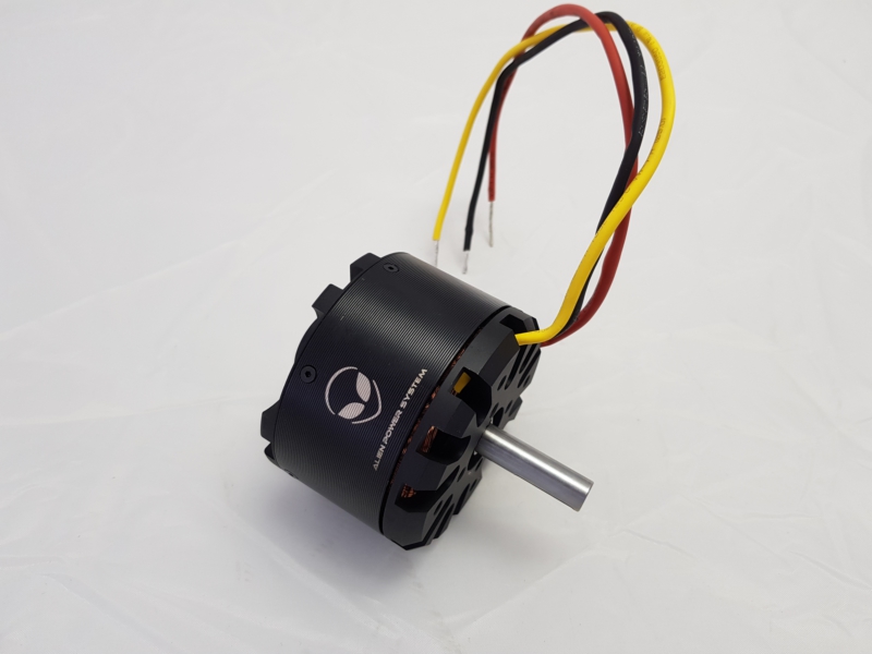

I’m looking for something in the 63xx range but since I’m using standard calibers I can’t go over 55mm length…
Also I’m not trying to get a new battery, just connect my existing 2 packs in series rather than parallel. The only cost would be a new bms and charger.
Then hands down torqueboards 6355.
or i just found these aps 8055 160kv that have 4500W lol
