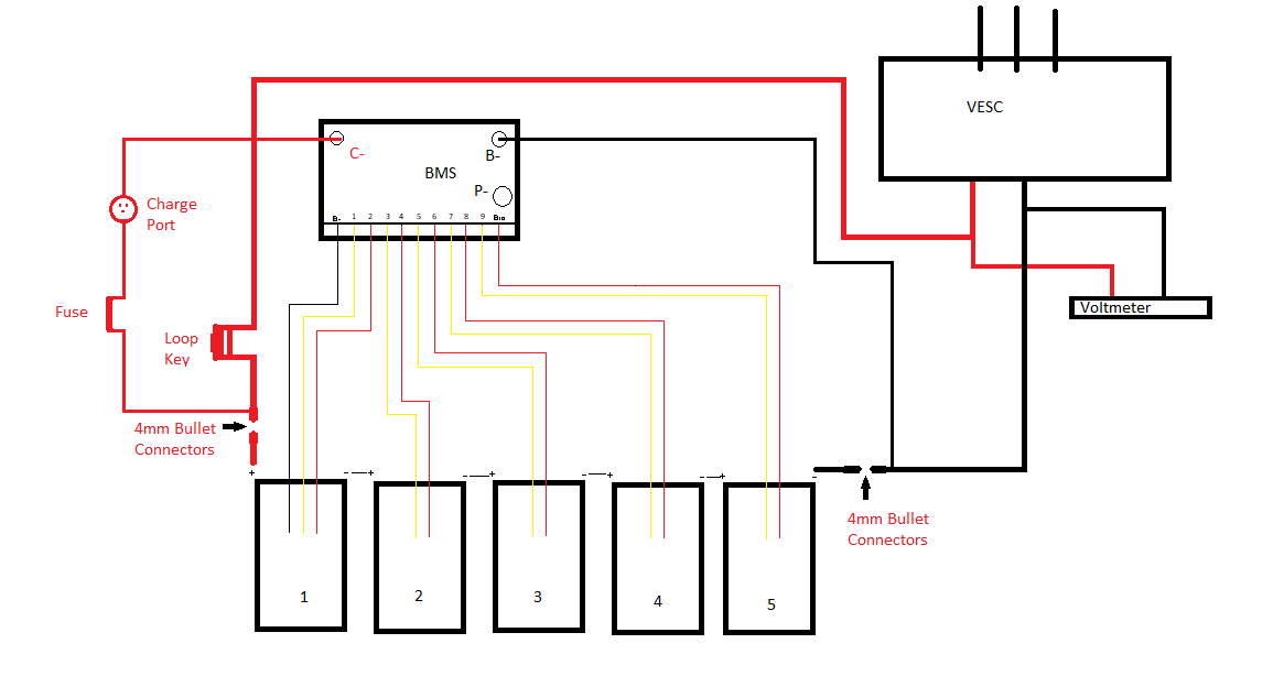

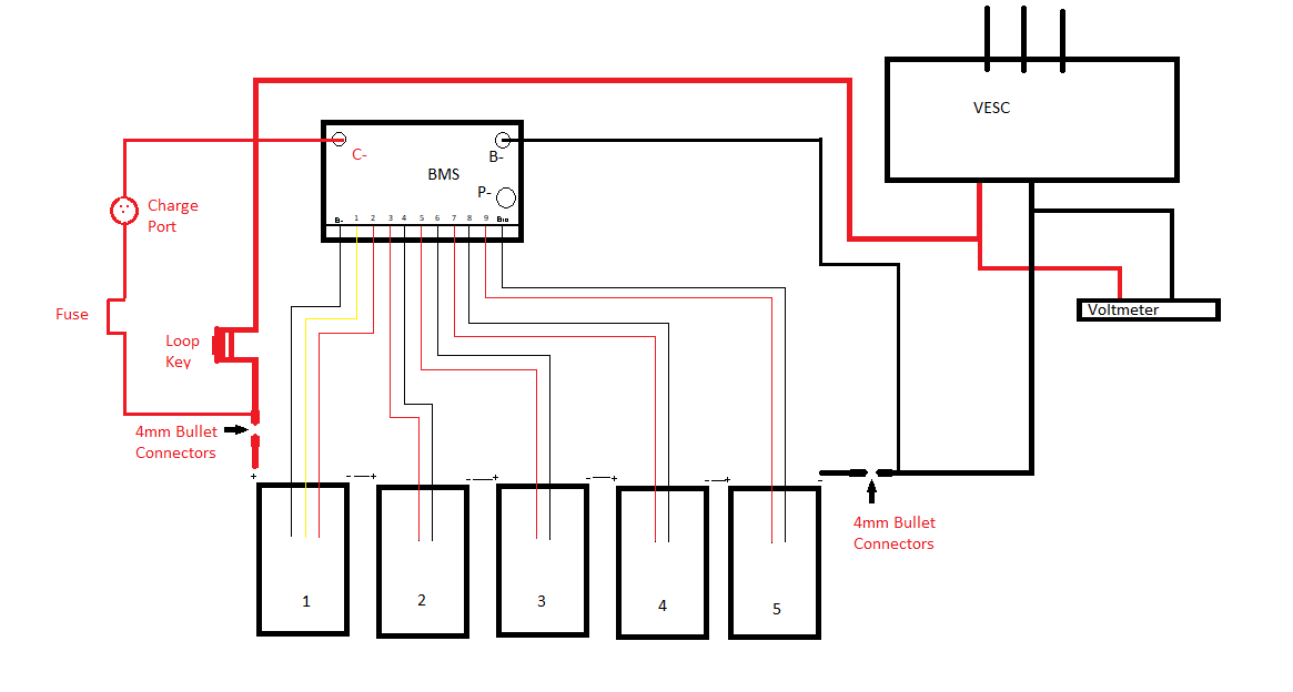

With your most recent diagram, the charging port will work whether the loopkey is in or not.
To make it work only if the loopkey is in (why?), then the wire for the charging port needs to be on the vesc side of the loop key, not the battery side.
Other than that, the main power connections look good. The balance leads look… ambiguous.

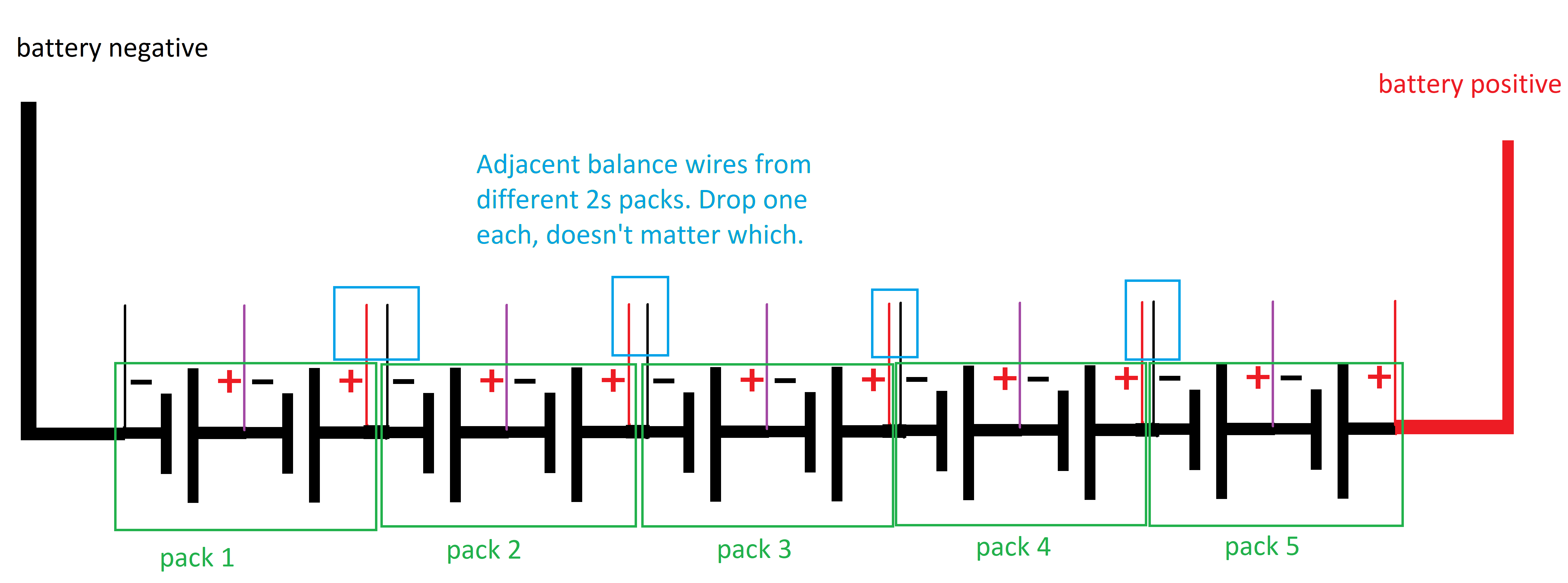

Each 2s pack will have three balance wires coming from it: Positive, negative, and the intermediate (between the two cells). When connecting them in series like this, you have to drop (not use) one wire from each pack except the one on the negative end - That one gets all three. But each of the other packs, you only use the intermediate, and the positive.
This is why I recommend drawing out your individual cells, not just the packs. It’s too easy to get turned around and short something.
Thanks again for the explanation.
I’m not quite sure how to draw out the individual cells and balance cables might need to do some research and come back to that. Not in a rush to incorporate the BMS as it’s the highest fire risk so want to get it 100% before attempting. Charging with the balance charger goes ok for now.
I think the colours are incorrect on the diagram ie; it needs to be yellow and red not black and red but yeah I am only just starting to understand those things so I do want a definitive diagram that a few people have given the all clear on before I wire it up for good.
The reason it will only charge when the loop key is plugged in is currently I connect all the batteries in series with 4mm bullet connectors and because of where I am connecting the charge wires (on the bullet connector that is connected to the anti spark (rather then the battery) which then plugs into to battery positive it will only be on when the circuit is completed (as far as I am aware)
I just modified the diagram after looking at the BMS and I think this could be correct as per what you said with the 3 being used on the negative. Being the B- on the BMS before 1,2,3,4,5 etc.
And then the rest I need to check with a multi meter to confirm which is the correct one (I believe it’s yellow and red or white and red) that will be used and not black for the remainder.
I’m not clear on exactly what you mean. I’m just going off the diagram you’ve got there, and assuming everything is in its assembled state - bullet connectors plugged in. If you’ve got the bullet connectors plugged in like the diagram shows, the battery will charge whether the loopkey is in or not, because the charge positive wire goes straight from the port, to the battery. For the loopkey to interrupt the charge wire, it has to be on the other side.
Well I am glad you are reviewing my work! That is spot on which is actually great because I was only trying to avoid touching the battery cables and somehow thought that was affecting charging without it being on! Wow I feel dumb haha
I would have probably plugged the loop key in to charge for some time before realizing I didn’t need to. :joy:
While this is still good advice to follow, a lot of BMS have this wire internally and you don’t actually need to run it.
But unless you know that your specific BMS has it, then just hook it up anyway.
Also if the balance wire is smaller than 22AWG then sending all the charge current through it may be a bad idea anyway, though this usually isn’t the case as they are typically 22AWG or larger and charge currents are typically 4A or under
Mine isn’t specifically the Bestech its a cheap ebay one so I’d say if it doesn’t hurt anything to hook it up either way then it’s definitely better for me to hook it up.
Here’s a diagram showing the internal arrangement of cells and balance wires in a battery made of 2s lipo packs.
I used purple instead of yellow for intermediate wires, mainly because yellow is hard to see on my monitor.

Thank you for this, it’s kind of fried my brain in terms of what I need to do for the BMS but I understand the way the pack and cells are set-up better now for sure.
I’m not sure if I’m interpreting it correctly.
This is the latest diagram which I think is correct (not including the black wires on all of the cells except the first (B-)
