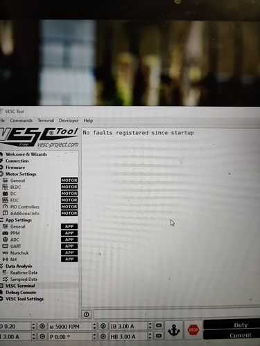

What’s this error cant see it in the video
Did you run the Print Fault directly after trying motor detection?
I did, in the red it says bad detection results received.
Can you switch motors and run motor detection again on both ESC’s? That way, you can narrow down if the issue might be related to the ESC or the motor.
I did it with 4 motors in total…

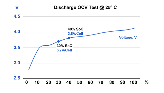

There is virtually no self-discharge below about 4.0V at 20°C (68°F); storing at 3.7V yields amazing longevity for most Li-ion systems. Finding the exact 40–50 percent SoC level to store Li-ion is not that important. At 40 percent charge, most Li-ion has an OCV of 3.82V/cell at room temperature. To get the correct reading after a charge or discharge, rest the battery for 90 minutes before taking the reading. If this is not practical, overshoot the discharge voltage by 50mV or go 50mV higher on charge. This means discharging to 3.77V/cell or charging to 3.87V/cell at a C-rate of 1C or less. The rubber band effect will settle the voltage at roughly 3.82V. Figure 1 shows the typical discharge voltage of a Li-ion battery.
Figure 1: Discharge voltage as a function of state-of-charge . Battery SoC is reflected in OCV. Lithium manganese oxide reads 3.82V at 40% SoC (25°C), and about 3.70V at 30% (shipping requirement). Temperature and previous charge and discharge activities affect the reading. Allow the battery to rest for 90 minutes before taking the reading.
Source: https://batteryuniversity.com/learn/article/how_to_store_batteries
