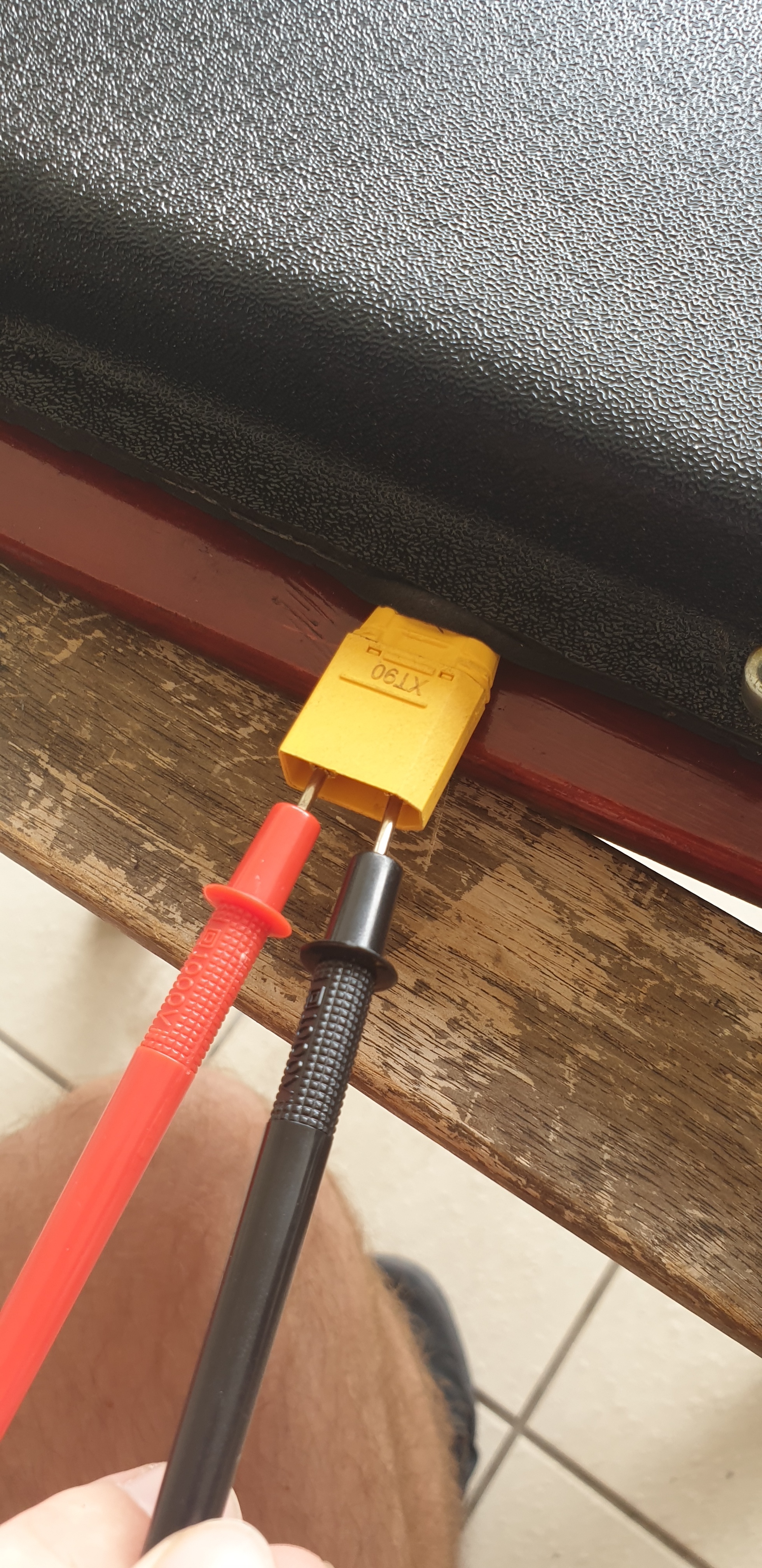

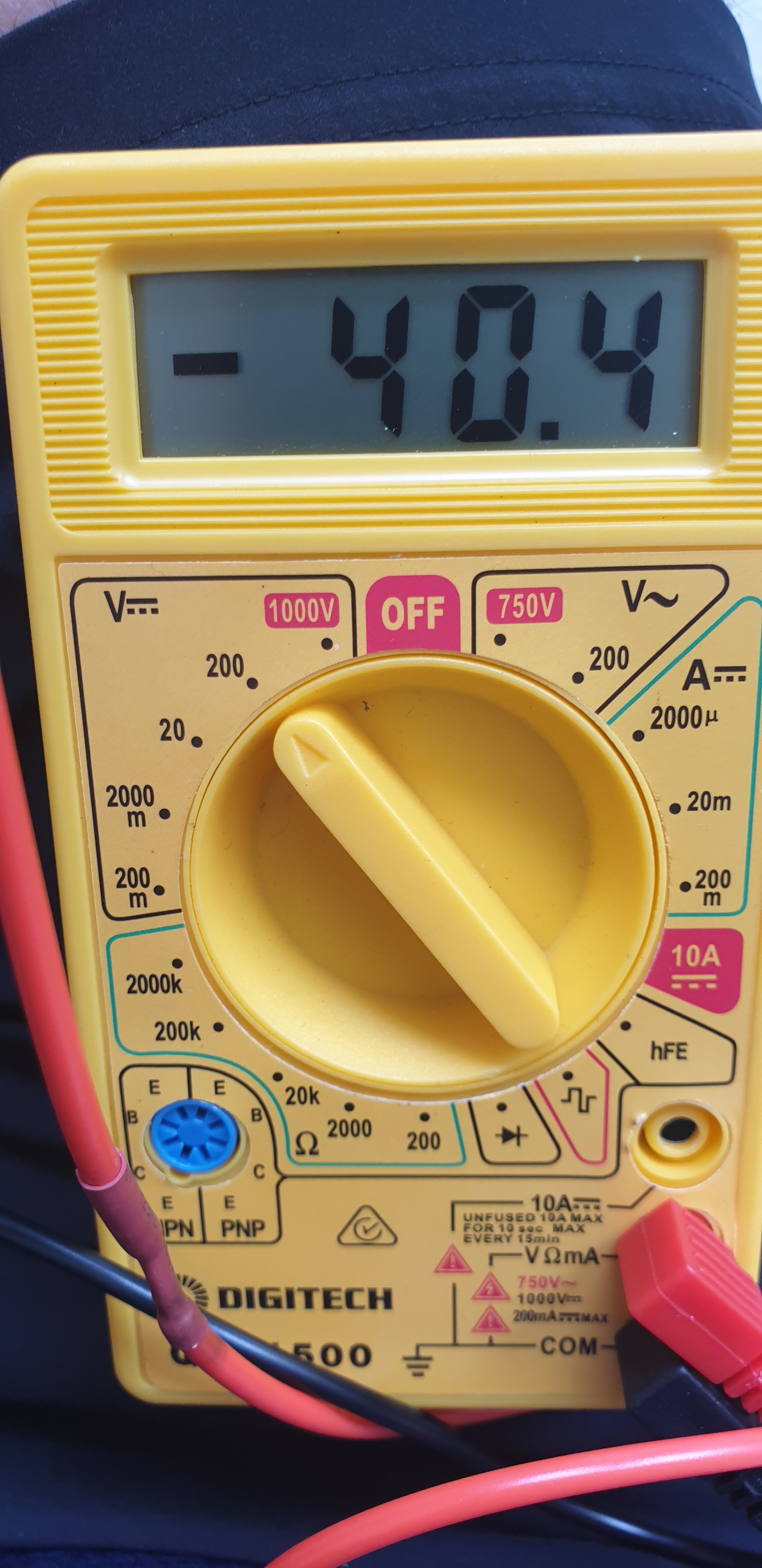

So my board is finally operational and in the interest of not blowing my batteries up I am wondering a few things.
I have yet to connect the BMS as I want to be a bit more sure about that before incorporating it. But in the meantime is this an appropriate way to check my packs voltage and determine when I should charge the batteries (individually with a balance charger)
Also at what voltage should I be concerned/charging them.

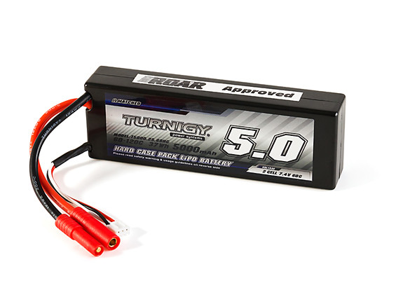

I have 10s 5x2s 5000mah
Still in progress of learning the best configuration through vesc tool for these batteries

For LiPo pouch batteries, the per-cell voltage range is roughly 4.2(full) to 3.5 or 3.7(empty) volts. So for a 10s battery, the overall pack voltage range is 42 to 35 or 37 volts.
You should check your individual cell voltages regularly (like, once every couple charge cycles at least) if you don’t have a BMS there to keep them balanced automatically. Your cells should not be more than ~0.05 volts away from the pack average. If they do drift, you will need to either manually balance them by charging the vol/discharging the high cells, or balance charge them with a hobby charger.
thanks for the response, at this stage i plan to balance them all individually with a hobby charger I do have a BMS that I’ve mostly wired but I need to do a bit more study before I am confident using it. Plus I have to splice it onto the battery cable which I’m also considering cutting all the connectors of the batteries and soldering them together but need some more confidence in the board generally operating before doing that.
So if it gets to say 35/37 volts in total I I should probably charge them? I’m not even taking it out for a proper ride yet as I don’t have the gear I want to safely do that.

Yep. Don’t let them get any lower than that, and you’ll be fine.

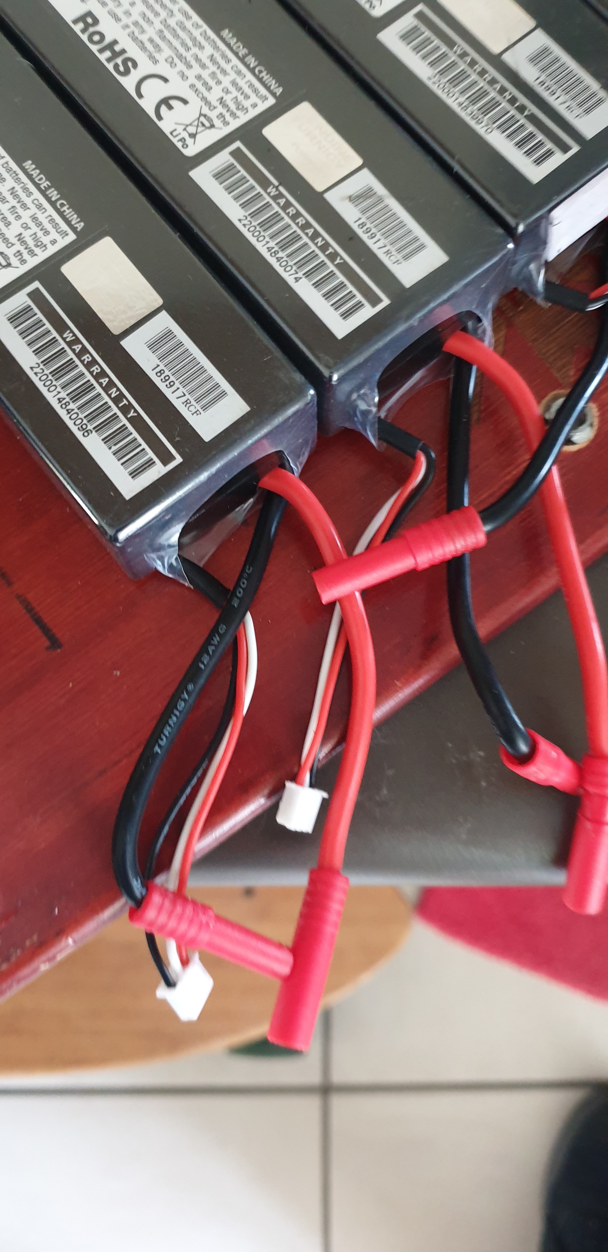

Is my understanding correct that these balance cables (JST connections) are for charging and the (bullet connectors) are for discharging?
So when charging Lipo with a hobby balance charger you charge with just the balance cables connected? And only need to connect the bullet connectors if you are discharging for storage etc?
Previously I connected all of the cables but considering cutting the bullet connectors off the batteries to manage the cables better within the enclosure
