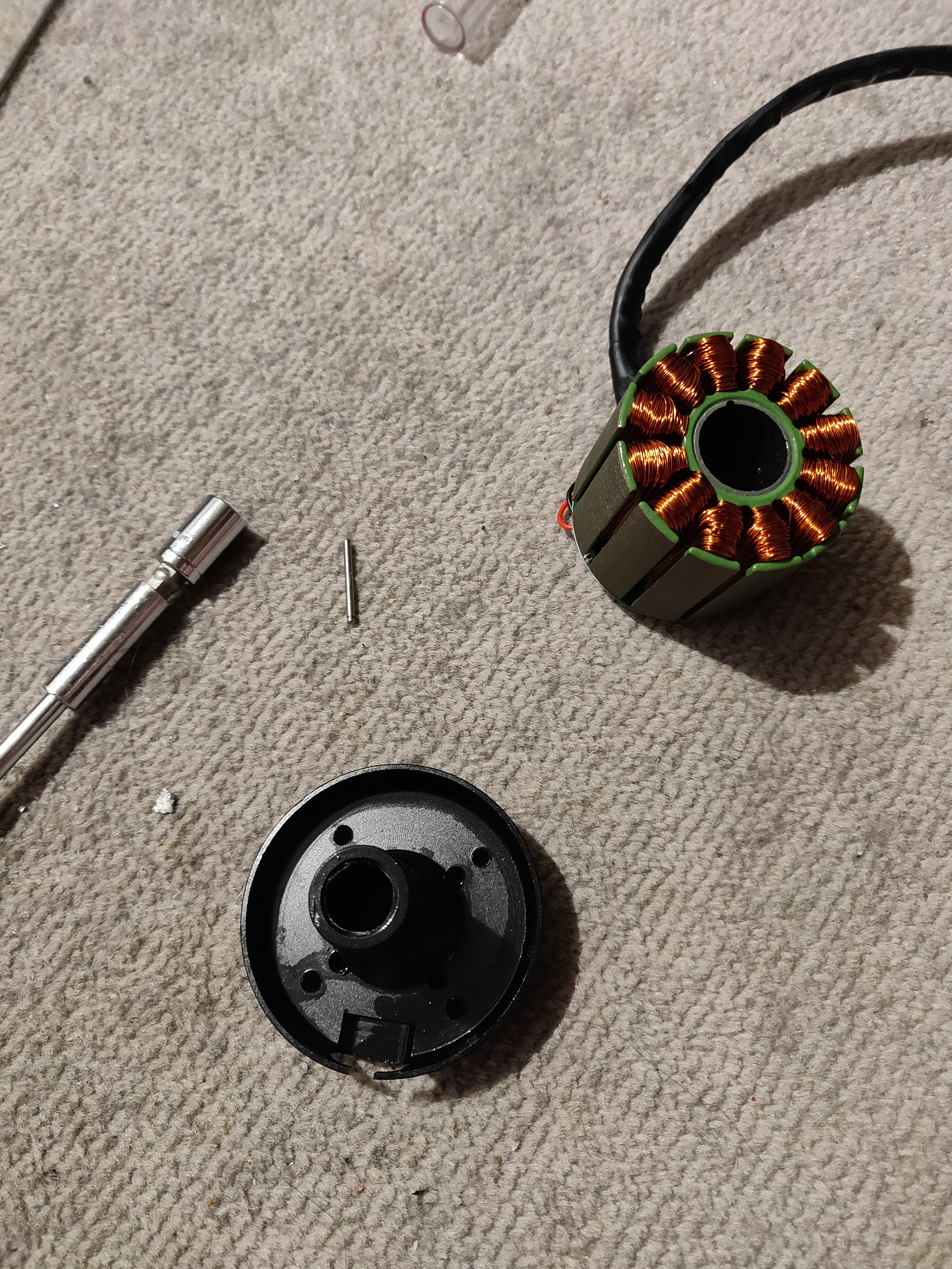

Anyone know how to get the black mounting part off my dickyho 6374? Trying to swap my phase wires out but can’t get to then without that plack part being taken off

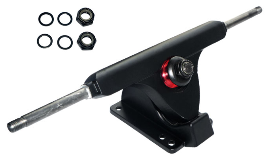

Has anybody tried using these for a super narrow belt drive build? Believe they are around 150mm wide where the inside bearing or spacer would sit.

Anyone help here? This stator ain’t coming off even with a heap of WD40
not familiar with that particular motor, but I’d hazard to guess the the endplate you’re attempting to remove is pressed onto the rear stator bearing…
but I could be wrong…

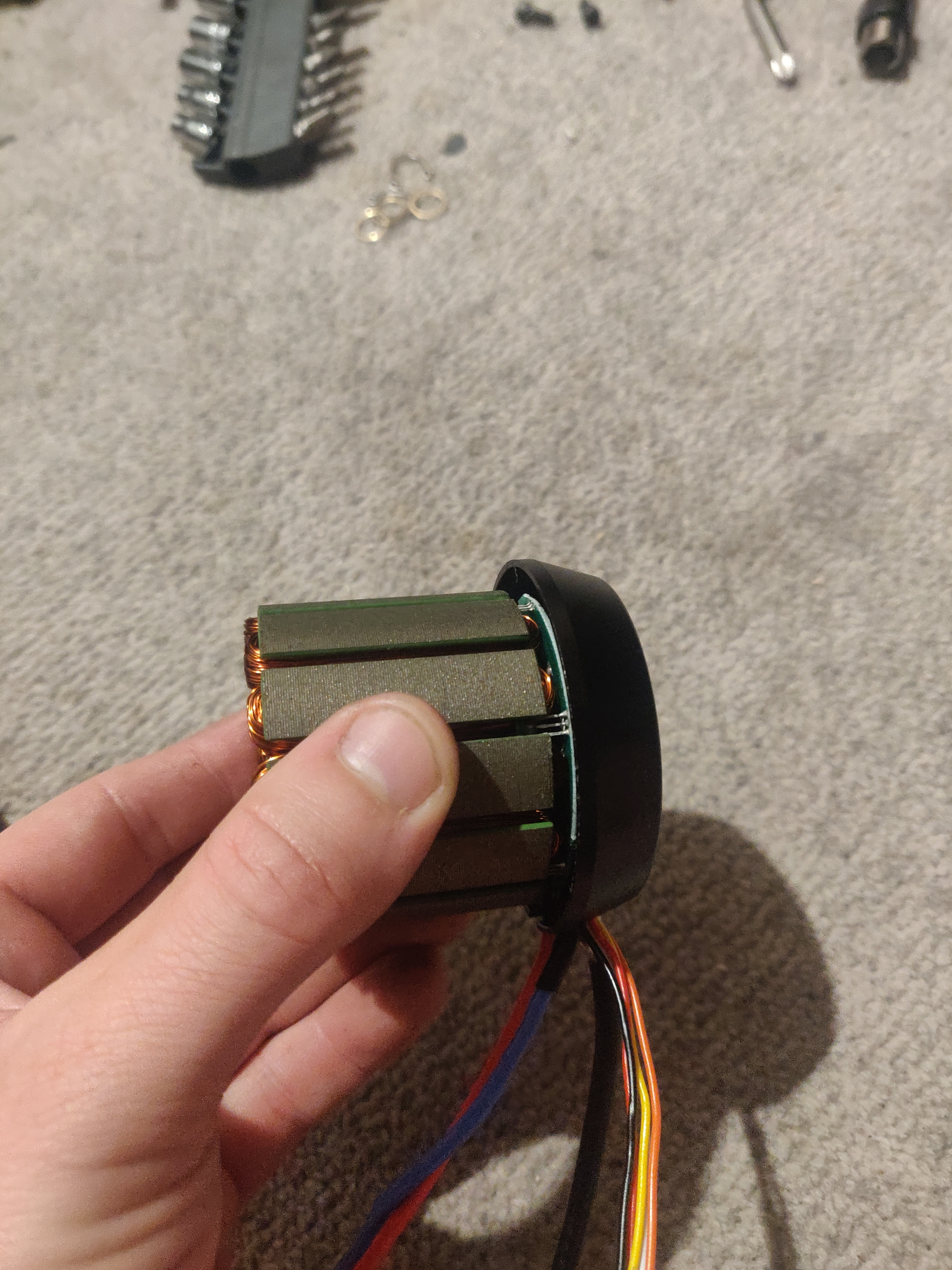

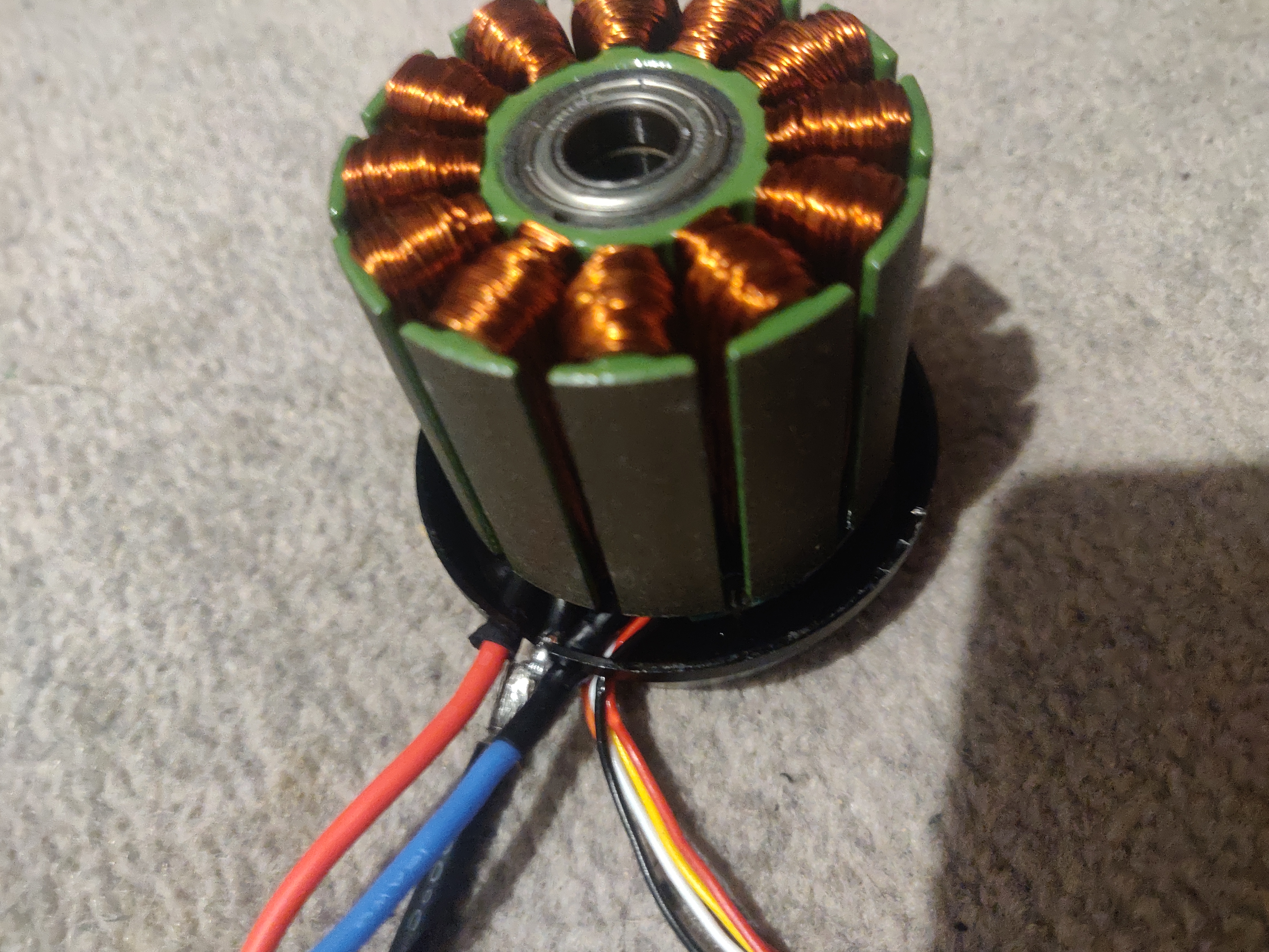

Both bearings have been removed, the mounting part is pressed hard to the inside of the stator itself. Just not sure if there’s a particular method to this
They’re usually pressed on and/or loctited. I’d suggest the liberal application of heat.
Be aware, you are going down a rabbit hole. By the end you may end up needing to fully rewind, and/or replace the bearings, and/or re-epoxy the stator. You have been warned.
Got it! Just put the end of this tool in the top and just hammered till it come off, no damage to the motor that I can see
So thanks to the infinite wisdom of China the other motor, from the same seller, has a different ID so my method won’t work here. Gonna have to get more creative and use more WD40
