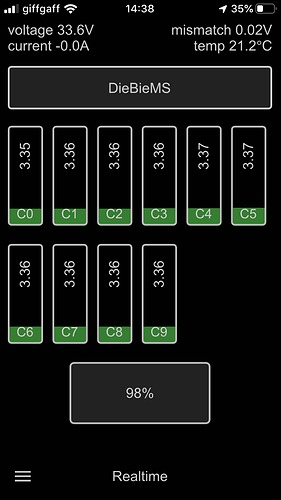

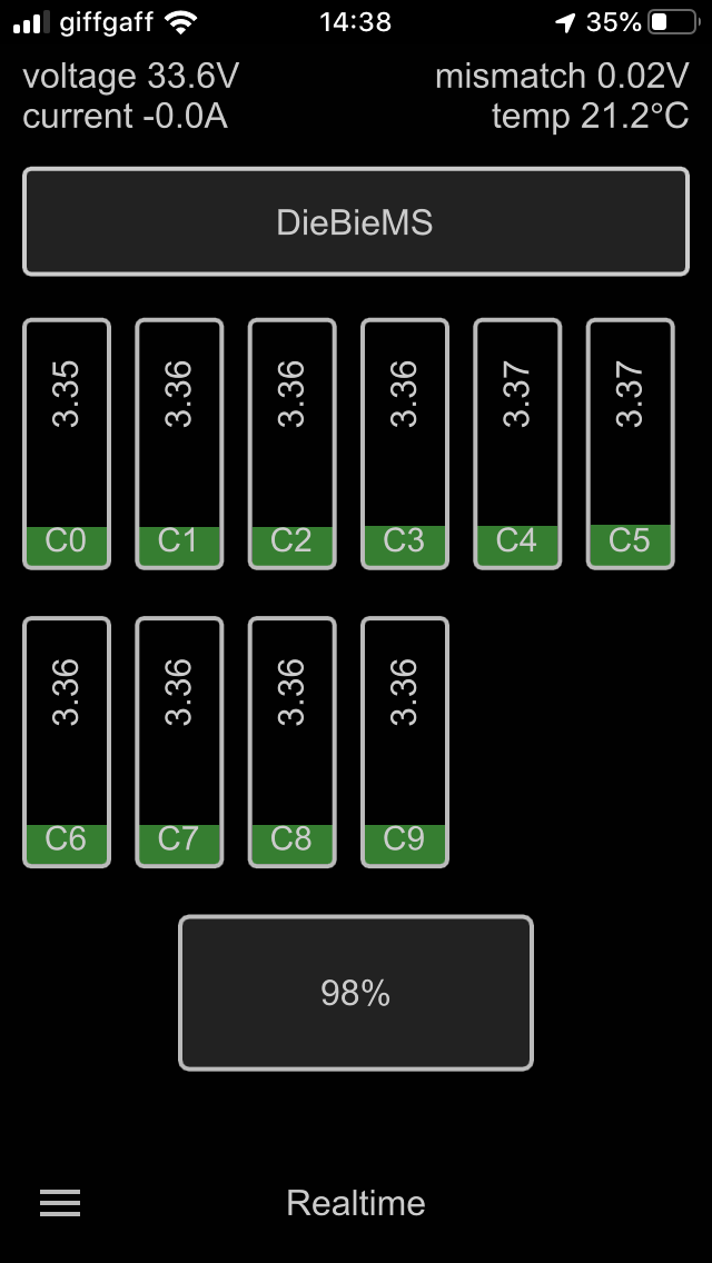

Yes a DieBieMS talks to a VESC over Can bus. VESC talks to a MetroPro over UTAR and the MetroPro talks to a phone app over Bluetooth lets you see the cell voltage from a DieBieMS
Just installed one mine looks like this need to cycle it to sort out the %

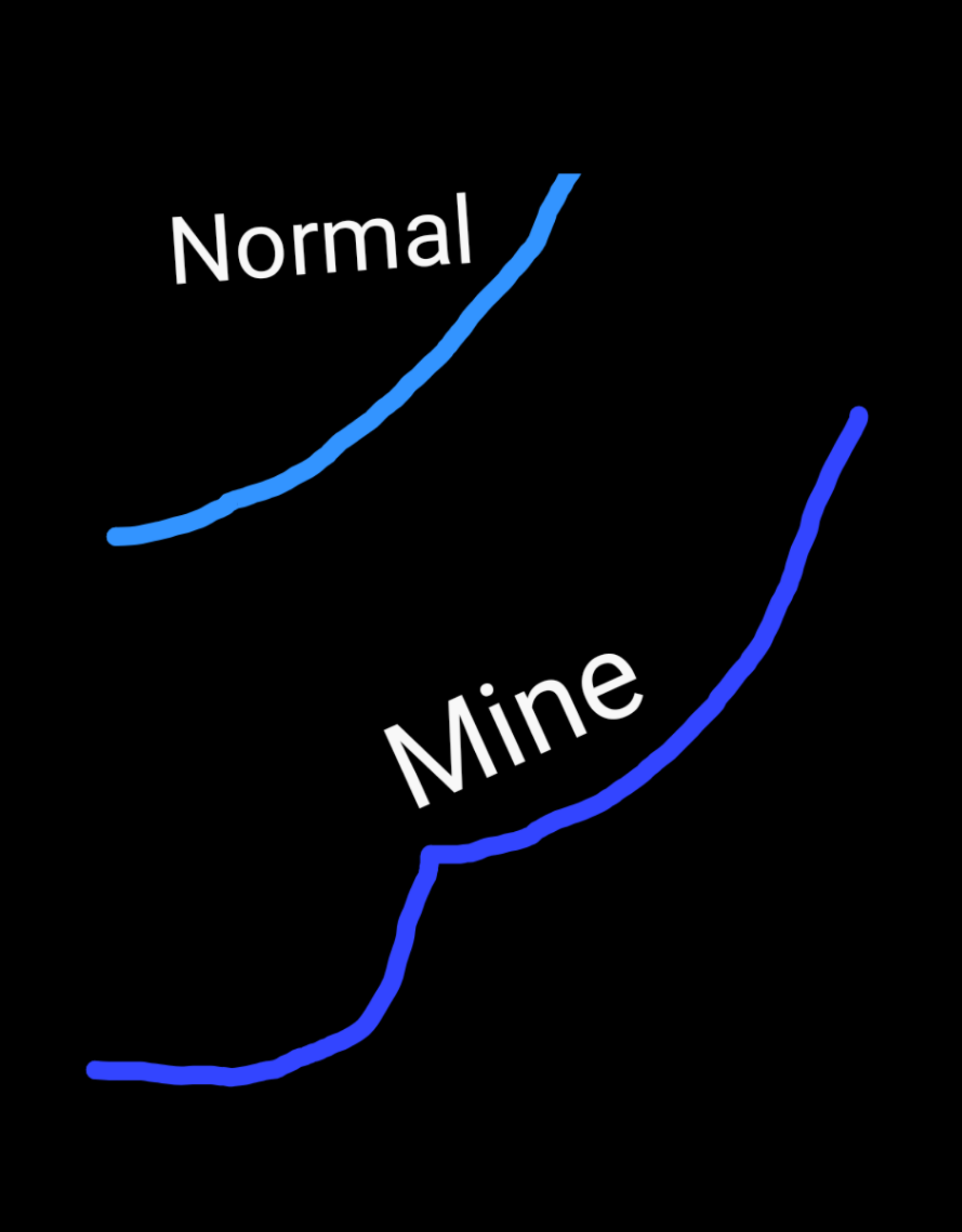

I notice a big jolt like jump when accelerating to a certain point.
So the acceleration curve is really smooth until it hits a certain duty cycle, once it hits that point the speed goes up significantly. Like shifting gears.
Sensor erpm cut off?
That…could be possible? I’m running sensored hybrid so that fits. Not quite sure what my cutoff is. I’ll have a look.
Is the jump at a certain speed or certain point on the throttle?
I think sensor can have a lower ramp up speed so it’ll dump more power after a certain speed if you have it configured like that
Might also be the erpm throttle point, if you have that set low it’ll have a relatively weak top end
Haven’t measured the speed but it’s around half the throttle. 20kmh+ minimum i’d say.
