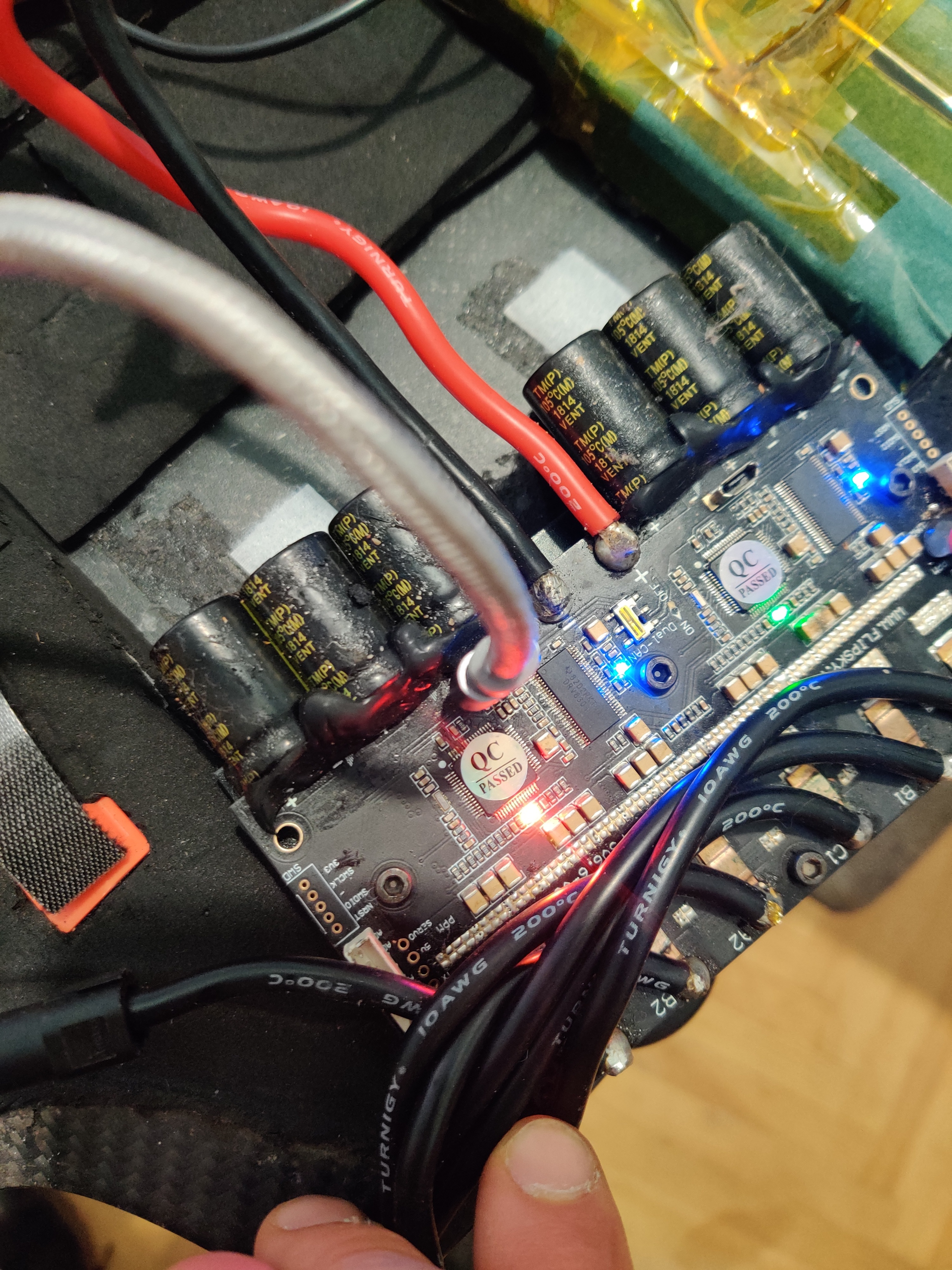

I have two boards on and charging right now, I don’t think that would cause any issues with anything except the battery – and that’s only if the charger stopped working and the battery died, ESC still should be fine
O would think so too @b264 but this is the only variable in my situation, so just pointed it out. Battery is all well at 50.4.
So is it fucked?
@BillGordon I edited the post, I still get all three…
Oh, crap. Yes, seems to be fucked. I was all hopeful from that other photo!

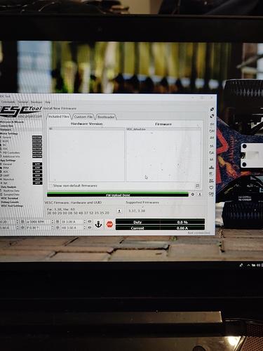

Yes canbus worked so far (before updating it)

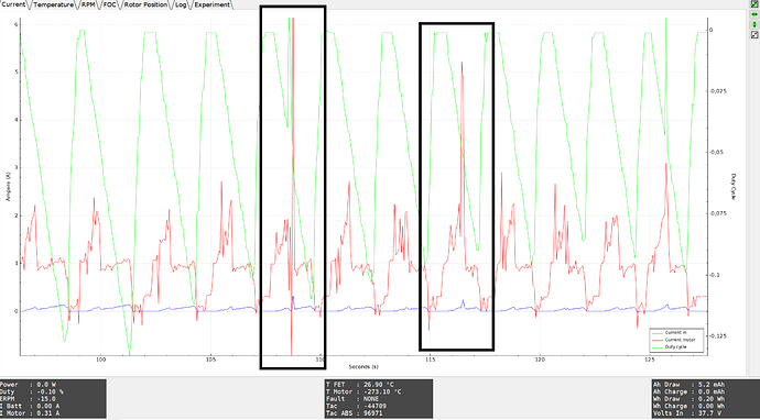

After the update i could go to the connection tab, choose the connected COM and scan for the can vesc. I even could press the can forward button that would switch to green. Everything after that point resulted in the vesc tool saying “firmware too old, check if the vesc i plugged in” etc.
Also if i both were connected via can and the usb is in the slave the vesc tool still would only programm the master.
Like i said i switched to ack and it worked on the first try. I just wanted the smart reverse, thats all.

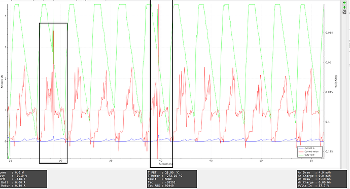

Also while we are at it. When i was on the 3.62 and activated smart reverse the Motor had some hickups, any idea?
Should I - could I try a non default FW?

You can try Ackmaniac instead. On my two favourite drivetrains, one works better with Ack and one with latest vesc tool. No idea why.

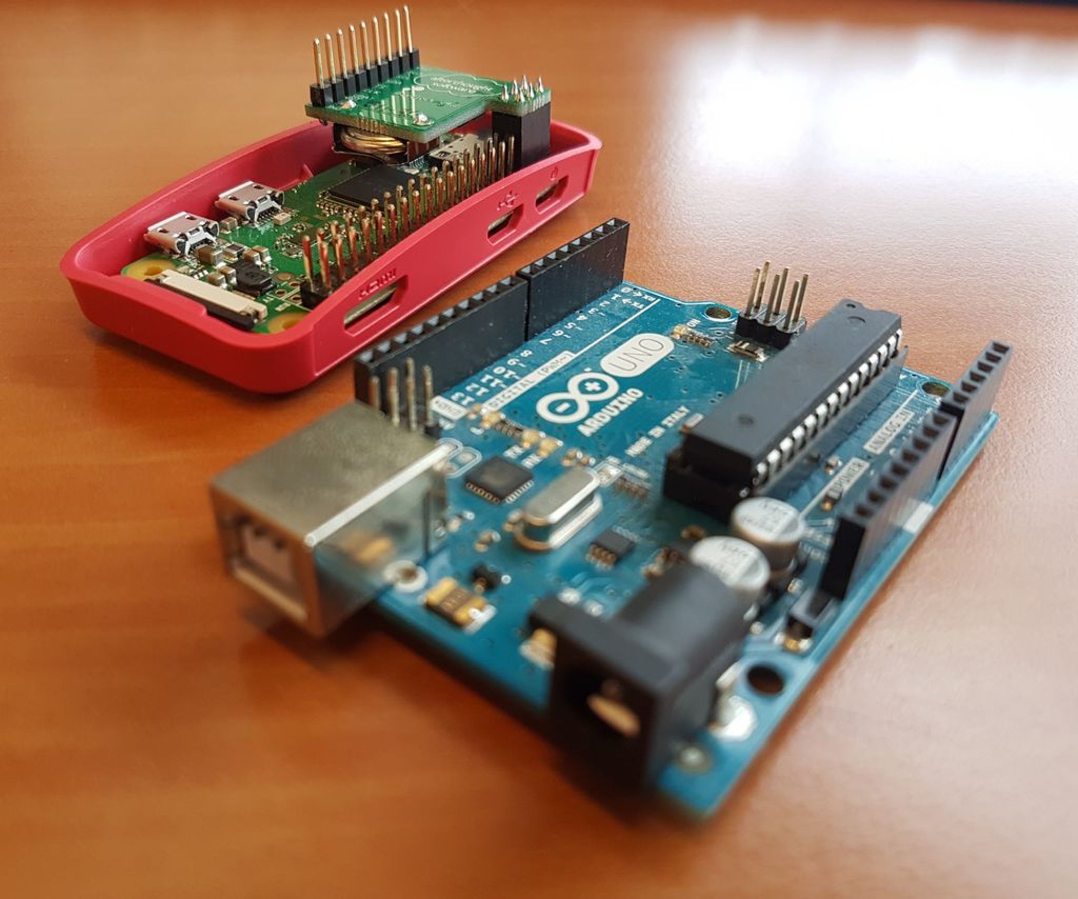

Oh also I will make a thread about this I guess not to pollute the Noobs question thread too much but if anyone is interested in setting up their own data logger with a raspberry pi these instructions look pretty good:
If I can get it working logging the VESC UART data to an SD card (and/or over wifi) then will post a rpi image and some more straight-forward instructions.
