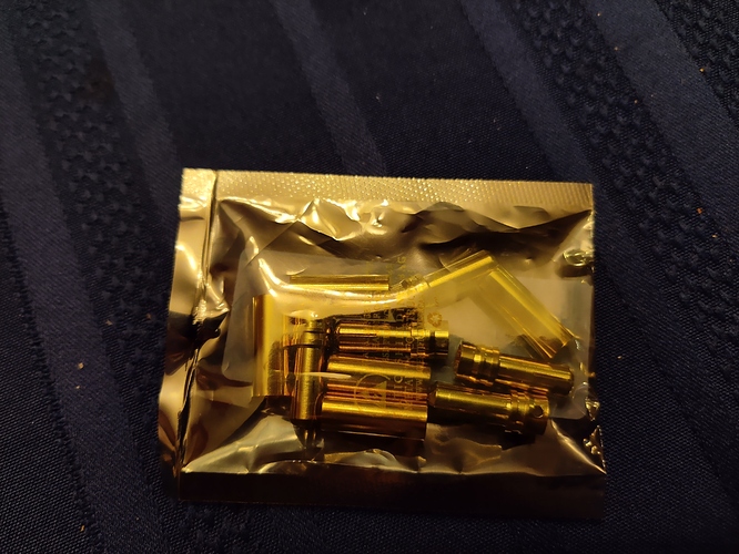

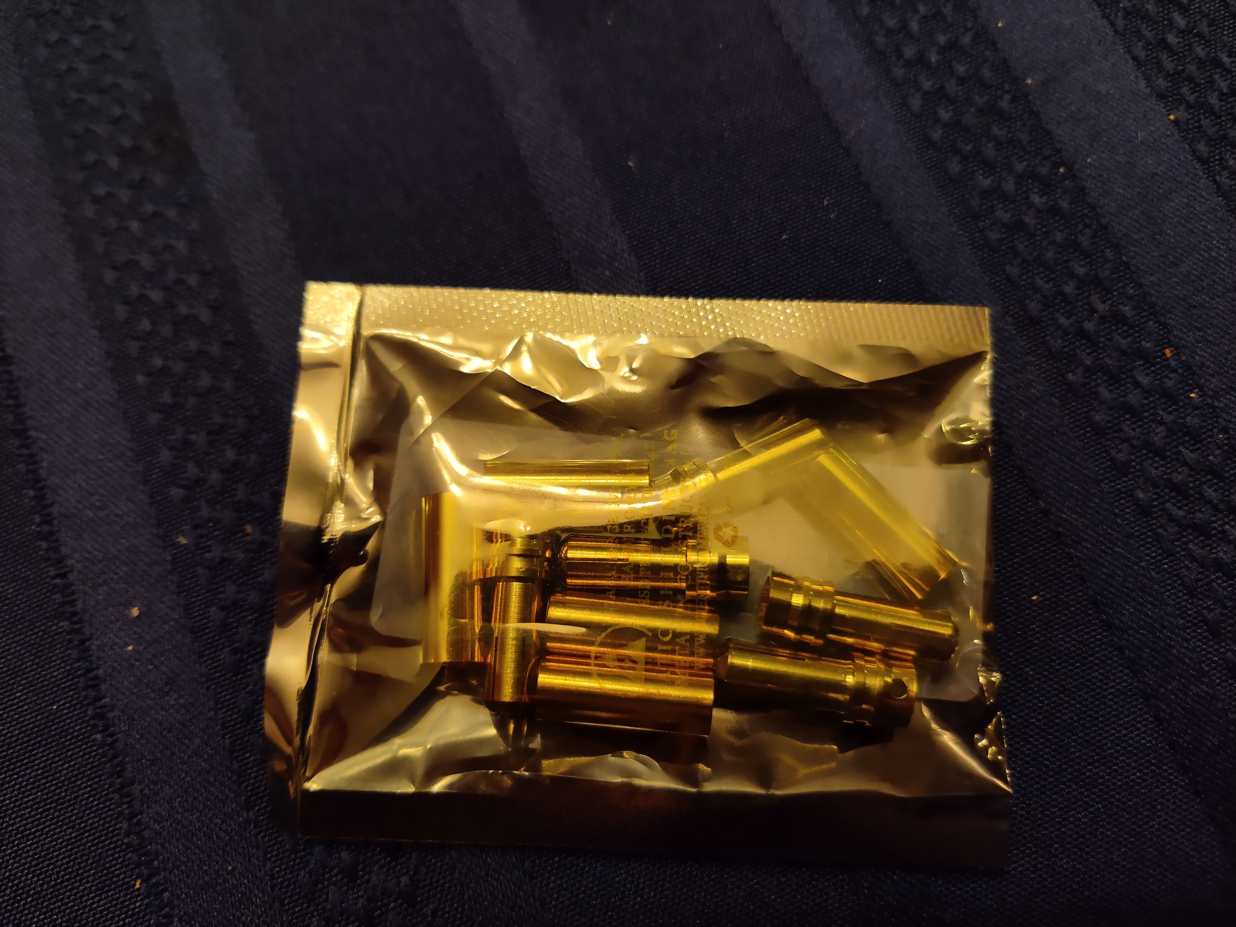

Question - Did you buy the male and female bullets from different sources or at different times? There are quite a few “5.5mm” bullet designs, and they’re all subtly different.
It’s also possible you got 5.5mm male bullets and 5mm female bullets.

Nope they are pairs, bought all together. The pairs came in the same bag. Im pretty disappointed with this purchase haha
Send them back. Sometimes you get a dud.
Three bags of duds? I guess I cant see a reason why not haha. Thats what I get for buying from Amazon I guess.

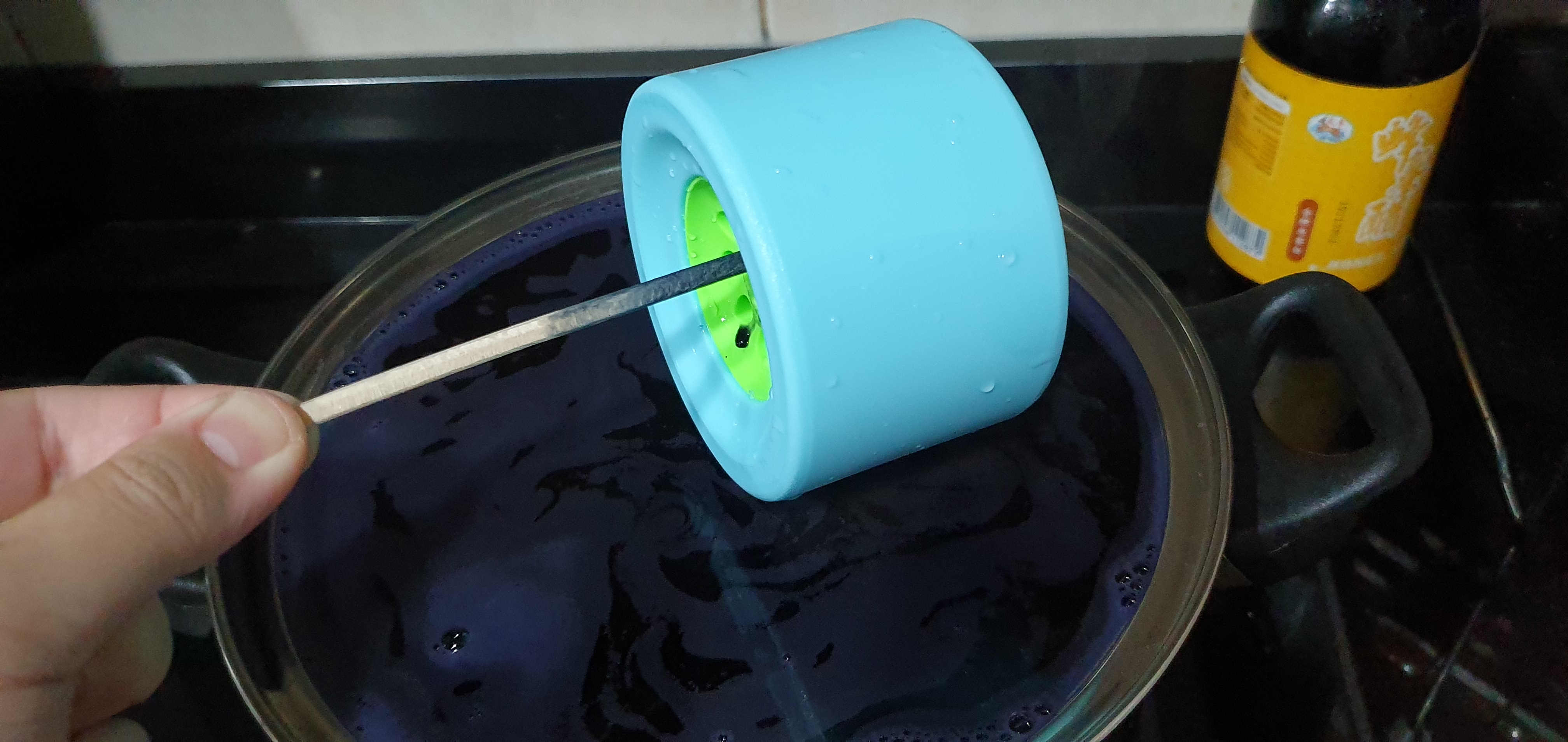

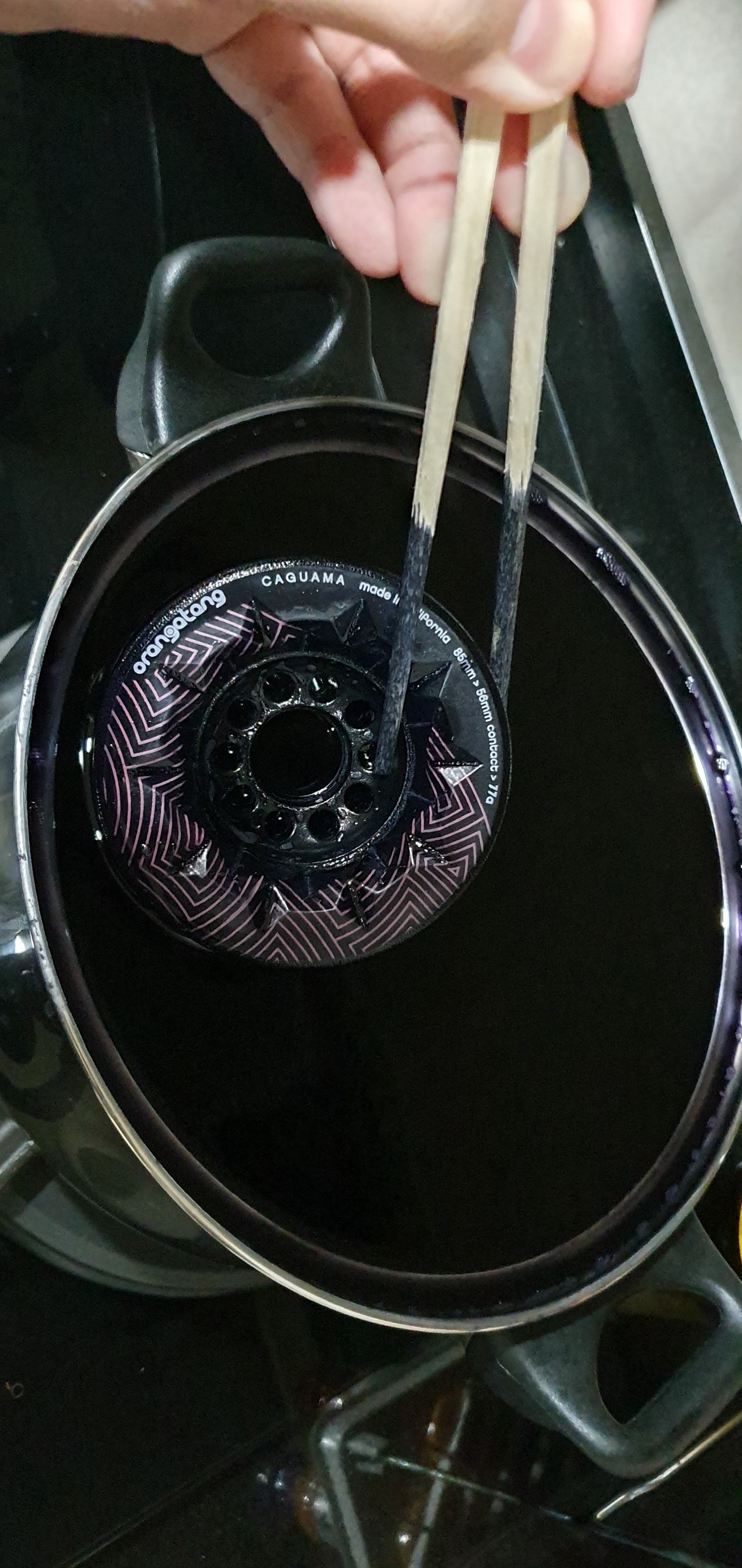

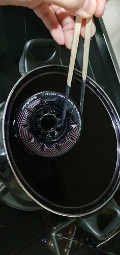

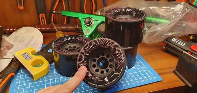

Oops sorry just saw this.
I use Rit Dye, the one for synthetic materials.
Boil a pot of water enough to submerge fully whatever you’re dyeing.
Then add the whole bottle of dye, a squeeze of dish soap, and a cup of vinegar. I used white vinegar.
Off the stove, dump your wheels etc in, and let it sit in there. The longer the better, I left mine for an hour. Turn the stove on with low heat to heat it up if it starts to cool down, but make sure to stir occasionally.
For wheels, stir the wheels every 10 mins or so because the part that contacts the bottom of the pot may not absorb
That looks fantastic! Does the dye absorb all the way through the urithane?

From the looks of it, not really, I’d say about 4mm deep?
