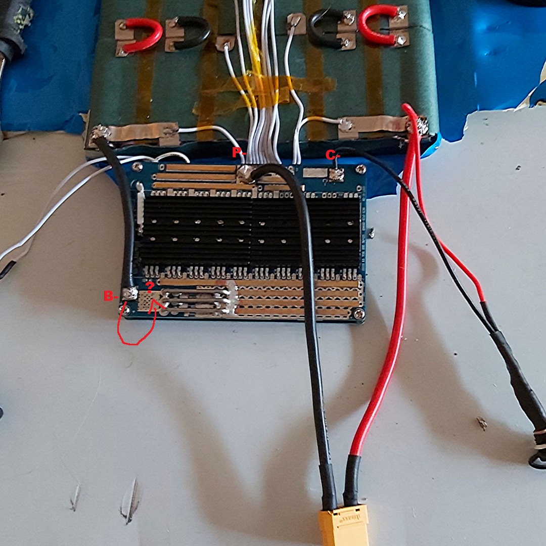

Can it be i wired the B- wrong and shouldn’t it be like in the last picture?
The revised photo/proper diagram tells the story.
I tried that pad but still no change

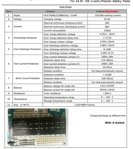

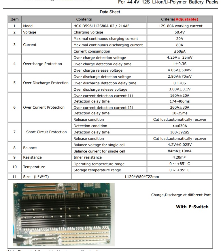

Look this is a pack for a personal board of mine, all I need for now is for it to charge…
do you have another battery to try the bms on.
I would still try another battery just for the sake of trying since this already makes no sense.
have you tried to see if the voltmeter reads anything off P- on the bms and positive wire (red) of xt60/90?
and then with B- and positive wire (red) of xt60/90?
yes 48V
I don’t know then : (

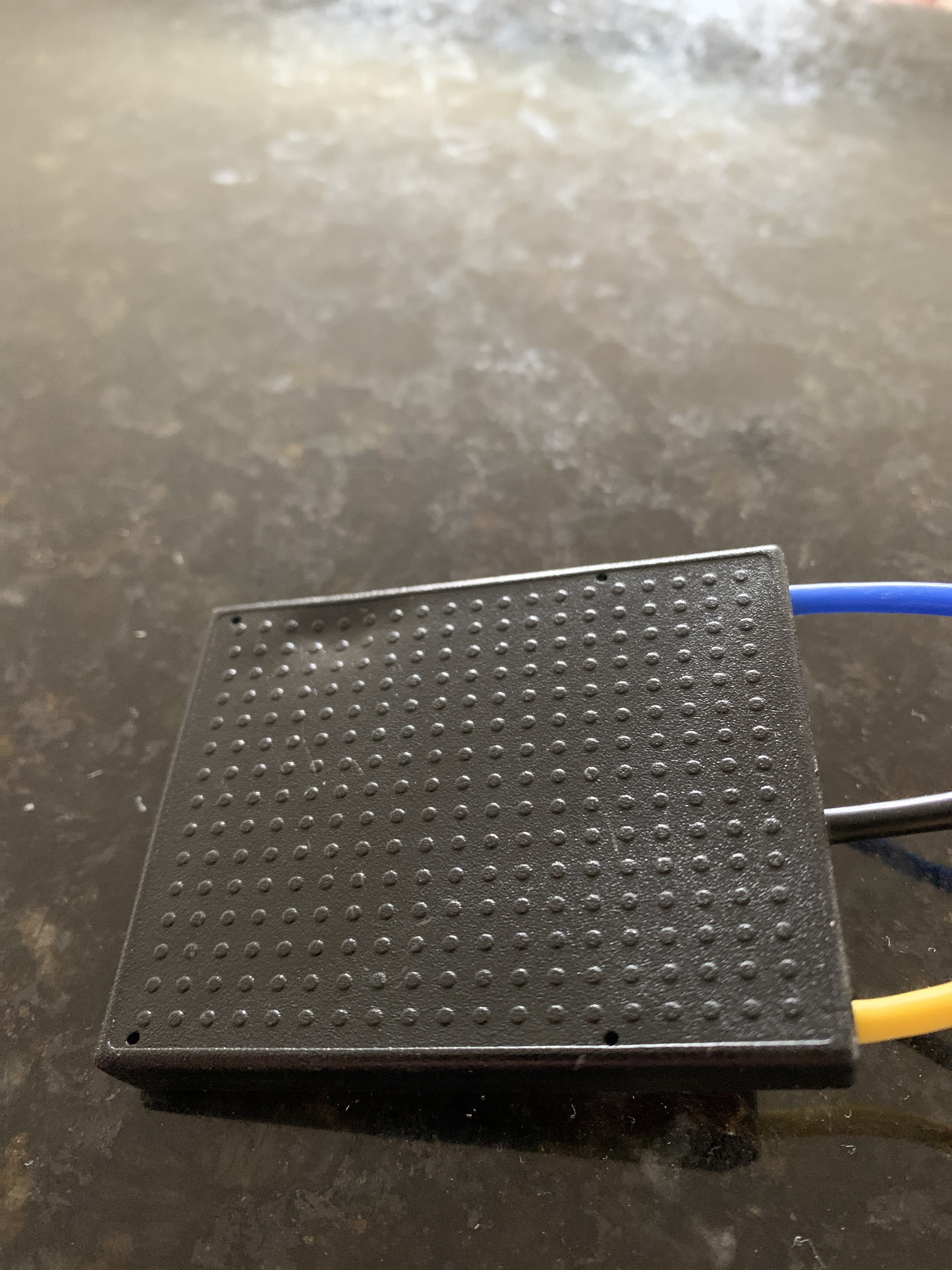

This is the dented guy
Edit: I have no way to open this and look at the PCB, the shell is welded closed
Doesn’t look too bad to me. You could crack the case open and check out the insides but it may be siliconed tight. I’d hook it up to a battery on the bench to make sure it boots and no magic smoke pops out.
Just hook power across and see if it trips?
That’s the plan.
Or put it in your board and have a ride and see if it trips.
Both options are viable.
