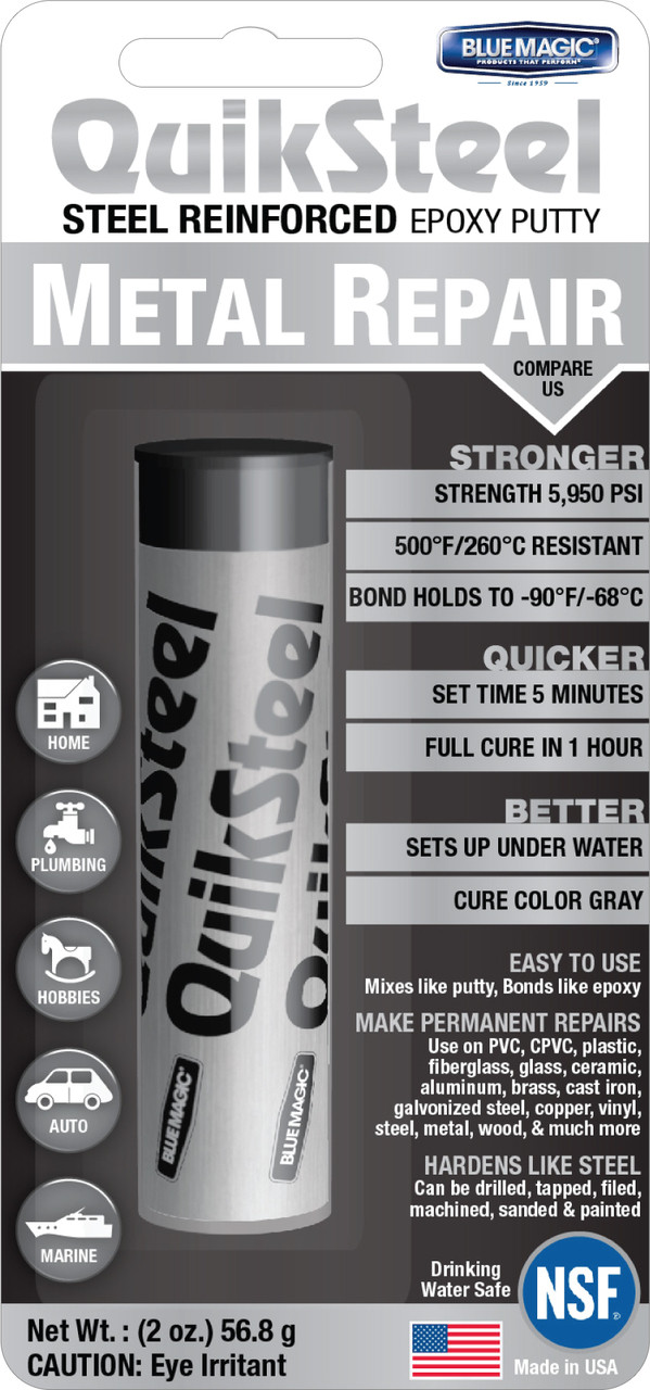

@b264 I know you have a fondness for JB-Weld, but I thought I’d share something we find indispensable for field repairing almost anything…
It’s moldable, sets fast, like ball-bearing hard quickly…
KEY BENEFITS
  • Withstands Up To 500°F/260°C Temperature
  • Can Be Drilled, Tapped, Filed, Machined, Sanded, & Painted
  • Bonds To All Metals, Fiberglass, Plastics, Glass Wood,
  • Ceramics, Brick — Almost Anything Except Rubber
  • Sets In 5 Minutes
  • Steel Hard In 15 Minutes
  • Full Cure In 1 Hour
Anything you can do to metal or wood – you can do to QUIKSTEEL . SEALS LEAKS UNDER WATER OR IN FLUIDS: QUIKSTEEL cures underwater and in all atmospheric conditions. … IMPERVIOUS TO CHEMICALS: QUIKSTEEL is impervious to most chemicals including battery acids.
we’ve sealed crankcases and radiators in the field with this stuff, and if the hole is too large we as add an appropriately sized Mexican peso or a rock… sticks to almost anything, and hard as fuck… It’s difficult to fuck up, comes in a tube… slice off a chunk of the two part epoxy and squish and mix it together, and either form it or slam it on… BINGO finished (contains metal particles)
I just thought I’d share.

I’m not married to any brand, if something else is better I will switch in a heartbeat :wink:
Mainly when I say “JB Weld” I actually mean “name-brand slow-setting hard machinable automotive epoxy containing metal, not household clear epoxy or skinning epoxy” but it’s shorter to type “JB Weld 8265-S” or just “JB Weld”
