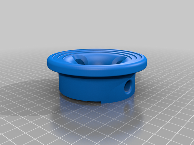

here is the someone who sells the conversion kit :
and this is a 3d printed one :
cool i have all of that availible to use/where are you getting your information ive done like 10 searches and havent found anything

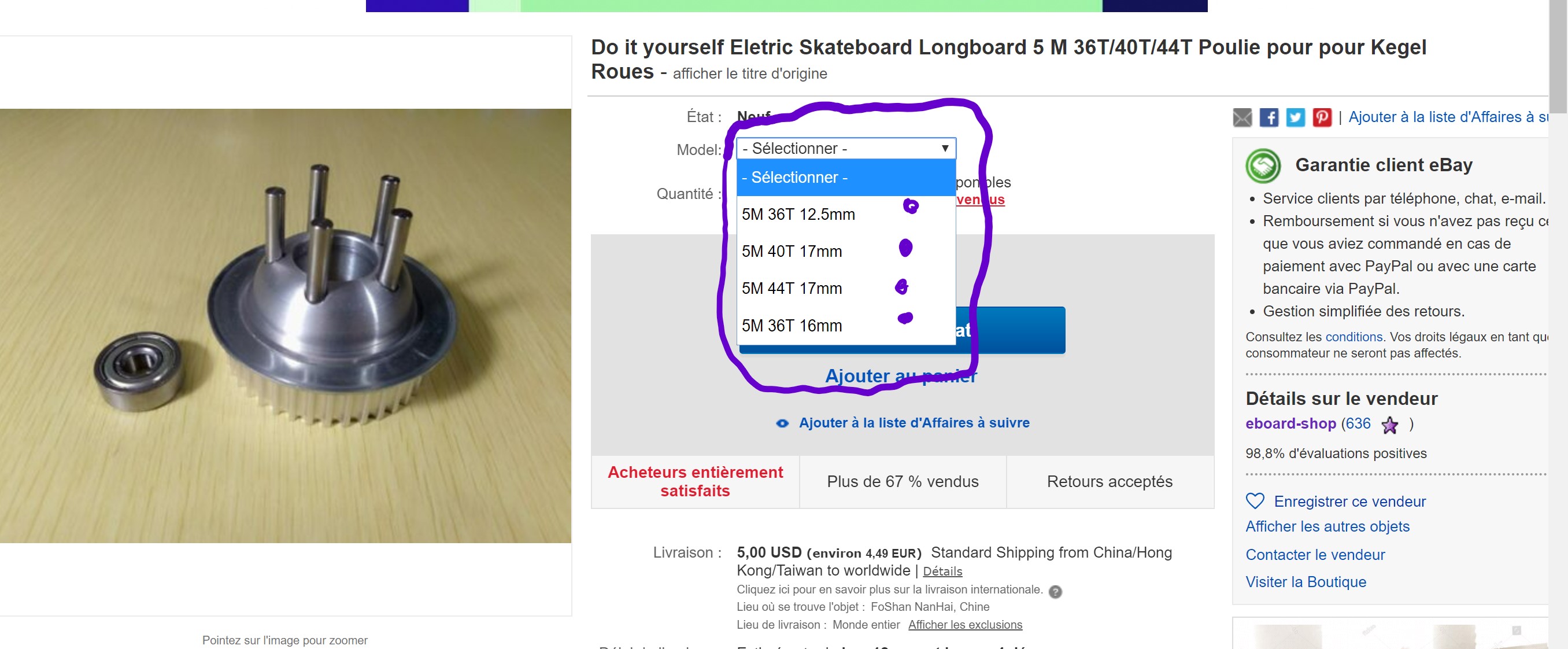

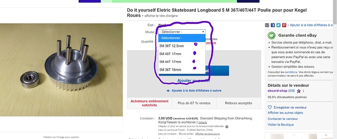

@dickyho or others,
What do these other options mean? (12.5mm, 17mm, 16mm)
That should be the pulley belt width
