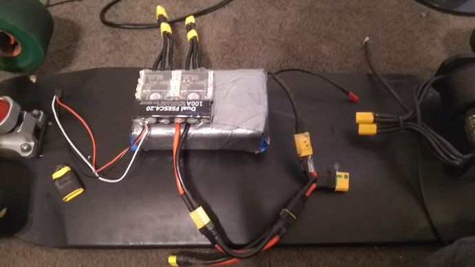

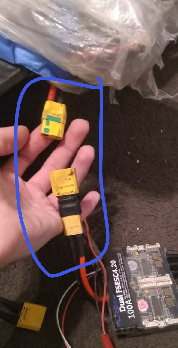

Hooked it up to my other battery and lights came on (along with a slight occasional popping noise but I’m sure that’s nothing).
Looks like my crappy pack, or my wire leads might be the problem.
Using a split xt connector could cause issues? I didn’t think it would since it’s a closed circuit
Vs worked fine with other connector on other pack.
Just check solder joints for all the wiring. Start from the main feed and work backwards. Usually when I have issues like this, and I can’t find it fast, I just tear down the pack and start over. Keep in mind I mean down to the pee groups not to individual cells.
The evolve reps that I have talked to have not been able to tell me this. Is there an easy way to find it, or does anyone else know?

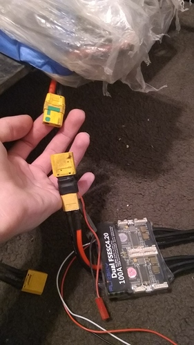

Is the connector in the right orientation in this pic?
If yes it appears the polarity is reversed.
