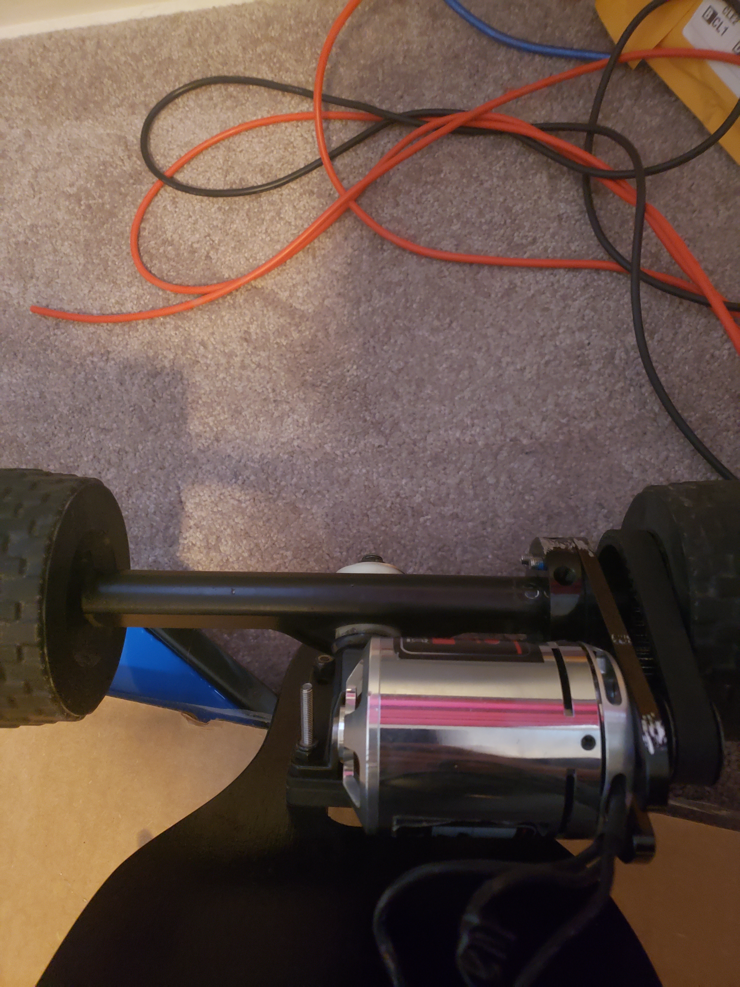

I have a question. How do you run dual turnigy 6374 on TB 218mm? For me, the motor takes up half the hanger
