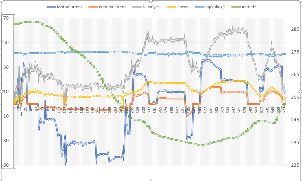

Any idea why I stop going up a 10% hill? I start up the hill, slow down, and within 15 feet stop completely. I had thought it was voltage sag, but I am not seeing it in the data. I have a single drive 6374 with 36:16 gearing, 90mm ABEC, and a 10s3p 30q pack. Rider and board are about 180lbs.
@Tbone which part of the graph is the hill, whatās your kv, whats your motor and battery current limit settings?
The hill is at the very end of the graph where the speed goes to zero. Elevation is on the right axis, everything else is on the left. Motor kV is 190 (TB motor).
Battery_Max=45.0
Battery_Min=-12.0
Cutoff_Start=34.0
Cutoff_End=32.0
Temp_Start=85.0
Temp_End=100.0
@Tbone what is the motor current limit setting
Sorry, missed that on my copy/paste. Motor current is set to 60 / -60
@Tbone thatās odd because it appears on the hill the motor current was only 30-35a, I assume you were using full throttle?
Full throttle for sure
maybe the esc was getting hot from that long downhill section where you were getting 50a+ regen motor current and so it did some thermal throttling of your motor current as a form of self preservation? iām trying to understand why at full throttle at low speeds youād only get 35a motor current if your motor current limit is set to 60a

What remote are you using, and did you set it up so that a full trigger pull is 100% in the ESC Tool?
If Iām reading it correctly, it looks like your battery current is only hitting 12A or so
iād only expect him to reach his battery current limit while accelerating full throttle close to top speed
(at lower speeds it takes less battery current to produce constant motor current)
so accelerating full throttle while at low speeds he should get the full 60a motor current using much less than 45a battery current

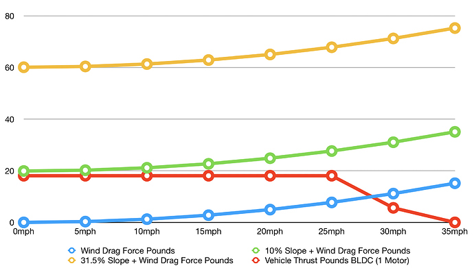

^as I suspected, with only 32a motor current, 90mm tire, single drive, 190kv, 36v battery and 36:16 gearing & 200lbs, the vehicle thrust is insufficient for acceleration on a 10% slope
(red line - vehicle thrust is below green line - 10% slope + wind drag force across the whole chart)
@Tbone if you can figure out how to make your esc provide 60a motor current you should be able to make it up that hill, because you will have nearly twice as much available vehicle thrust

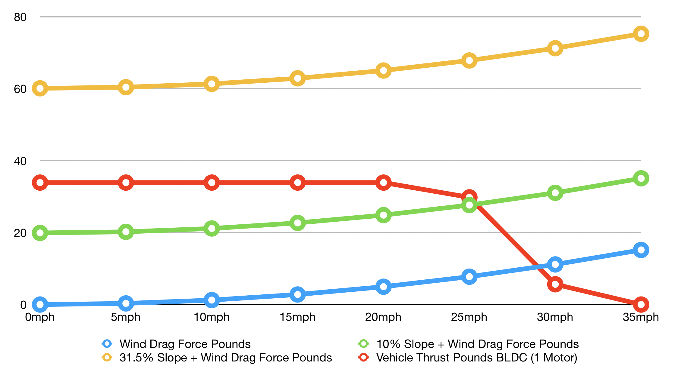

^ @Tbone if you were actually hitting those current limits at full throttle (60a motor and 45a battery), the graph would look like this, which shows you would have sufficient thrust to climb a 10% hill at up to 25mph
