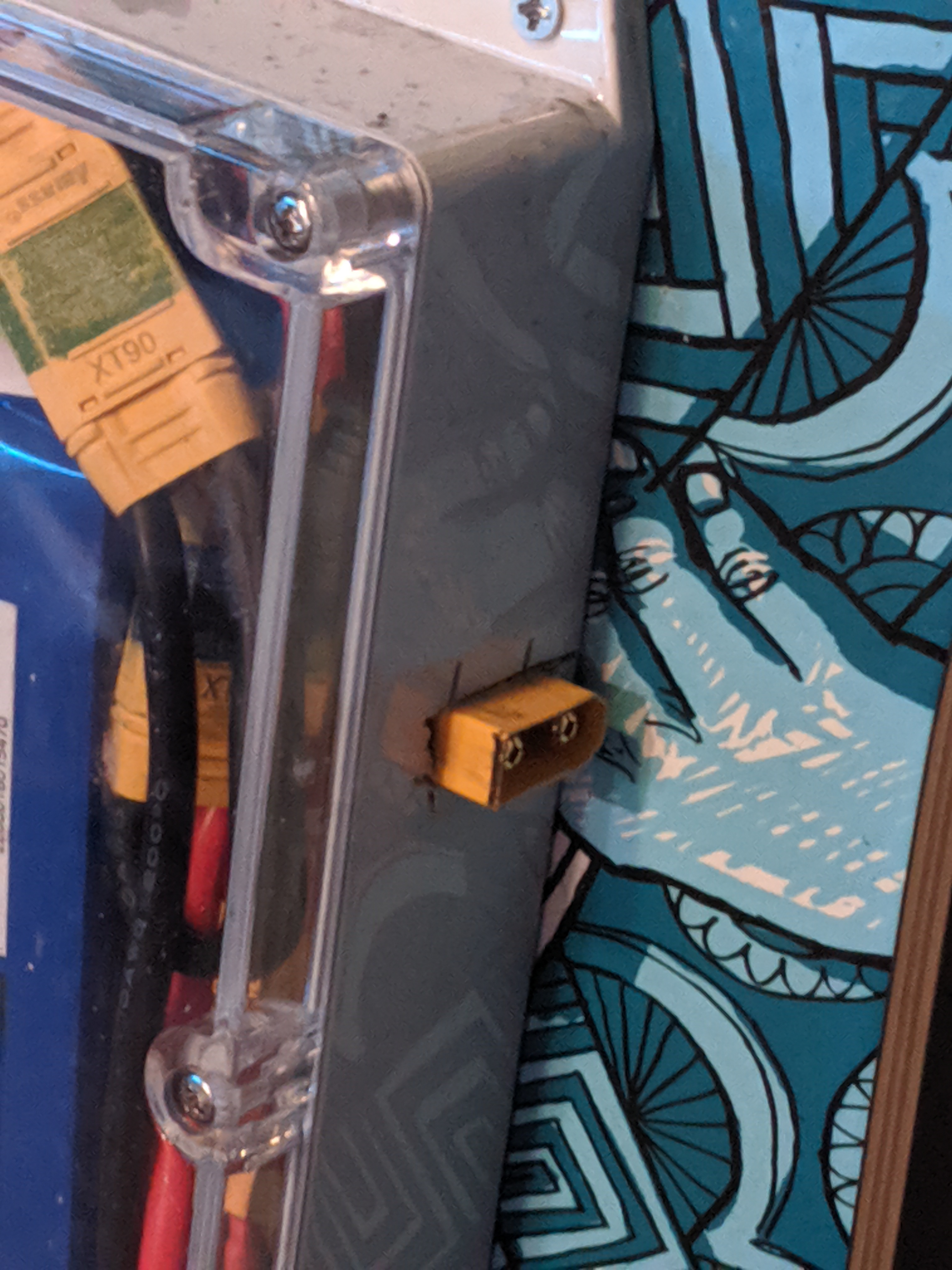

Whats a good method to secure my loop key port? Id prefer a non permanent method as if the xt90 goes south Id rather not have to replace the entire box.
@gustavthemighty Hot glue
The big, chunky main battery and enclosure are what’s left over from my first build, a diyeboard 10s5p duel belt-drive kit. The ESC enclosure (for my Flipsky 6.6 duel plus) is from Backfire. It’s $15 bucks on their site and ships from California so I got it in 2 days!
I probably should have said hot glue failed me.
@gustavthemighty Then neutral cure silicone. You should be able to pull it off if needed. I used a box made of tape around pieces before filling with silicone to give it a nice shape on my Frankenstein board
