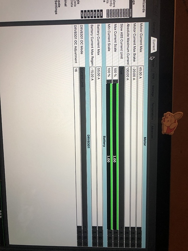

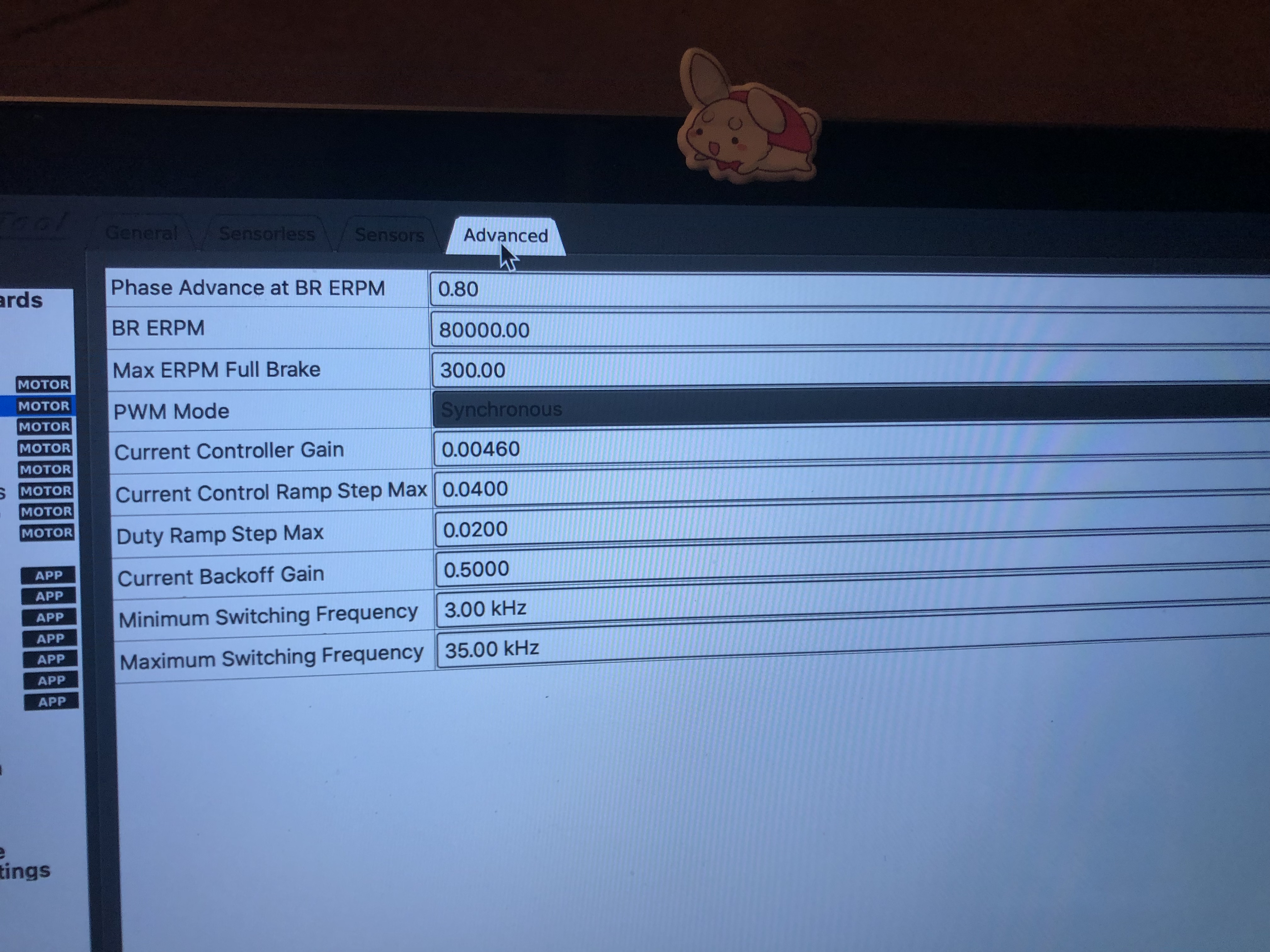

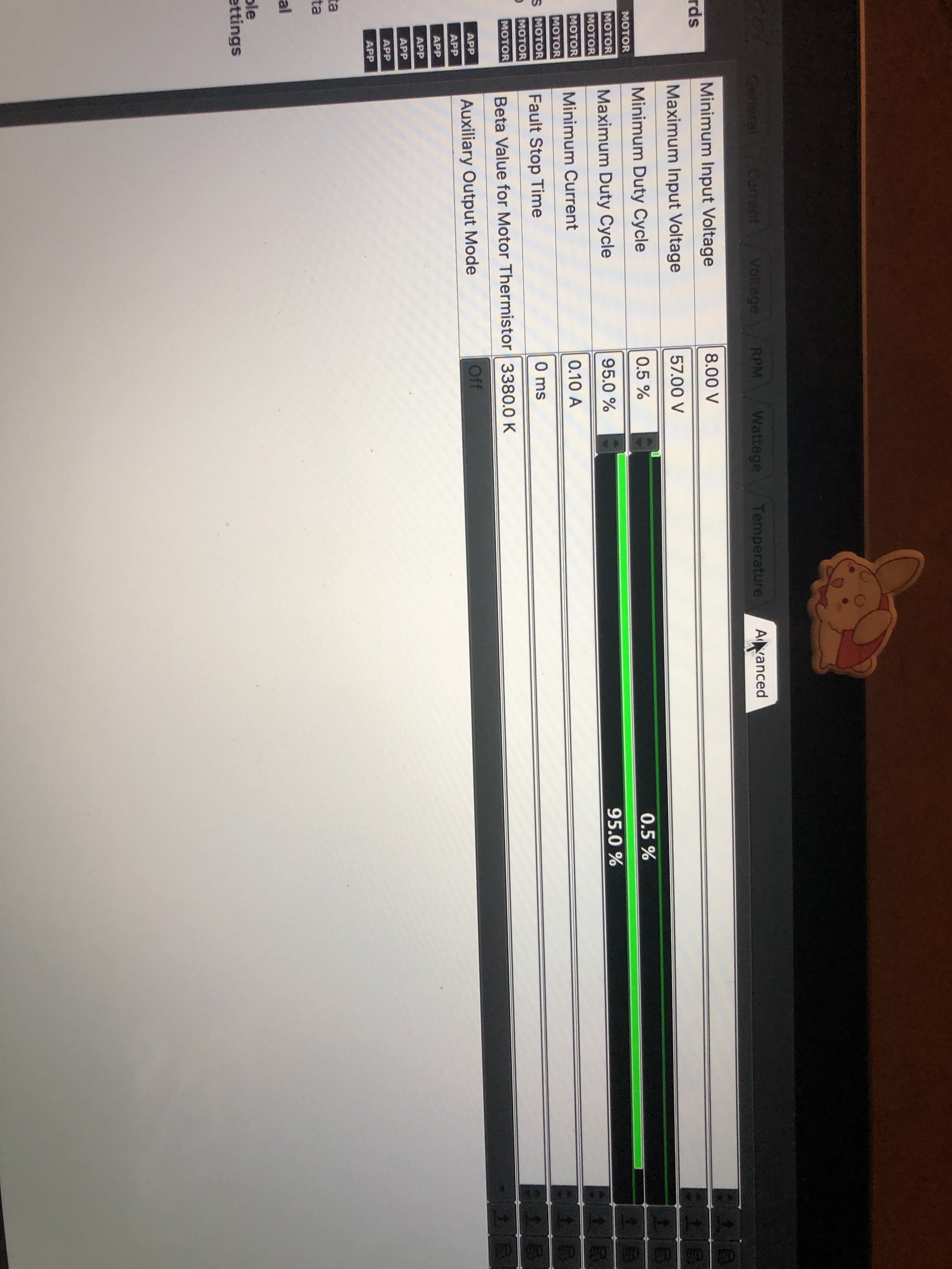

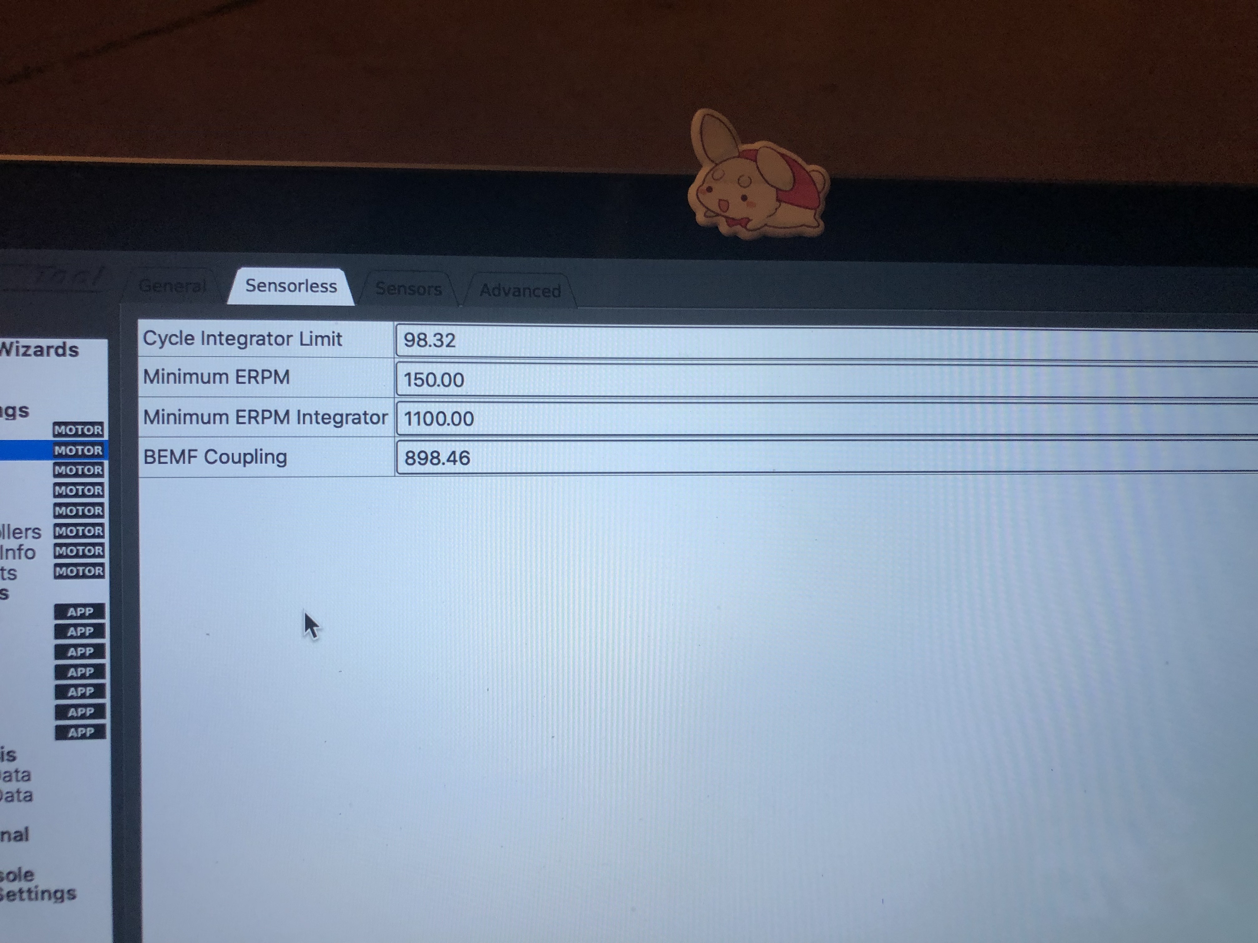

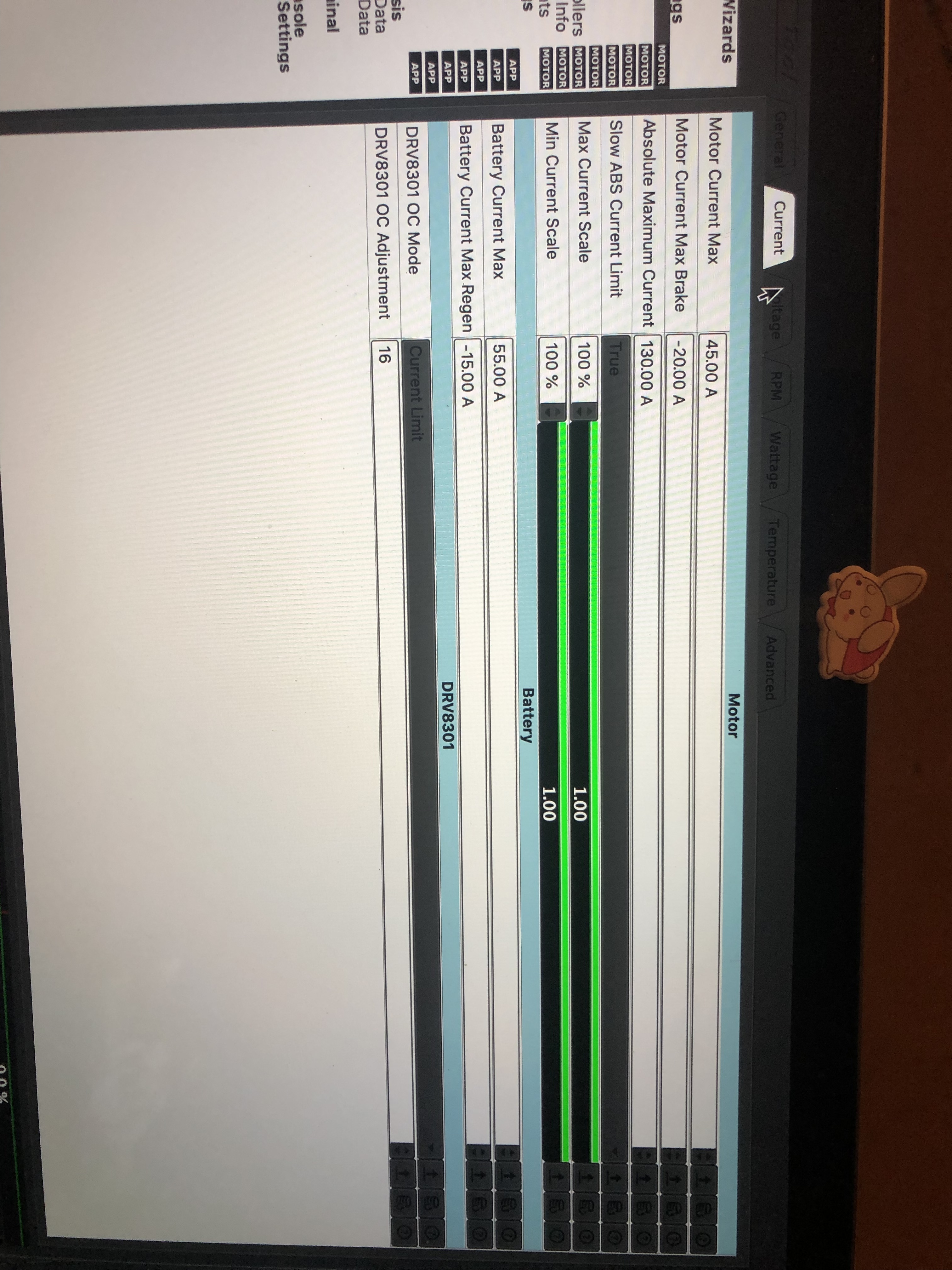

@b264 @MysticalDork I already had a problem breaking, I figured it was bms, so I disconnected it. I can break for like 2 seconds, then it cuts, I run in sensors. Here are my settings.

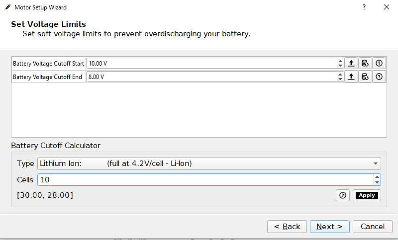

I have a 10s5p battery… do I have 50 cells? or do I have 10 that the VESC can see?

10 cells. This is the series number

You have 10s, but honestly I wouldnt let the pack go down that far with those cells.
I think cutoff start at 32 and cutoff end at 30 is perfectly acceptable. Youre not getting much benefit from those extra 2v
With those cells and their sag, those 2v at the bottom end might skew into a larger drift than what you would like. I know my 10s5p from diyeboards took aaaaages to balance when I had ran it hard for a week

Awesome, so I am right in putting the 10 in that box, but should adjust to 32 and 30 like @Sn4Pz recommended?
Yes that’s right.
