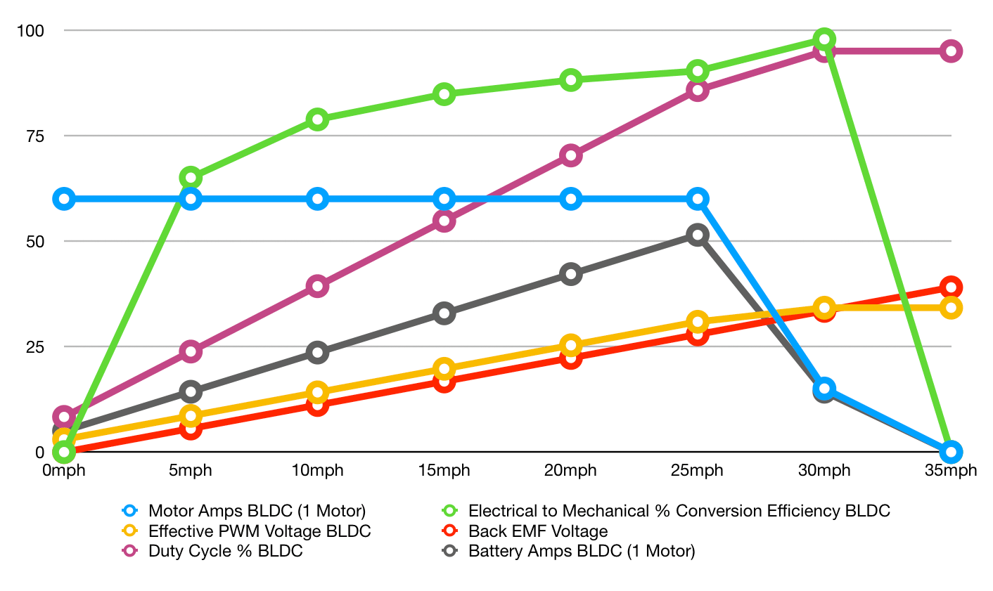

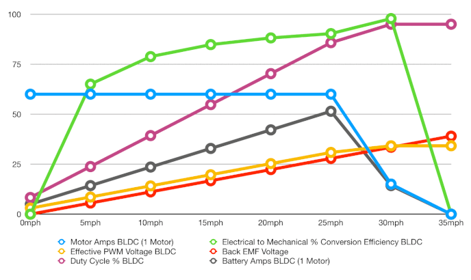

this is a comparison of the expected thrust in a particular setup between 60a motor / 25a battery vs 60a motor / 60a battery:
^the thrust drops precipitously from 25mph to 30mph because 95% duty cycle has been reached, and it drops to 0 somewhere between 30 and 35mph because the back emf voltage produced by the motor exceeds the battery voltage above this speed.
This might be the coolest graph you’ve ever posted.

^the thrust is proportional to the motor current, and with only 25a battery limit, 60a motor current cannot be sustained above a certain speed.

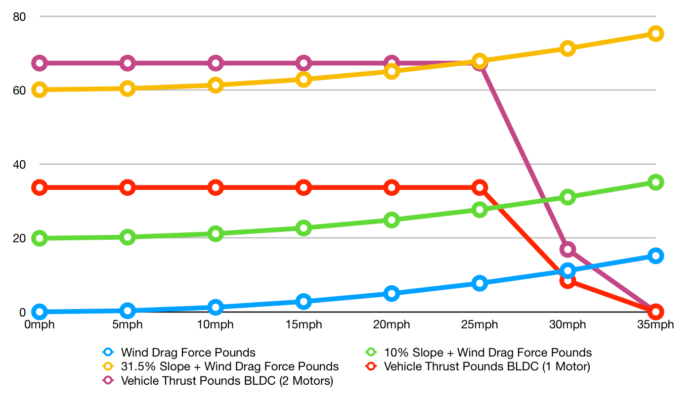

I am starting to work on a second build and am hoping to get some help on the fundamentals. I currently have a single belt drive setup with TB 6374 motor and 10s3p 30q battery. Gearing is 36:16. I ride mostly flat except there is one hill to get to my house that is 400ft long and 40ft elevation gain (10%). My boards stops about 20ft into the climb and coming down it will brake if I go really slow, but it is a bit nerve wracking. So, I am thinking of going to a dual setup and 10s4p battery. I am 165 lbs and top speed 25-30mph is all I need with a range of >12miles. Will this upgrade to get up and down 10% grade hills?
Yes. You won’t be accelerating up it, but it will do the job.
