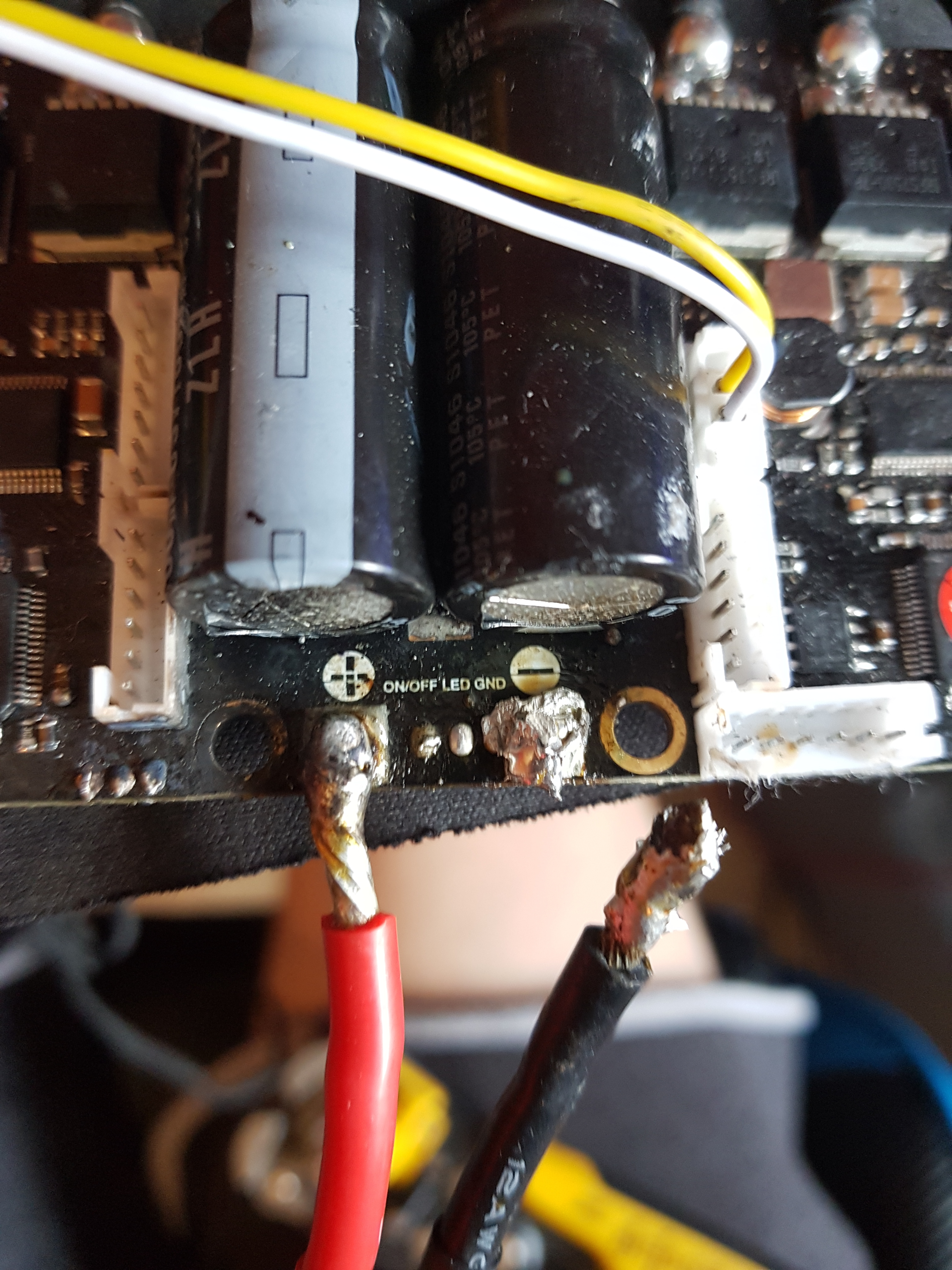

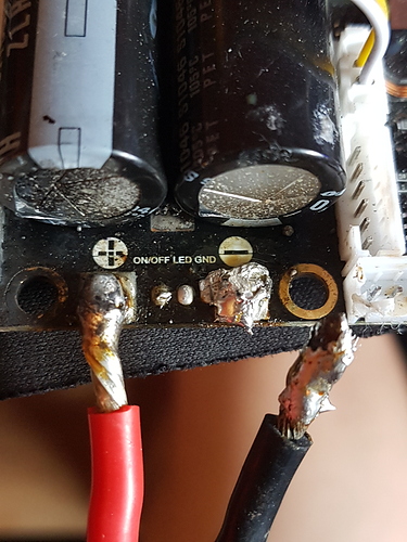

One of my solder pads going to bat- from my VESC lifted off of the PCB and shorted with the E-switch ground, luckily those fets were already fried (lmfao) but does anyone think its worth trying to fix or should i replace the whole VESC?

When you say ‘those fets’ do you mean the VESC, or the eswitch?
Photos of it? It sounds kinda gnarly
E switch FETs fried open but it’s looking like the bat- may have contacted bat+ looking closer at it. Ignore the lump of solder on the negative pad I don’t have a strong enough soldering gun to remove it.
Edit yeah I forgot the photos,
There is no photo, if you tried to add one
e: now there is
if you could get the wire off the pulled pad there are other places you can connect the GND but yah depends on how much the time/effort is worth rather than binning it, might be worth salvaging to keep running for a bit though since I keep hearing murmors of the torqueboard vesc6 being close
No I meant the bat- solder pad lifted off and touched the e switch ground, mad sparks and whatnot but idk if the VESC is fried.

ah okay I was thinking of the older VESC 4.x design but still maybe the shunts are there for the mosfets I’m 99% sure are connected to GND was thinking could just tack onto the back of one of those maybe but dunno the newer boards that well

I apologize im not super familiar with diagrams like this, meaning the shunts may have taken the brunt of the short? I pray theyre not SMD.

oh no sorry I was just looking for a place where you can re-attach the GND if the pad itself came off (it’s hard to tell from the pictures really), the shunts and GND were all connected on the older design of the boards but I haven’t had one of the ones you have there on hand to look at, which particular VESC is it? sorry if I missed this
