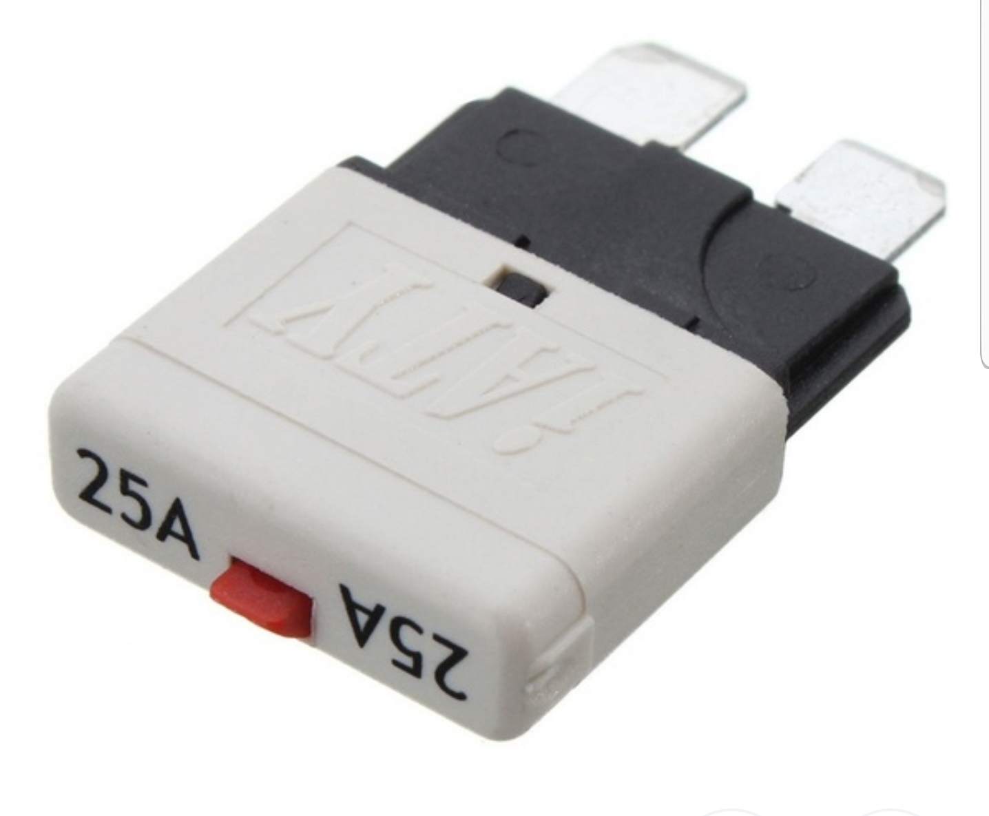

@b264 did you know these existed?
Resettable marine/automotive fuses :thinking:
MoBetta
https://www.kartek.com/parts/heavy-duty-push-to-reset-circuit-breakers-30-amp.html
Those are huge… the one I pictured can fit in fuse holders :slight_smile:
Take a other picture in a different angle please.
Huge, Not really, but yeah bigger than a fuse, and a more secure electrical connection, we use these all the time in odd-road competition vehicles…
