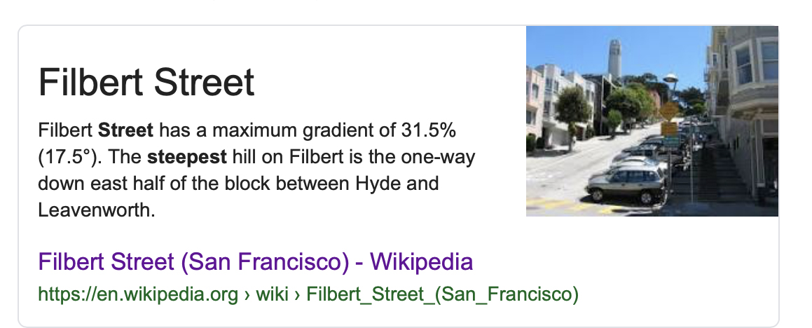

But I am only getting two 90kv motors.
so with (2) 91kv motors you’ll want 75-80mm tires if you want to be blasting up 30-35% slopes as fast as possible, and you’ll need to be able to pull 120a total battery amps from your battery, which means about at least 65a motor / 60a battery per motor settings at 12S for the stated performance (32mph up 35% slope).
Ill Shoot you a video of how it climbs up twin peaks in SF
@Alvin there is the theoretical aspect and real world. Expect if you are blasting full speed up hills that your electronics will last less (i am thinking about the ESC).
If you want something that is a true daredevil board then you need daredevil priced components. You need to find a price/needs balance
@Tello1969 I can’t wait :grin::+1:
Notice the steps on the hill :slight_smile:
These hills you wouldn’t even walk up so you wouldn’t typically even take your skateboard up it. At least for me.
if you want to climb these hills at max theoretical speed and use bigger tires than 75mm with only 2 motors then you need even lower kv than 91kv for direct drive.
@Alvin @torqueboards for reference:
