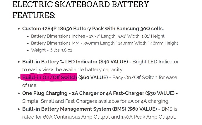

Do I need a loopkey like this one.
Because the 12s4p battery does have a on off switch.
yes. Or make your own if you love diy
12s4p has a built in on off switch so you don’t need a loop key or on off switch separately.
Okay, is it a cut out for the on off button in the enclosure that comes with the battery?
Yeah :+1:
