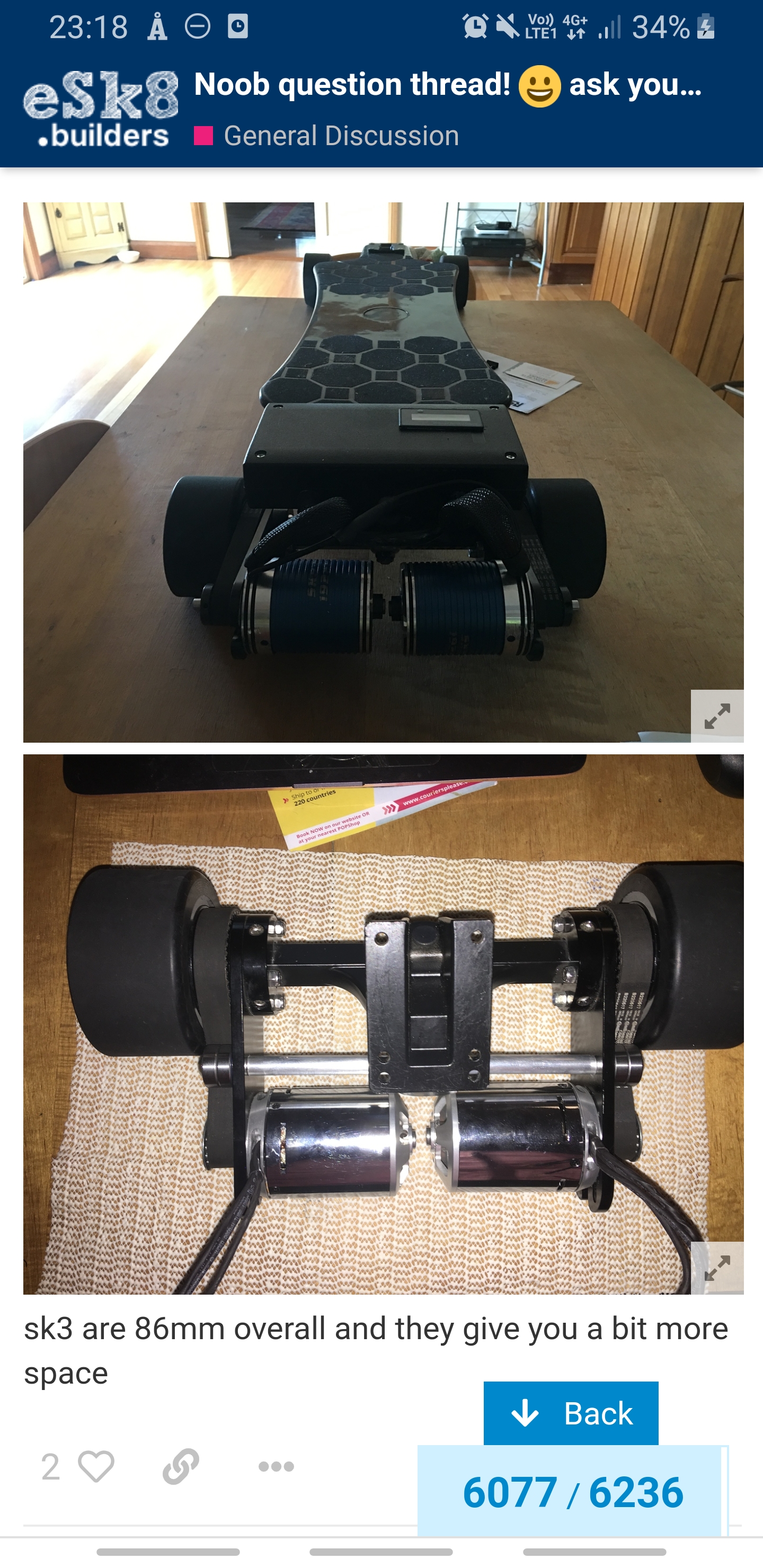

  4. If I get dual 6374 what motor should I get I know that the sk3 6374 190kv motor and TB 6374 190kv fit on the 218mm trucks. And the SK8 192kv barely fit the trucks. But the sk3 aren’t sensored, is it important to have a sensored motor?
This picture shows that the SK8 barely fit. Is that a problem, couse the SK8- and TB motor is sensored. But the SK8 motor is cheaper. Can I get the SK8?

If you want direct drives, then those are for you. Keep in mind they are locked to a 1:1 gearing. For that reason I like setups where the gearing is customizable.
If sensored starts are what you need then sure. Running uncensored requires a tiny bit of rolling momentum (i.e kickpush) before the motors start going as they cog.
If they fit then they fit. Torqueboards is a well-known vendor so I’d be more inclined to buy his stuff.
