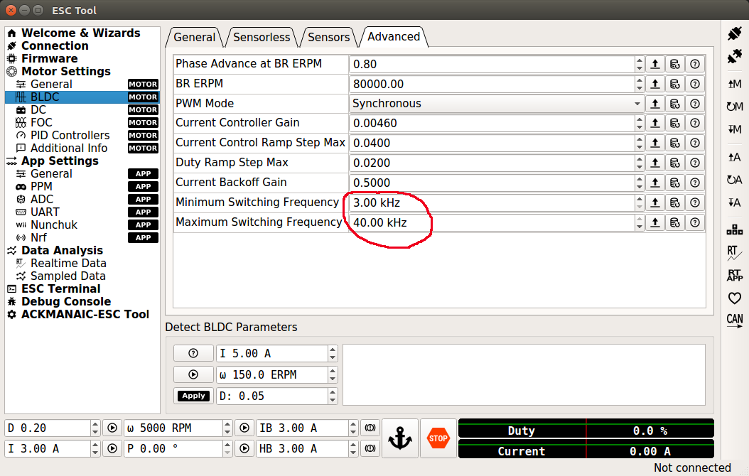

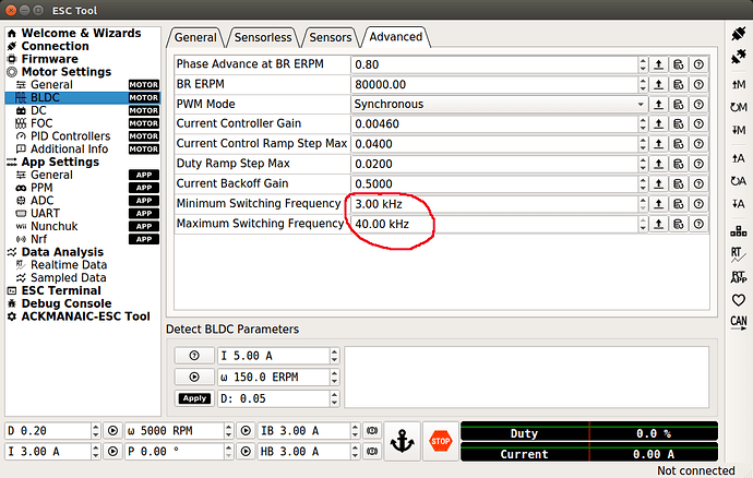

See if you can play with the maximum and minimum switching frequency in BLDC
As an experiment, if I wanted that, and I do love motor noise, than I would first try lowering the maximum switching frequency.

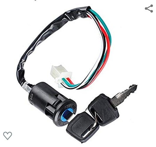

Anyone know of an ignition switch that can handle the amps we use?
Pretty sure the answer is no. From what I can find searching on these they run on 12V power and just trigger a relay to allow the current for the starter to flow and looking at the wires and connector just guessing can’t put that many amps through a thin wire like that without having it melt on you.
Edit I guess if the question is can you use this as a “button” in place of an LED switch or the like then the answer might be yes but definitely no to directly having the power flow through that switch.
@wafflejock Through my searches, I read about high current ignition switches (for systems without relays/solenoids) but couldn’t find any. Wires can always be changed but I’m pretty sure the circuit inside the switch would melt

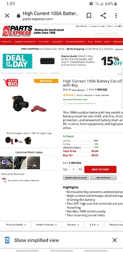

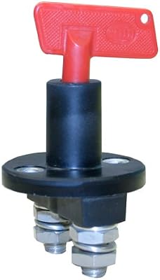

Yeah I picked up one for cutting off power on boats that I think was rated high enough but it was/is massive so I never tried putting it on the board, probably should have checked the dimensions before I ordered it was this one:
thing is huge though and yah never installed or tested because is just too crazy looking and massive (this coming from a person with brick lipos on the board and a hole drilled in the nose for locking up)
Edit have heard of others using breakers I think since they can handle high current depending on the type of breaker and aren’t quite as big as the one I linked but still very bulky, personally just unplug my lipos or used a loop key built into a case in the past.
Lol. I was literally looking at that one right now
