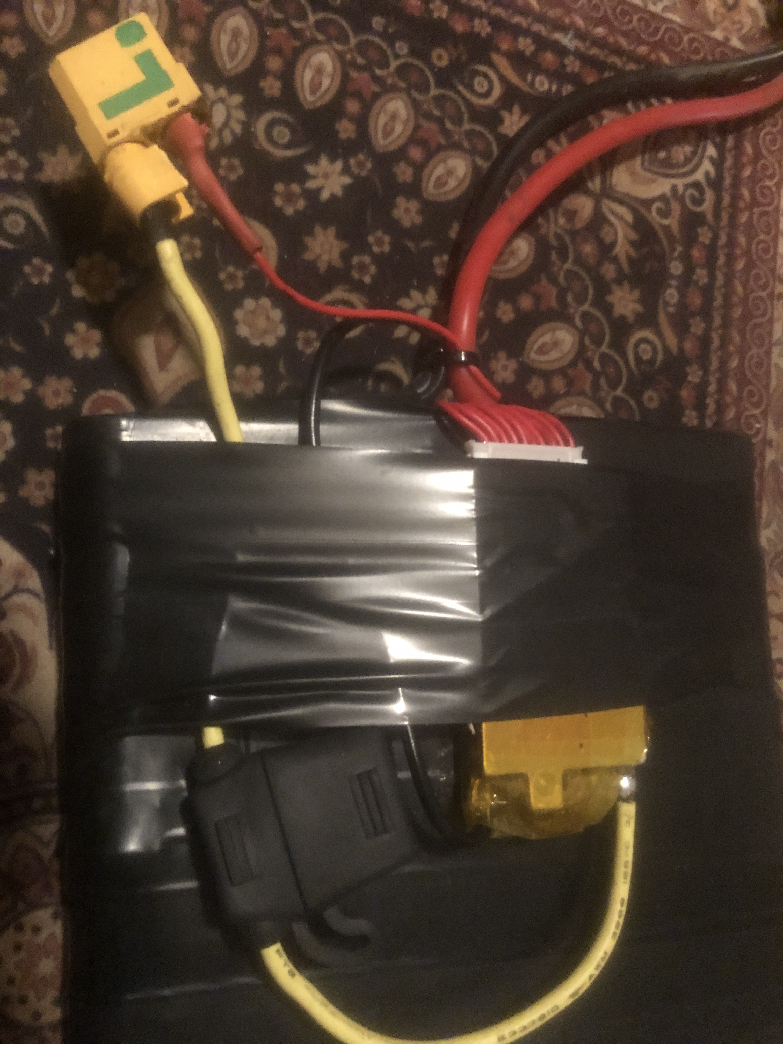

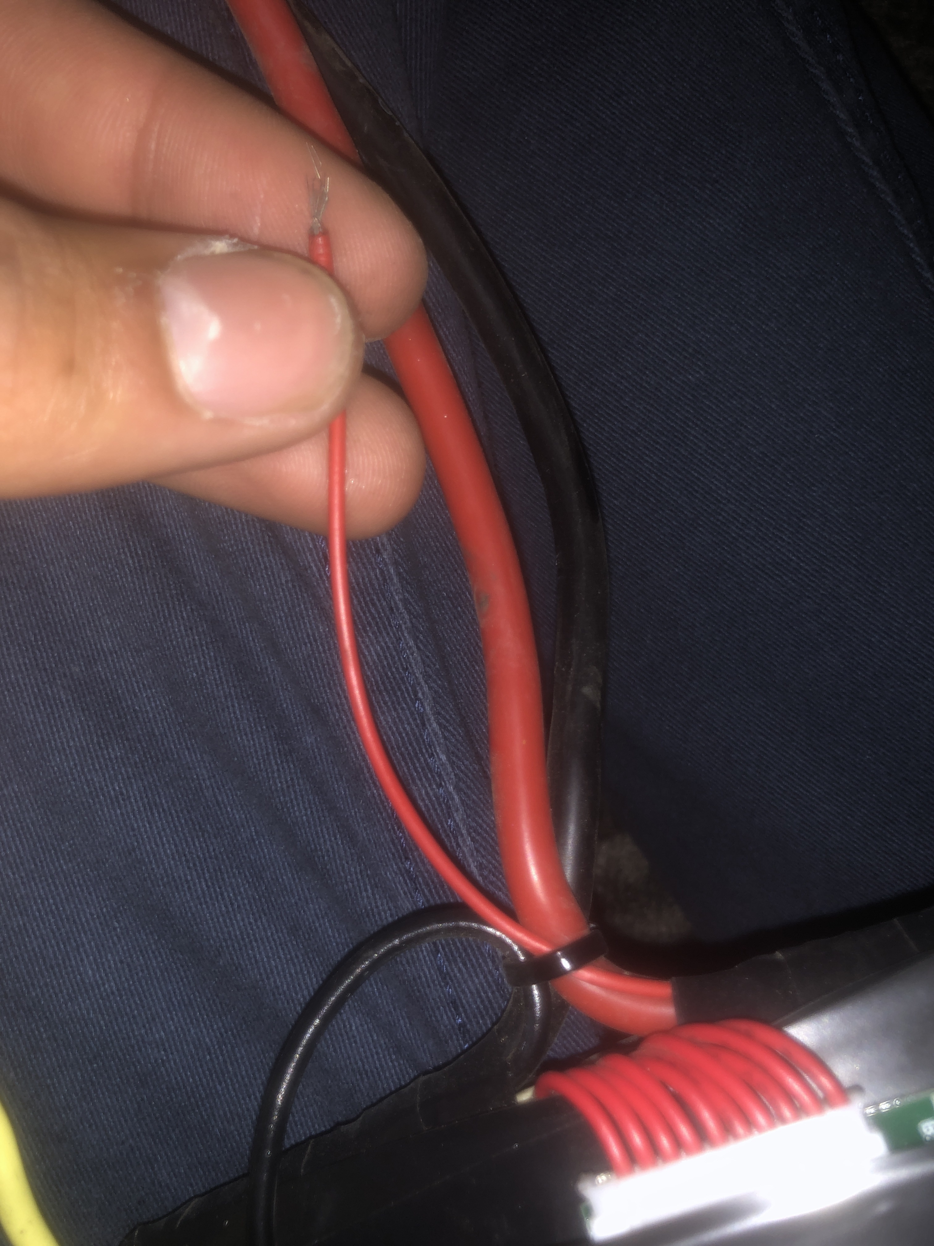

It looks like 26awg,
That’s next to a 10awg, it might be 22awg though. Let me whip out a ruler
Yeah 22awg looks about right
Same size as balance leads, they have a print but I can’t read it. I’m only charging at 4a though

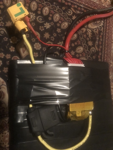

Negative has a fuse on it, another question, is it okay to use larger awg wire for let’s say my negative wire? The negative goes through the bms
This is why
Black little box is my fusebox
Is a weak link😕 I need someone to work on this with me if I’m going to continue using this battery
Why not replace it for peace of mind?
Very limited resources as I promised myself I wouldn’t spend any money this month on esk8, as I need to buy a newer car
What do you need? I have tons of wires. PM
Keep your high and low amp systems seperate in everyway. Don’t use the same connector for the battery/loopkey as you would for charging. Keep them completely incompatible in terms of connectors. Safety first.
Try to wire your board according to the amp capabilities of the wire used and connectors too. Use a xt90s on your battery and loopkey connections by all means but don’t go soldering a 22awg cable onto one for a charge port. For one its stupid overkill and 2 it can burn your house down if you make a mistake and we all make mistakes. Keep your charging port low amp or just a different connector.
