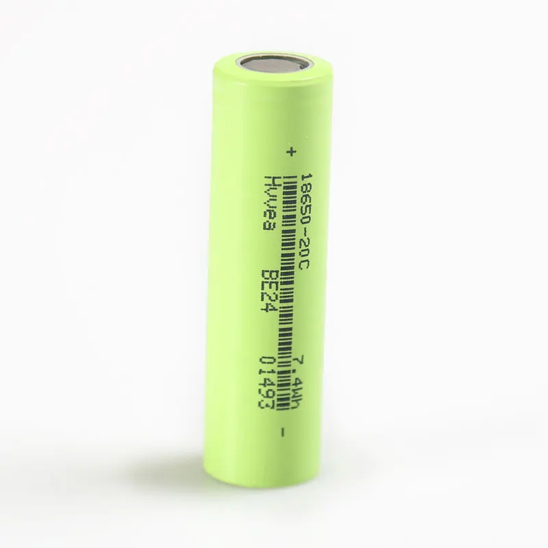

Hey, thanks for your help I’m the owner of the battery,
I found that it’s a faulty bms as I managed to get 36 Volt.
Do you know where I can find a bms?
hey, no problem!
what I found about those cells is that they are only 6A discharge cells:
in your pack, you have discharge rate of only 12A (at best). I guess this battery pack is for some chinese hub board?
First I wanted to suggest that you bypass broken bms and use battery without any bms temporary, but for pack with such low discharge rate, that would be really unhealthy,probably even dangerous.

yes it’s a chinese hub indeed
Wow it’s 1 dollars a piece, so it cost 30 dollars to make???:astonished:
you need spot welder too. and some nickel, wires, fishpaper, knowledge and time. but yes, cells only are 20$, probably even less when they bulk buy
