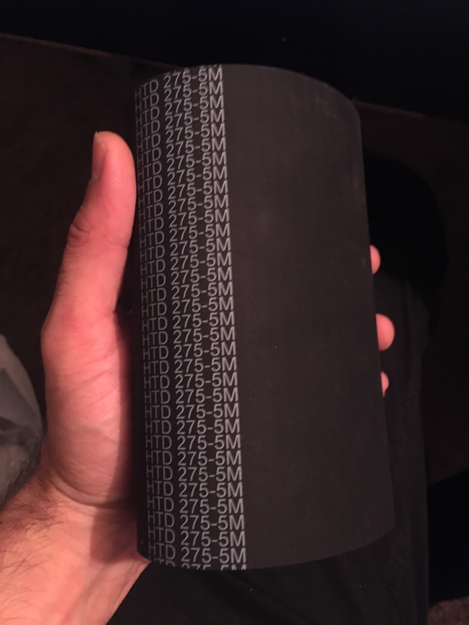

Not sure why the width is even there (in-mesh surface area, maybe?), it doesn’t make any difference on the belt length.
Oh yeah I guess that’s arbitrary info for our purposes lol

Probably because that company doesn’t sell that specific belt cut in that width.
I just noticed you wrote 160 mm wheels but it says in the calculator screenshot 83 mm
good thing I’ve got this thing to cut whatever goddamn width I like :rofl::rofl:

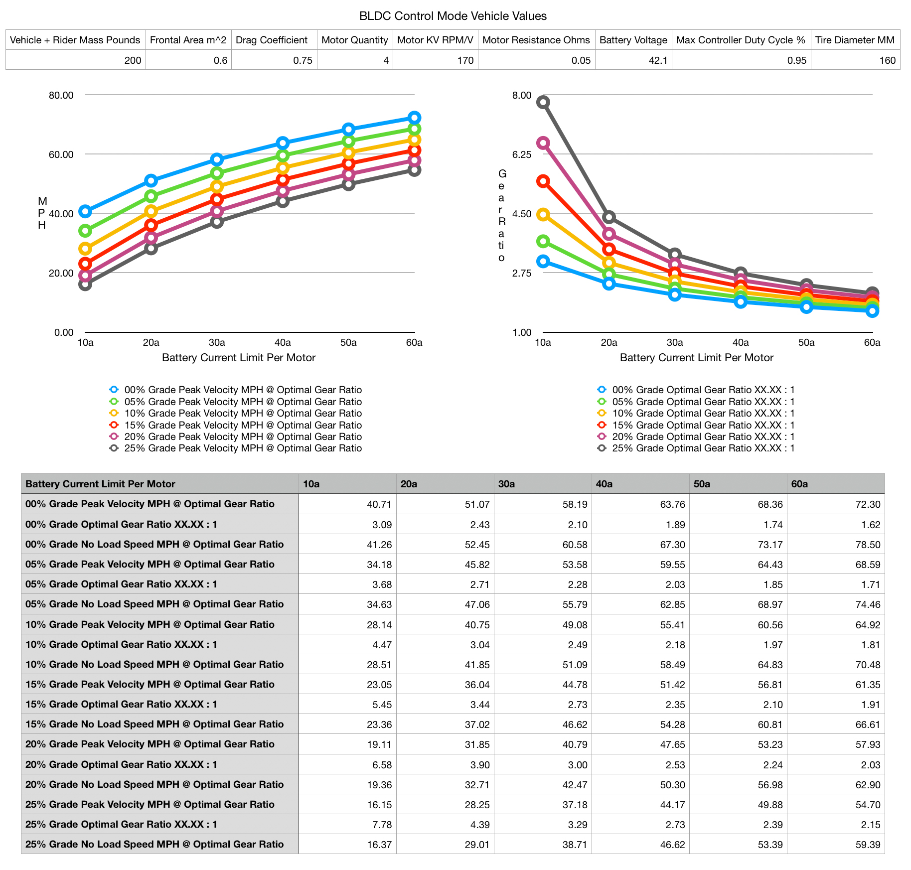

hopefully this makes it more clear:
https://i.ibb.co/C1DGMxf/160mm.jpg
^to a close approximation, anyone with 4 motors regardless of kv or tire size (who is also running 42.1 volts) can obtain this performance by adjusting your gear ratio such that your no load virtual ground speed is the same as the no load virtual ground speed shown on the chart at the bottom.
And just in case you’re a normal human who doesn’t want to scour conditional graphs,
