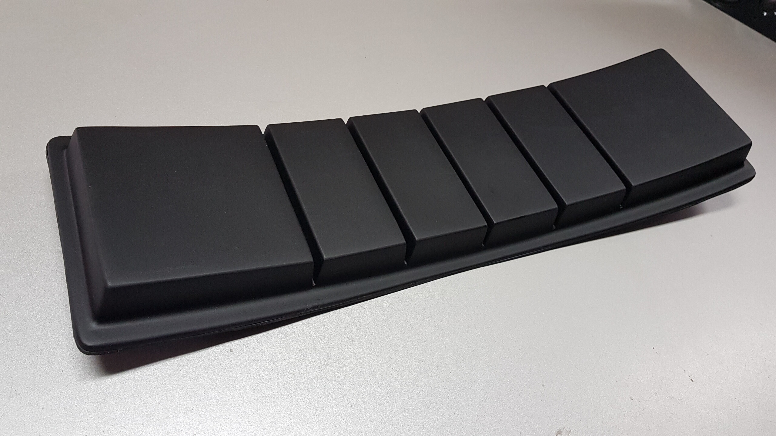

You can fit a 12s8p on this enclosure:

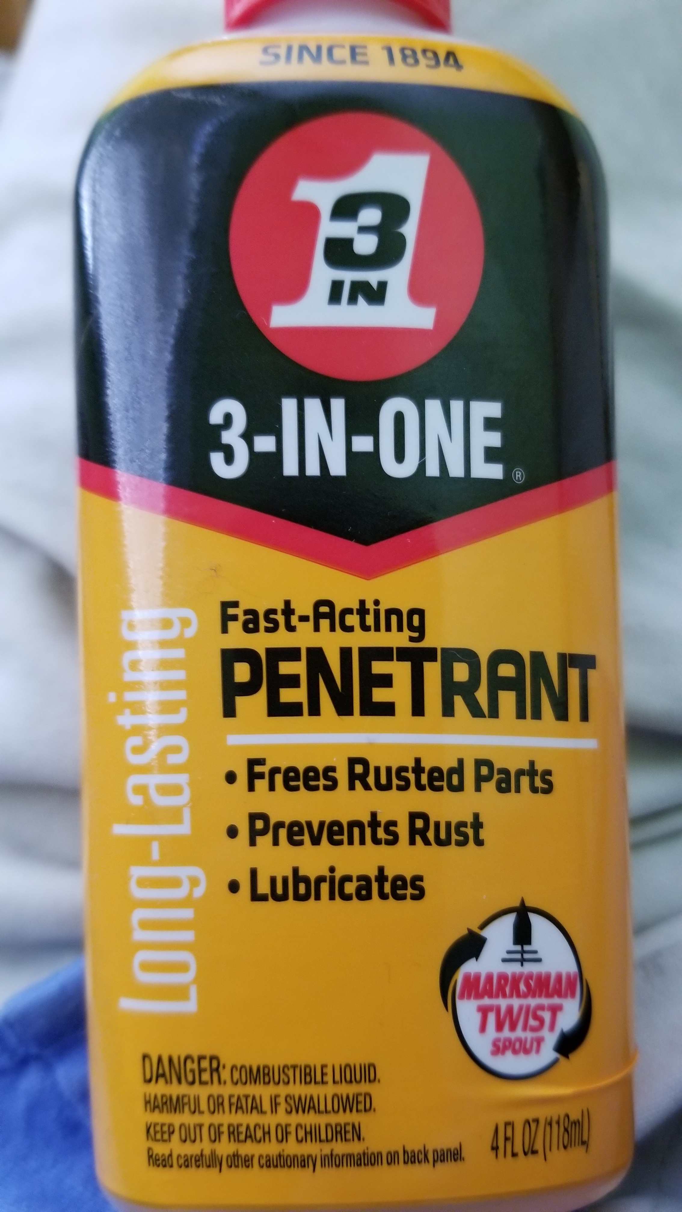

Should it be fine to use this as lubrucation for my gears? It is flammable so I am worried about it igniting if the gear box gets too hot but it can’t possibly get hot enough to ignite it? Not that a fire in the gear box would cause and harm anything besides removing all the lubricant and heating loctite.

@Resonant No, that’s not a lubricant, it’s a penetrating oil designed to break free rusted parts - don’t use that for lubricating anything that you want to work for more than a day. Use grease or a lubricating oil.
