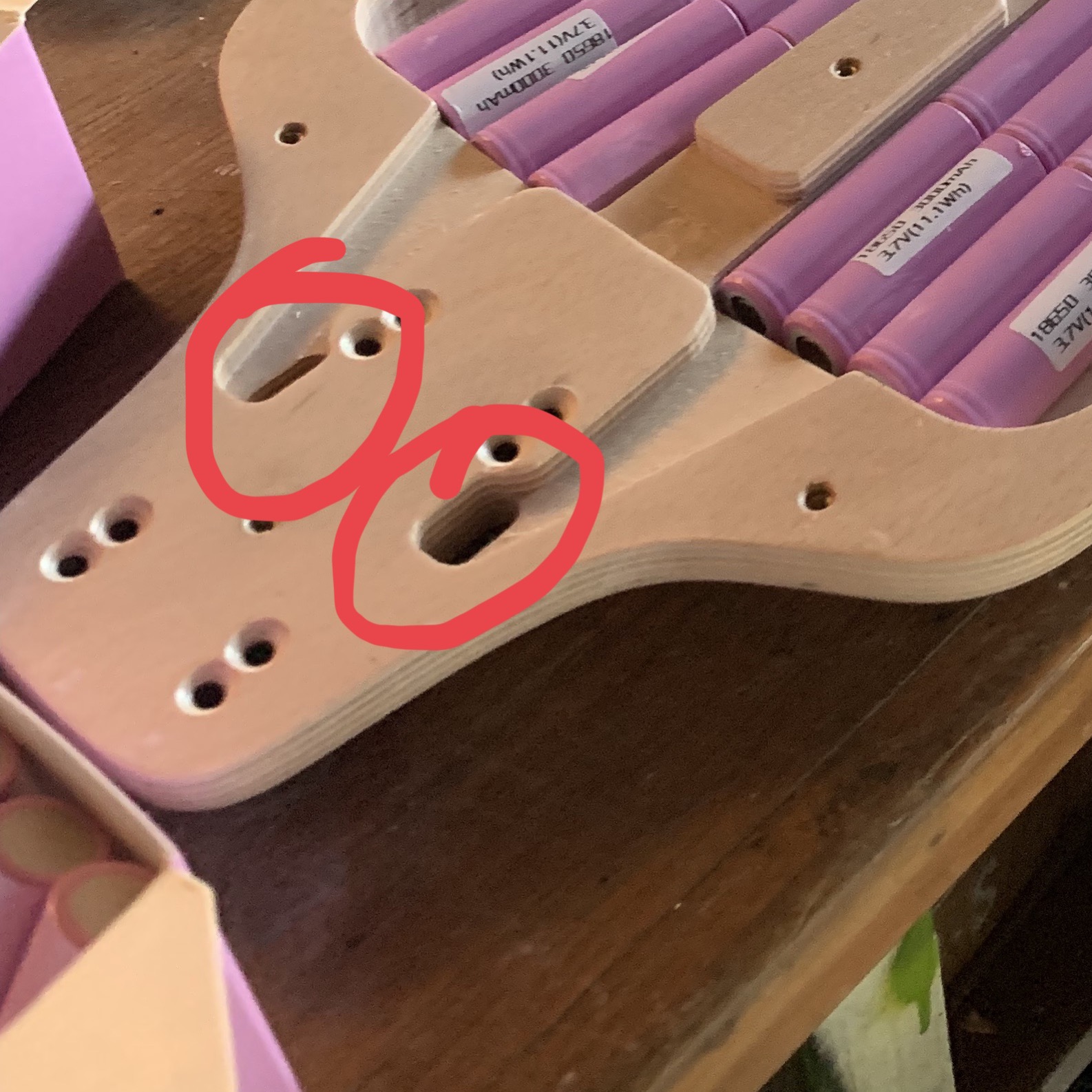

Can anyone shoot me some suggestions on a riser for cables to go through that’ll work with the haya shortboard(for Haggy kahua trucks)? Sorry not at home so couldn’t take a proper photo of the underside.

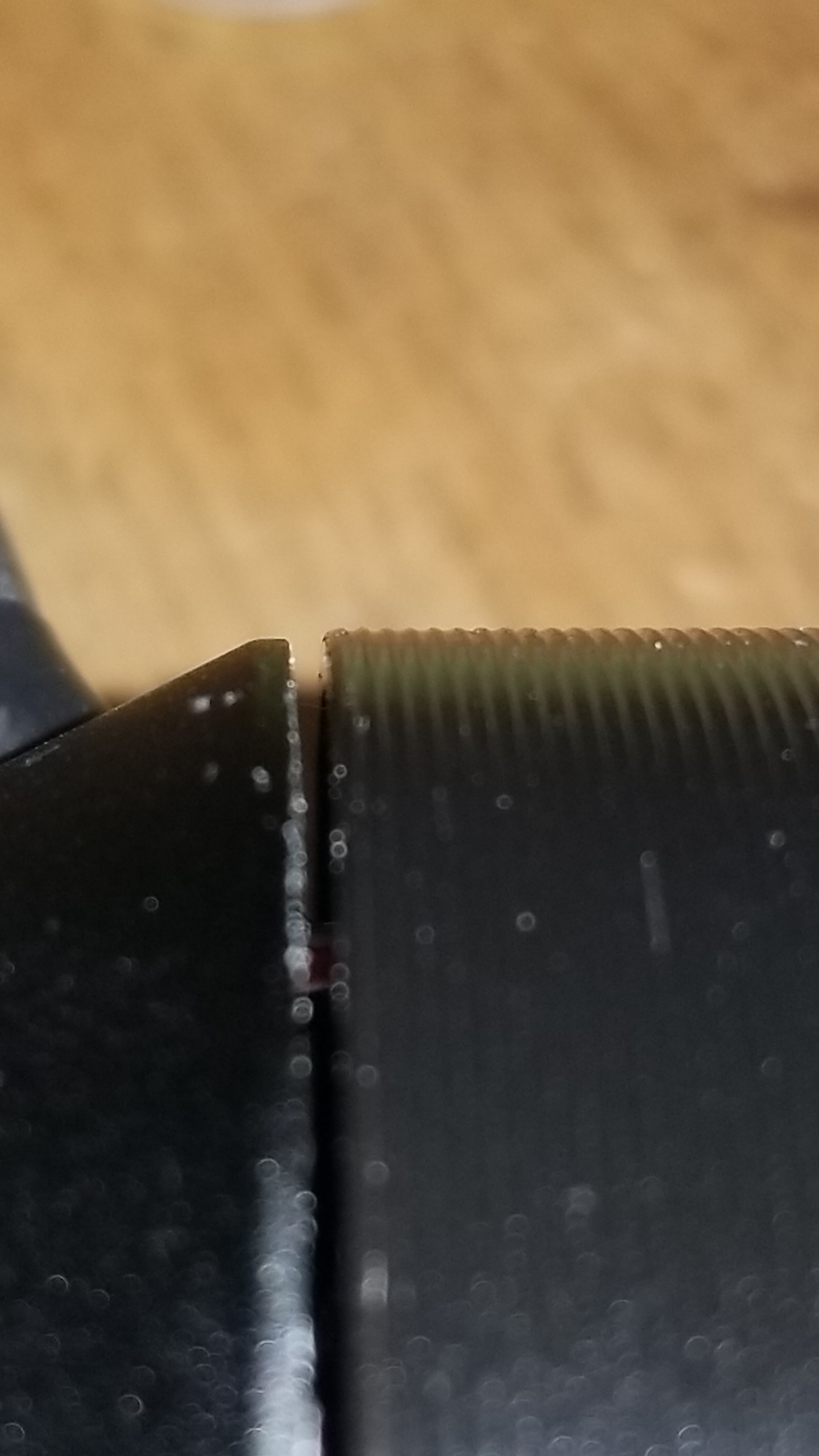

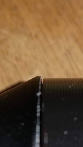

How do I fix this? All I know is the issue is the can. When pushing against the part of the can sticking out, it looks like the can aligns and stops hitting on the inside. The shaft is not moving at all, but when all together the can can move.
Can loose from the shaft I’m guessing. Tightening the grub screws might help. Or not. I ended up buying a new motor after threading one of my screws :frowning_face:
Edit: Just realized that wasn’t your first post. Might be that, might be something else. whoops
The holes aren’t under where the riser sits, so literally any riser / truck will do as long as your wires aren’t super thick.
