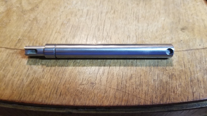

Maybe rotor shaft is slightly bent causing the scraping?

Looks straight to me I just lined it up next to a long hex key, but this I see a very tiny curve, but very tiny, it is very hard to see my camera can not capture it.

Regarding your motor shaft, a bend of a few thousandths of an inch is all it would take for the bell to scrape - it’s a long lever supported on only one end - the end farthest away from the magnet scratches.
I’d hold it up against a known good straight/flat item - a granite countertop or a steel ruler, etc. Any light visible between the shaft and the reference indicates a bent shaft.
Think replacement shaft is around $10 probably worth a try since you already have the motor apart so long as you don’t mind waiting on shipping to reassemble or can get it back apart pretty easily.

$10 says bent shaft. It only has to be off by a few thou to rub.

Tried both shafts: No change, still scratching - shafts ruled out
