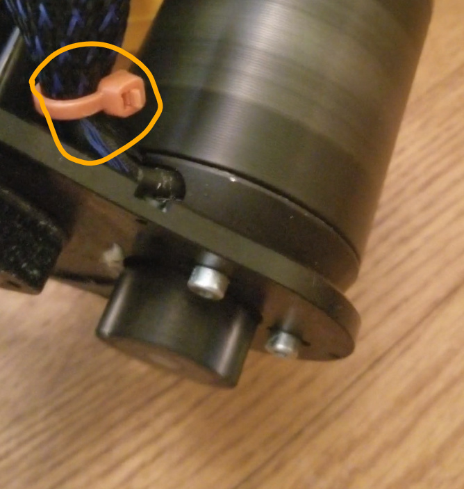

Motor making noise at a little push of throttle, and full throttle but mid throttle but seems a little louder than the other motor
I just took the motor apart and everything looks good but it stll makes the noise.
This is all I can find, seems like something is causing it to scratch.
Maybe it’s has something to do with the retainer ring not being able to spin because of the motor mount
If that’s why just add washers to the inside of the mount
might sound stupid but is it the zipties?
Ummmm… what!
Does it make the noise out of the motor mount
Try spinning it outside of the mount
