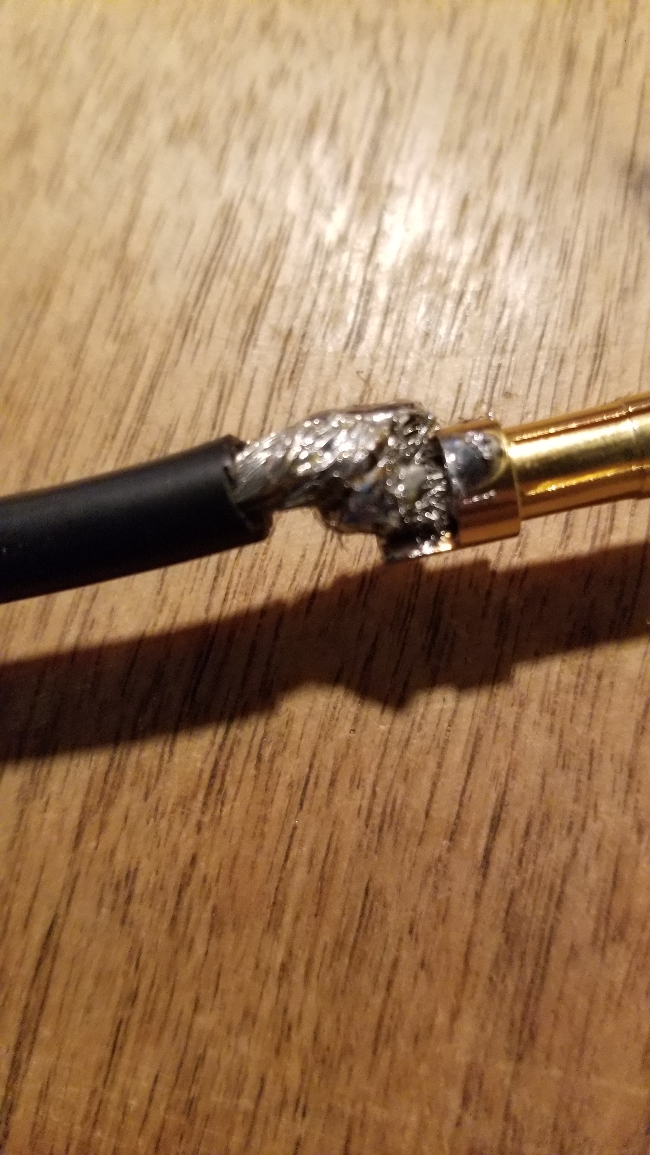

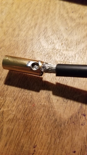

Is this okay for a first solder? Feels mechanically strong. Just tried pulling it apart with as much strength as I could, still together.
Strands started going weird, should I redo this one? Also strong atm.
@esk8manbabes
