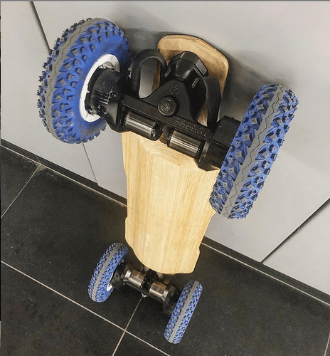

The Arc Finix
The Arc Stryx
There are a few more that we’ve yet to show as we are still working behind the scenes on them, but you will eventually see them on here! Till then, be sure to watch this thread for more updates to come.

This is… …something else entirely…
Wow…
What are the handling characteristics of this, both in theory and empirically?
Also what do you call this? TRKP?
I was just thinking this, very interesting truck design. I have to wonder how it performs in comparison to DKP. I would imagine it is more stable for sure
I’ve been doing a bunch of range tests on both the Finix and Stryx and they both have this truck set up. I would say it’s in the middle in terms of stability between RKP and DKP.
Then again… the bushing set ups are not ideal yet. I am using Orangatang hard bushings on the RKP, and stock TKP bushings, and stock pivot cups.
We plan on calling this… the Fusion Kingpin. But open to other cool names!
I can already see skaters hating this like how they hate how we use double kingpin trucks
Keep up the good work!
I’m interested. Is there any videos?
Reverse kingpin roadside combined with traditional kingpin boardside.
RKRCTKB
Rekct Kingpin
That’s catchy.
That’s a tiny gear drive right?
Is that something that’s been out and I’ve missed or new for these boards?
Can you say what the ratio will be or still in testing?
Did you design the deck?
Yes it is! The gear drive will be able to fit wheels from 85mm to 120mm. That means your favorite Kegel/Abec type wheels will be able to fit our adapters. 80mm Kegels might work but the gearbox may be too close to the ground for comfort.
This geardrive is our third revision, and is a fully sealed drive with a bearing seal. The first version had no V ring nor bearing seal, so road dust could enter the gears over time. Surprisingly, we had 0 gear drive issues with the V1, and it was on our single drive complete board!
I gave some suggestions and feedback… but @ArcBoardsEV was the main man behind the design of the deck. I’m the hands on guy :smile:
It looks great, how many plys is that thing? It doesn’t look like bamboo is it maple?
That’s how you keep a good job :smirk:
Let’s just say it’s a LOT of plys. It alternates between Maple and Beech. Every four layers of Maple, there’s one layer of Beech. The deck has a thick belly similar to my Chonkas build, and i started with a 45mm thick block.
That’s for after office hours… :shushing_face:
Ride footage? I had some recorded, let me see if i can find them.
I would love to see the FKP in action
Beautifull deck and interesting truck design
Does it allow drop through mounting?
