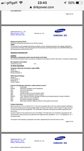

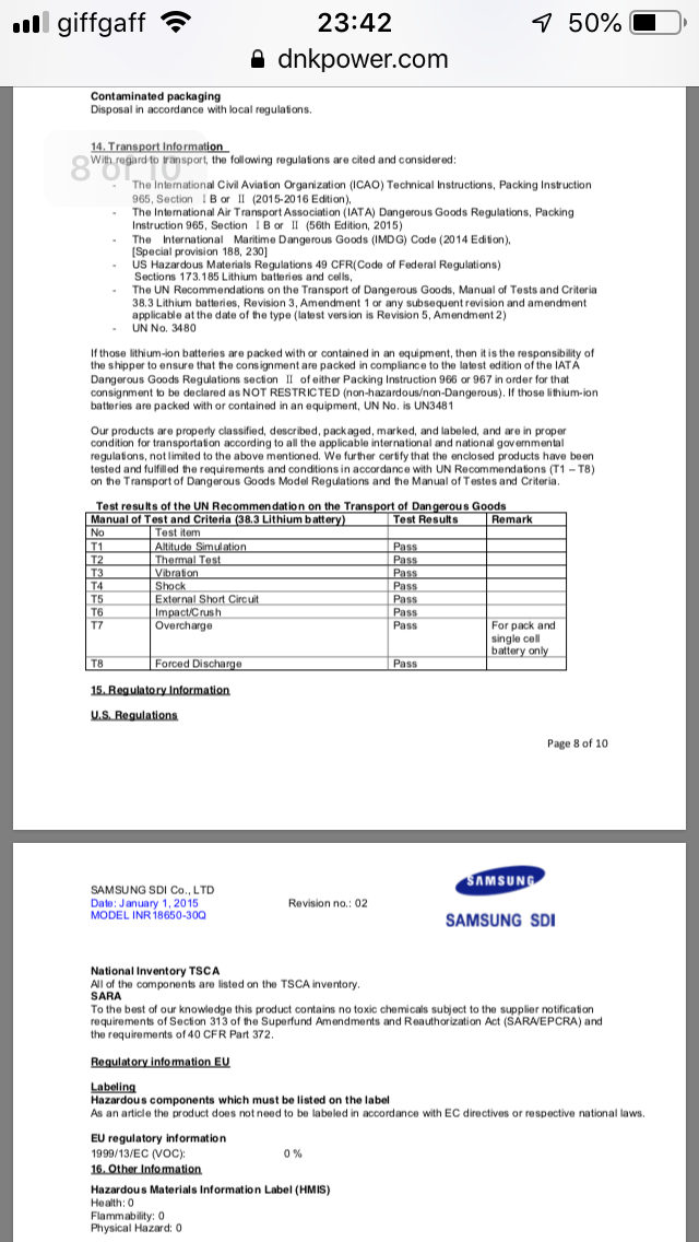

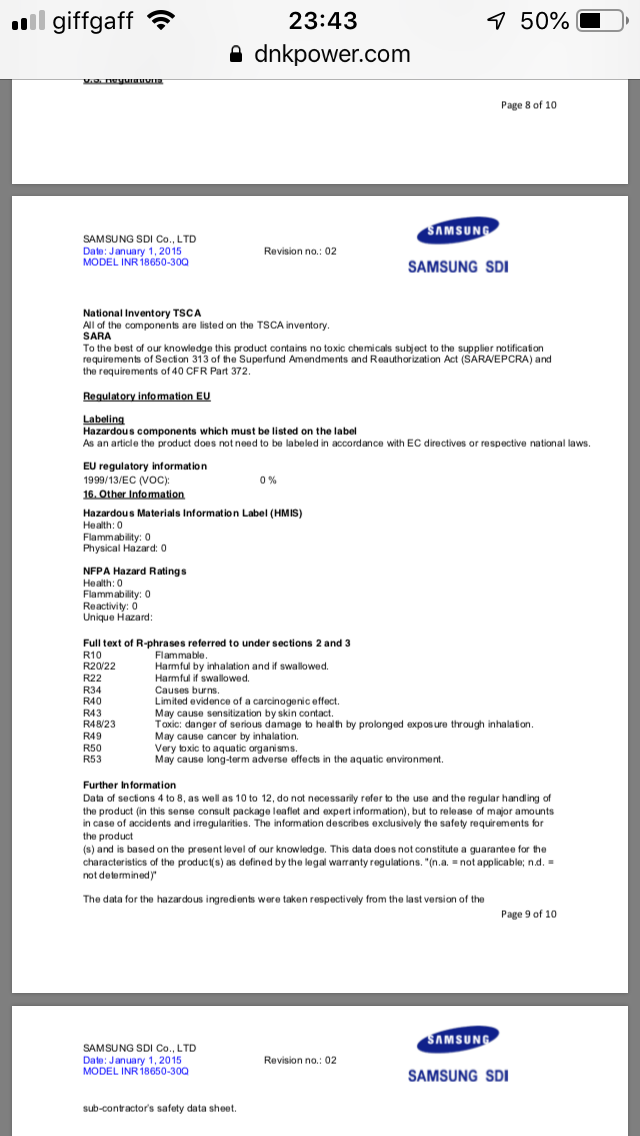

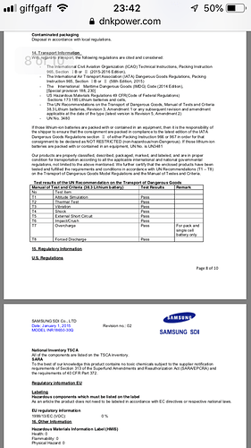

You used 30Qcells I presume
Takes 10 seconds to google
