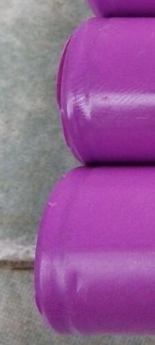

The wraps at the top of those cells are not tight. Was that from things you were doing to the cells or did they arrive that way?
If you got them like that then those cells are very suspect. Check if the top ring insulator is glued on or not.
They’re wrapped adequately.
The three on the left are still virgins. The two on the right were in-and-out of the charger several times for testing.
not glued
