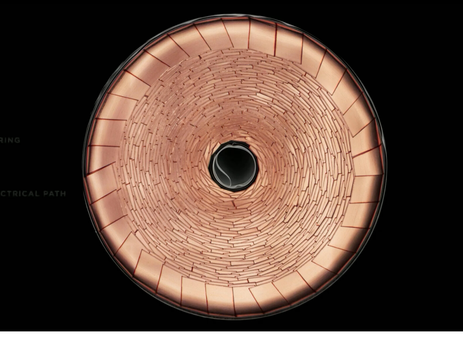

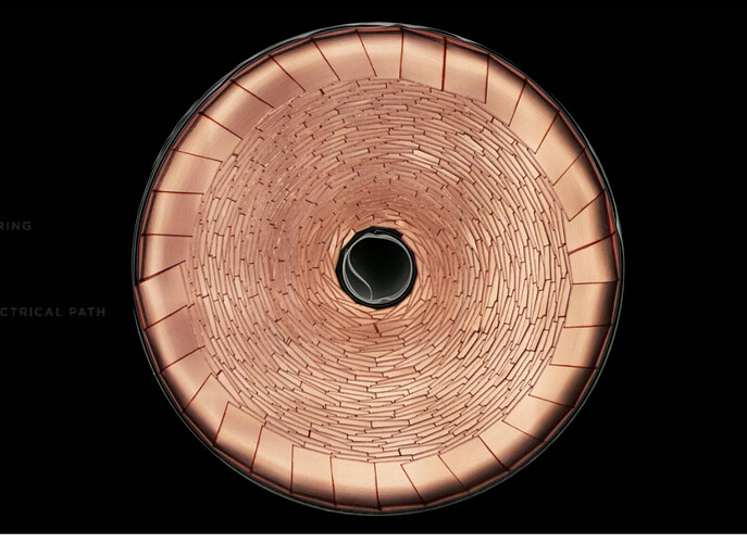

I’m expecting Tesla’s first high drain cell, in essence. A doubling of diameter = roughly a 4 x increase in volume, I think. So perhaps they will be 16,000 mah with at least a 40 amp cont rating, but I really expect more. However, 40a cont would be enough to go 2p. That would be fine for a bottom mount enclosure. I just don’t like thick bottom mount enclosures. I think these are very conservative guesstimates. What do you think Tesla is saying when they say “6 x the power”, and why do you think they added all of that copper to the cells? Do you really think they won’t do 40 amps cont???
The copper you see are the tabs for the neg there’s loads of thin ones down the coil length instead of 1 that’s in most cilinder li ion. Think of it as a hybrid between 18650 and poutch cells. All in the aid of reducing the IR and increasing the heat dissipation to improve the cells life.

Yes it’s a clever new manufacturing aprotch that I hope can be applied in some way with out infringing the copy rights that can improve the construction method and lower IR of other cells with hi discharge chemistry. This could make some incredible hi discharge current cells.
Reducing the ir increases the potential, right? As far as I know, and in existing 21700’s, current has to flow through what is essentially a coil, but with this “tabless” design (which is kind of weird because 4680 has more tabs than it ever had, they’re just folded over) it no longer has to go through the coil/tab/terminal. Now, it’s from any given surface area, to the copper tabs, and then the terminal. That just seems like a really big deal in terms of potential. I think we are getting to the point where we can have the best of both worlds: high drain, and high capacity. Don’t mind me, I just enjoy speculating and visioneering.
Yes that’s why it’s 6x the power with only 5.5tines the volume resulting in a 9% ish increase of discharge power vs volume but that’s other cells out there doing 150% more power to volume like the p42A so Tesla are still a long way behind if thay intended to make a super hi discharge cell.
So there still well and truly in the low discharge catergry as My opinion. I am expecting long cycle life with the improved thermal cooling options that come with this new packaging techneak.
What are the internal differences between a high drain cell, and a high capacity cell? I don’t think it’s a difference in chemistry as much as it is a difference in physical layout. I think they have to use thicker (edit: copper collector, thinner anode material = less capacity)cathode and anode layers in high drain cells, but I also think the only reason they have to do that, is because of how the current has to flow through just a single tab. So, current originating at the very end of the roll, has to travel the entire length of it to reach the tab. Not so with the 4680’s.
