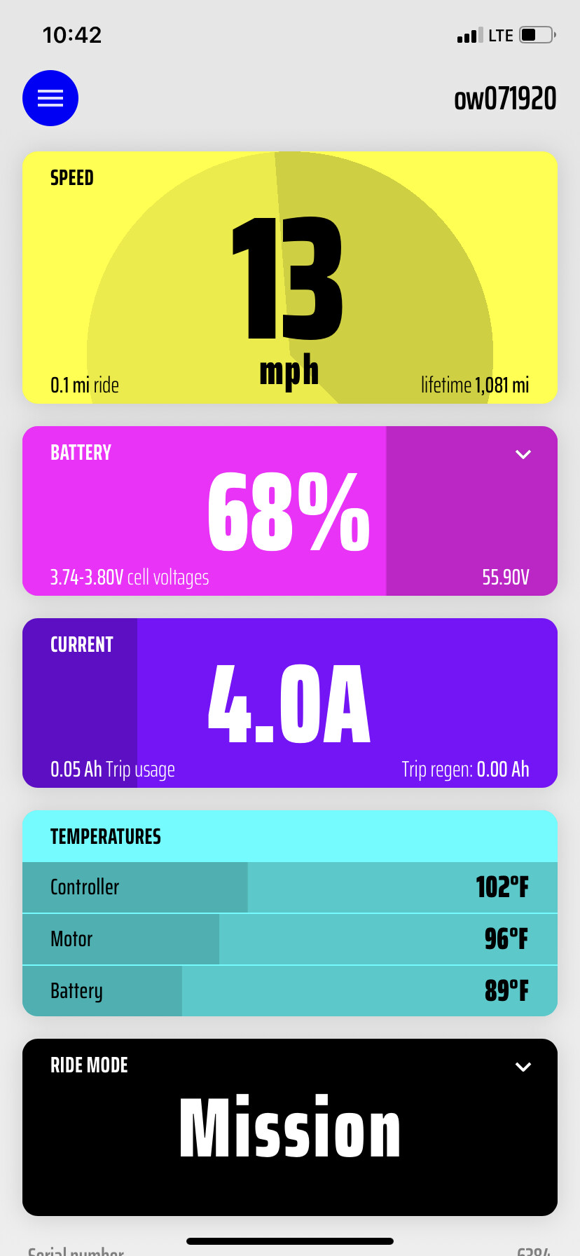

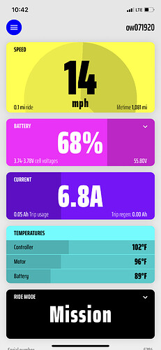

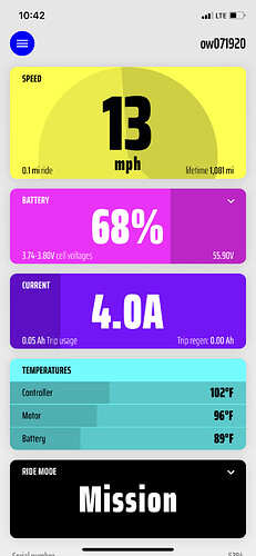

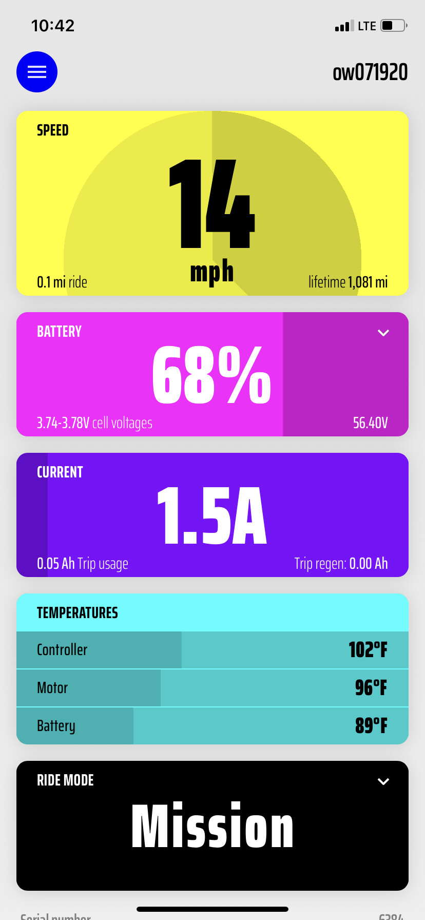

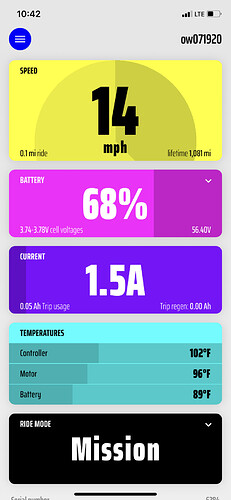

Just grabbed these for reference:
Don’t mind the high temps and low ride mileage. I’d been riding for a while, and restarted the board to connect it.
