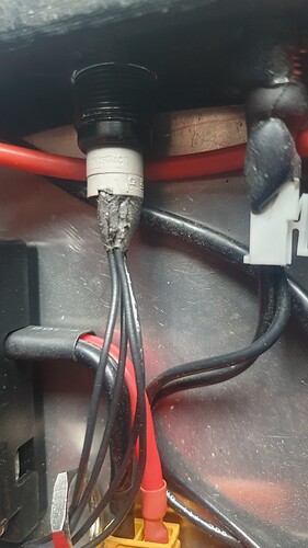

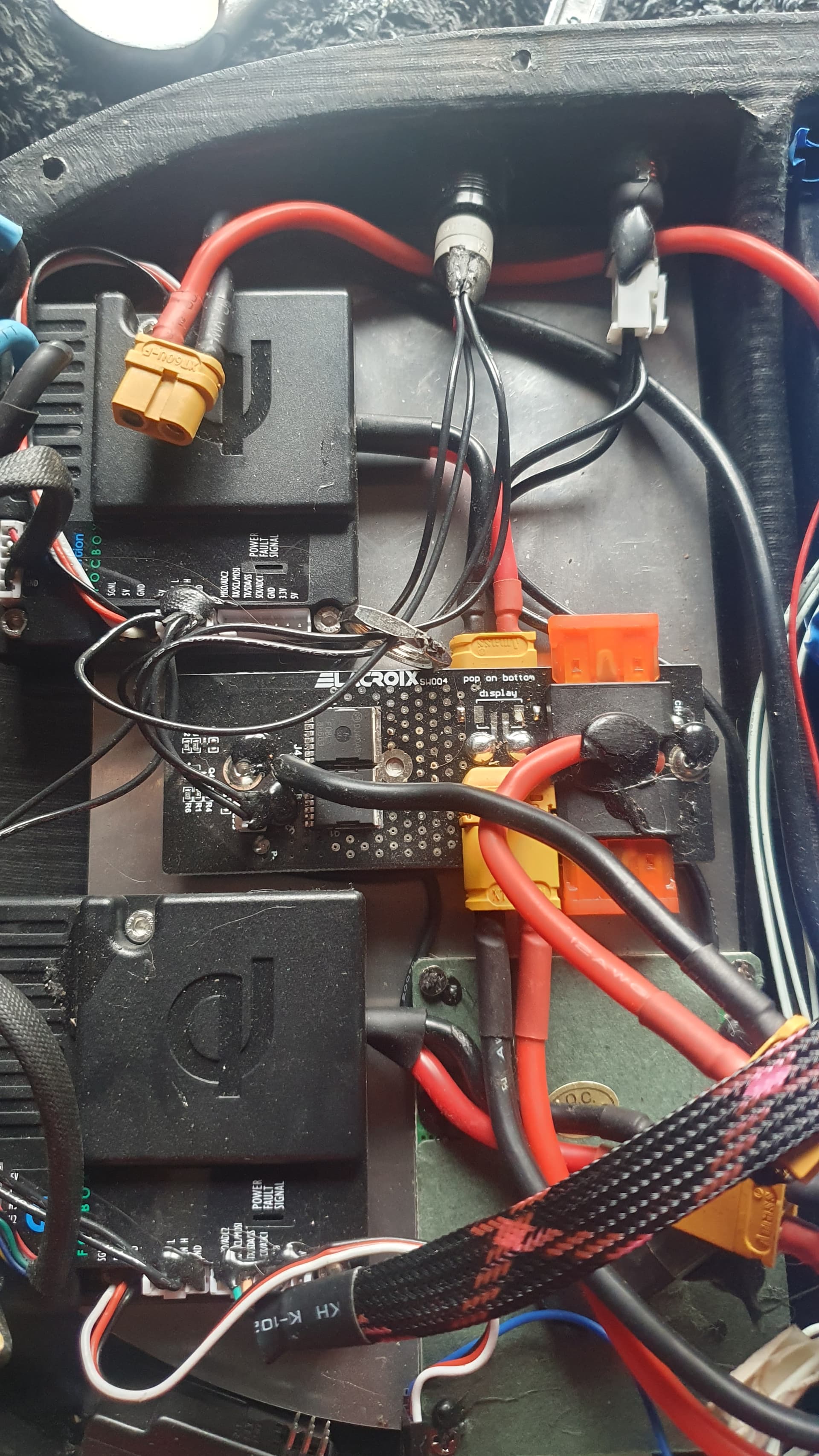

Well, this is the state of the power switch wiring once heatshrink removed with separate shot of rest of internals
Forgive my ignorance, but is the grey thing a fused anti spark switch ?
It seems to be a 2 part thing but doesn’t wanna come apart

That whole thing in the middle is the antispark switch.

Ok so the sentinel board is also your anti spark afaik. The two wires from the switch that attach to the board (bottom circle) are the switched input from your button (mounted through the enclosure). Take the glue/silicone off of that connection on the sentinel board and test your switch there first . Use continuity or ohm on the multimeter and test if pressing the button changes the state- open to closed, closed to open. Probes go on the wires of the connector. I think that button is momentary so you might need someone to help hold the probes and press the button at the same time.
If the button tests good ( it does change state) then next step is to jump that connection on the sentinel board and see if that turns the board on. If the button doesn’t test good then you need to fix the solder the button or replace it. Test it and check back.
Bypassing the sentinel board is another option when you determine what is broken - bypassing it isn’t hard but it is a little involved and intimidating if you can’t solder yet.
side point. not sure it was called sentinel? the sentinel is printed on the later circuit board in the nazare and later boards that used the focbox unity. they do slightly different things. since the unity had the built in antispark and the later boards had lights and a buck to power on.
anyhow… back to the regularly scheduled useful advice.
That is seriously OG! This was a bit before my time with Lacroix so none of my spare stuff matches this guy unfortunately. I think the name sentinel was derived from the fact that it was an anti spark but it also connected to the bypassed bms and would turn off discharge in the event of the undersized discharge circuit on the bms switched off. So it was watching the bms and responding hence sentinel.
Can’t comment if this older version is still doing that was trying to see if any wires were going to the bms. At any rate, that functionality isn’t exactly critical so any anti spark that fits mechanically should work to replace this.
First part of test done by probing the 2 wires on the sentinel whilst pushing power switch.
The change of state registers on the multimeter but whether i hold the button in, locking it either on, or off, ( both states are registered ) makes no difference to the power being permanently turned on to the esc’s and remote receiver.
I will check the 4 button wires , can make a solder joint work but errrr, elaborate on the jumping part, if you will.

When you test the button, it sounds like you just press and release it quickly. The multimeter you have isn’t fast enough to show that well in the video but i think i saw it hit zero. Give it a second or two to register and display the readings. (It is not a bad meter, just takes more time than you were giving it).
It is a normally open momentary contact button from what i can tell. Holding it down it should show 0 ohm - short circuit.
If you are testing at the connector that plugs into the battery board/antishort? That tells us the button works perfectly fine and the input isn’t doing anything with the signal OR the button isn’t getting a signal to turn on and off. Are the button wires the ones that cause the board to turn on when you shake or smash the wires around? Finding the wires that do this will be the quickest solution here
Yep- it showed 0 Ohms, so that only leaves the other 2 wires on the switch.
They seem connected fine. The board is permanently on unless i unplug the XT60 internally. I’m sure that the back of the switch is fused but it will not come apart, these go to the slave focbox.

Lol, too many threads and not enough sleep. The antis-parks sometimes just wear out. The foc boxes just want power to turn on so all the switching is at the antispark board. Looks like replacement or bypassing it should get you rolling. Id grab that replacement that was offered up or just go loop key for simplicity
