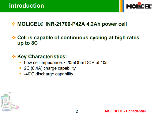

Excuse my ignorance, but is discharging at 20 amps not the same as charging at 20 amps?
Not according to the specs for most lithium cells. For example, Samsung 25Rs are rated for 20A cont discharge but 4A max charge. I think like others say though, it’s ultimately the BMS that manages your cells so if you have a faulty one or BMS not rated to manage 20A you may be in trouble.

There’s technically nothing wrong with charging certain cells at 8A, the p42a for example have a max of 8.4A for quick charging versus 4.2A standard charging, and I suspect many cells out there can charge at 2C safely at the possible expense of lifespan.
the lifespan thing is a really good point. I wonder what impact the 20A charger will have on the lifespan on the Exway board it’s marketed for. Average consumer will have no idea about the tradeoff they’re making
It shouldn’t make much of an impact, if you fast charge the cells, actually, at their full 8a per cell, then you see much less longevity
But that is not the case
