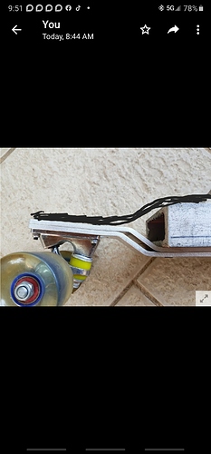

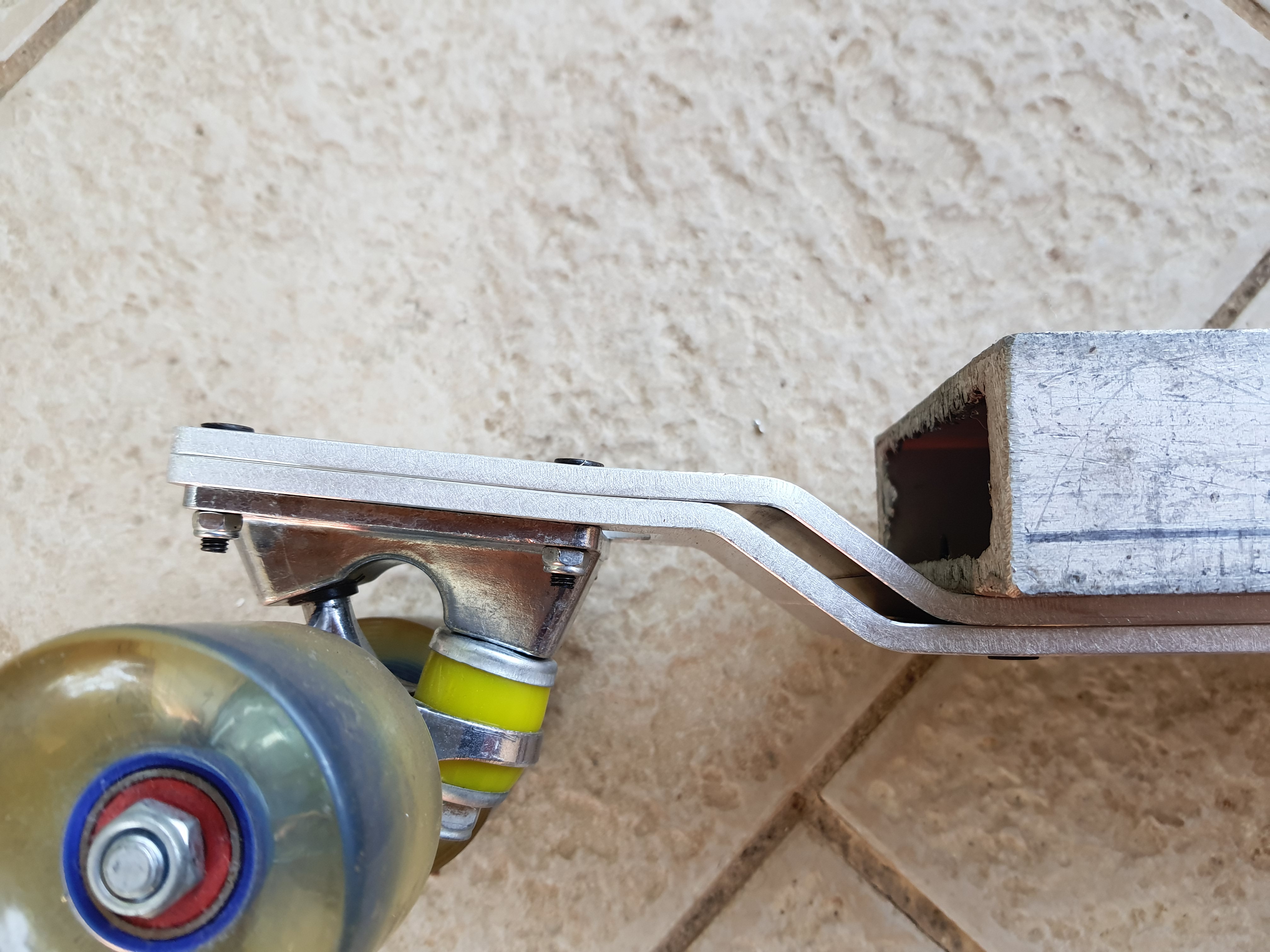

Aluminium Drop down brackets?
I see now
Stainless steel would be ok, but quite heavy
Also, I think the front plate (where the base plate is attached) could be a bit shorter
This would decrease leverage
How much weight did you put on it?
I’m 90kg, so all of it…
The design loads were 60kg as in 120/2
I’m 68kg, so I think those would be ok for me
But I get that stronger is better
Yeah but if you accidentally hit a pothole or whatever I bet the force would be bigger then a bouncy 90 kg load
It might be, that’s why these are not released yet

Maybe add one more piece?
Maybe 5160 steel. Think leaf spring
How about something like this
If the mounting holes are moved back near the drop bend, they will improve stiffness. They are now too far at the bracket’s front leaving too much space between the mounting plate hole pattern and the drop, thus there is considerable bending now.
I think the double bracket design is clever and normally it should be enough for strength and structural loads purposes, but the hole pattern was placed to far at front so all the double bracket design advantages were lost.
There would normally be a deck there… so this piece would have to be custom made for each particular
You’re right, moving the holes back will reduce the bending moment.
There’s a concern with bending line too close to the holes, I don’t want surprises there
you mean deformities on the holes? i think you can solve that by drilling the holes after, also there are design rules for that!
