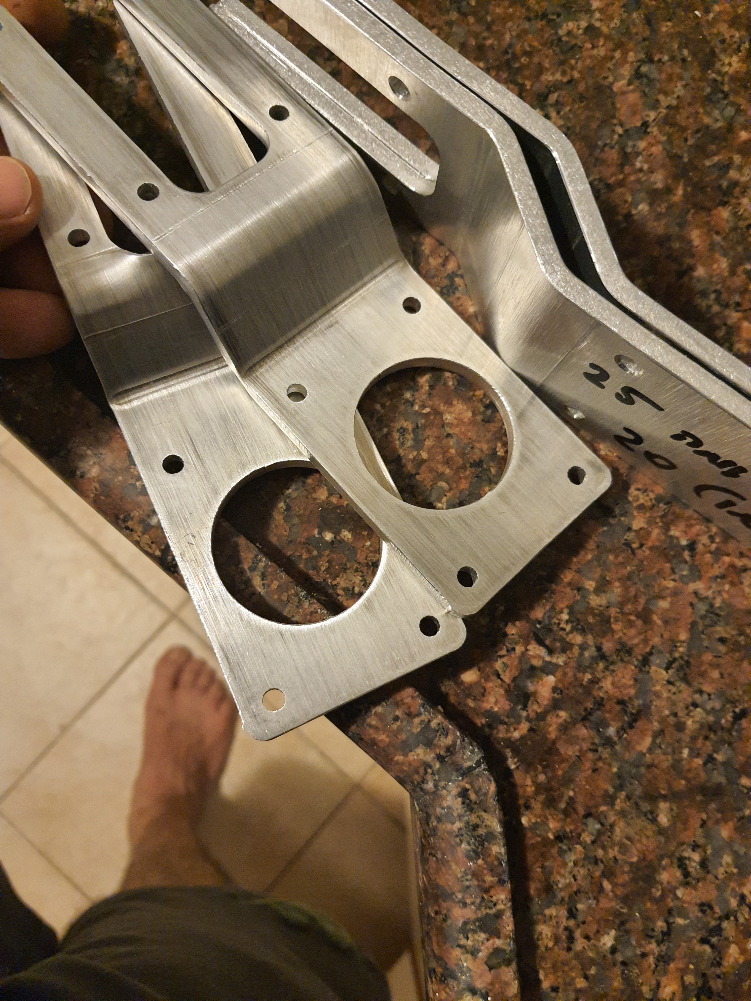

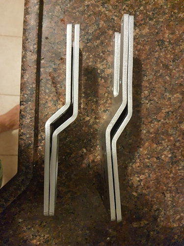

Second version.
This one has more “aggressive” drop, meaning it shorter and with smaller bend radius than the previous one
Did a small weight reduction where it connects to the deck

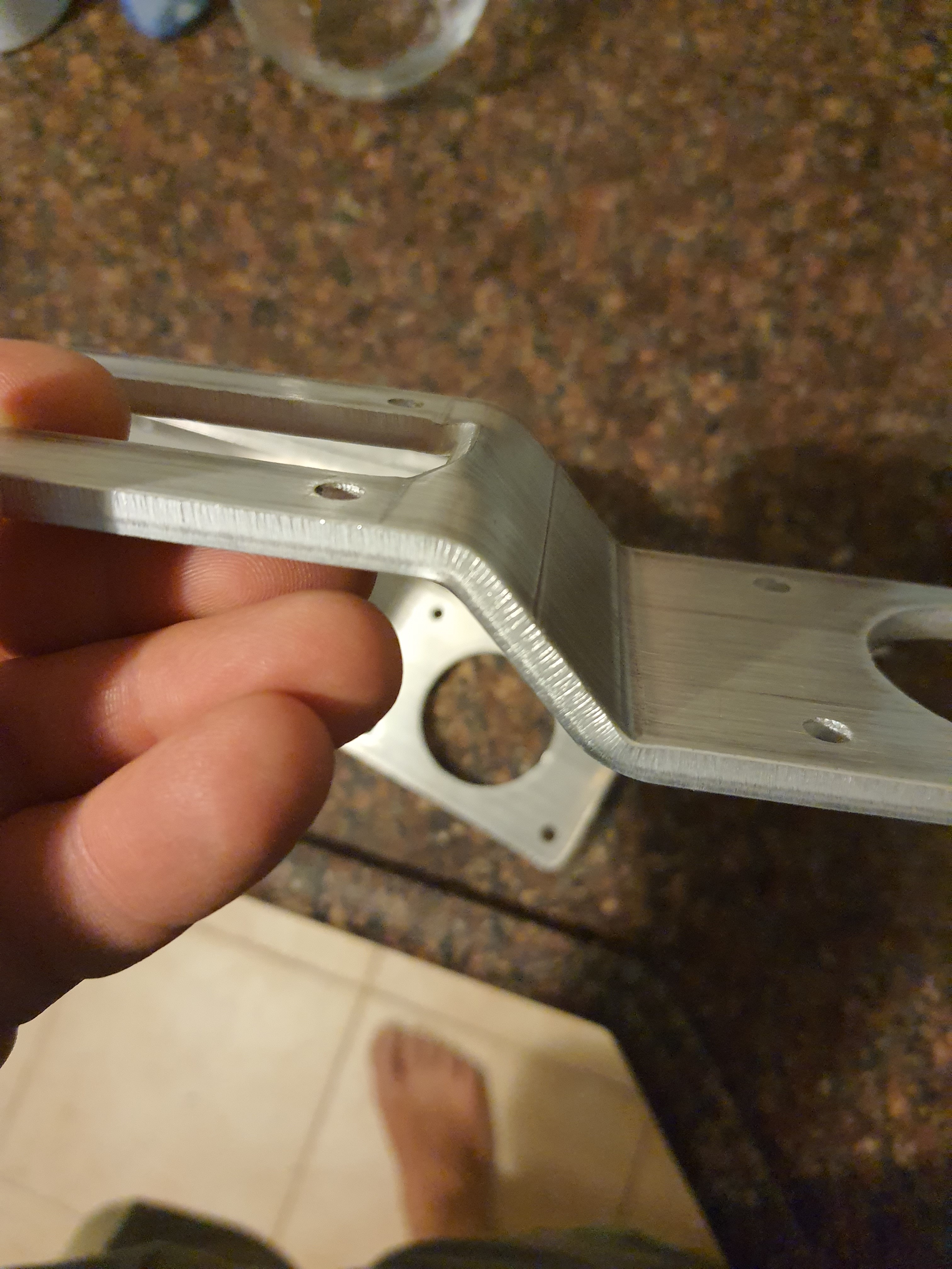

And there’s a need to revise this a bit, the bend is very close to the cutout, then this happens
There will be a notch there to eliminate this (learning the neuances of sheet metal bending)

Still aluminium?
Yes
I like the aggressive drop a lot
