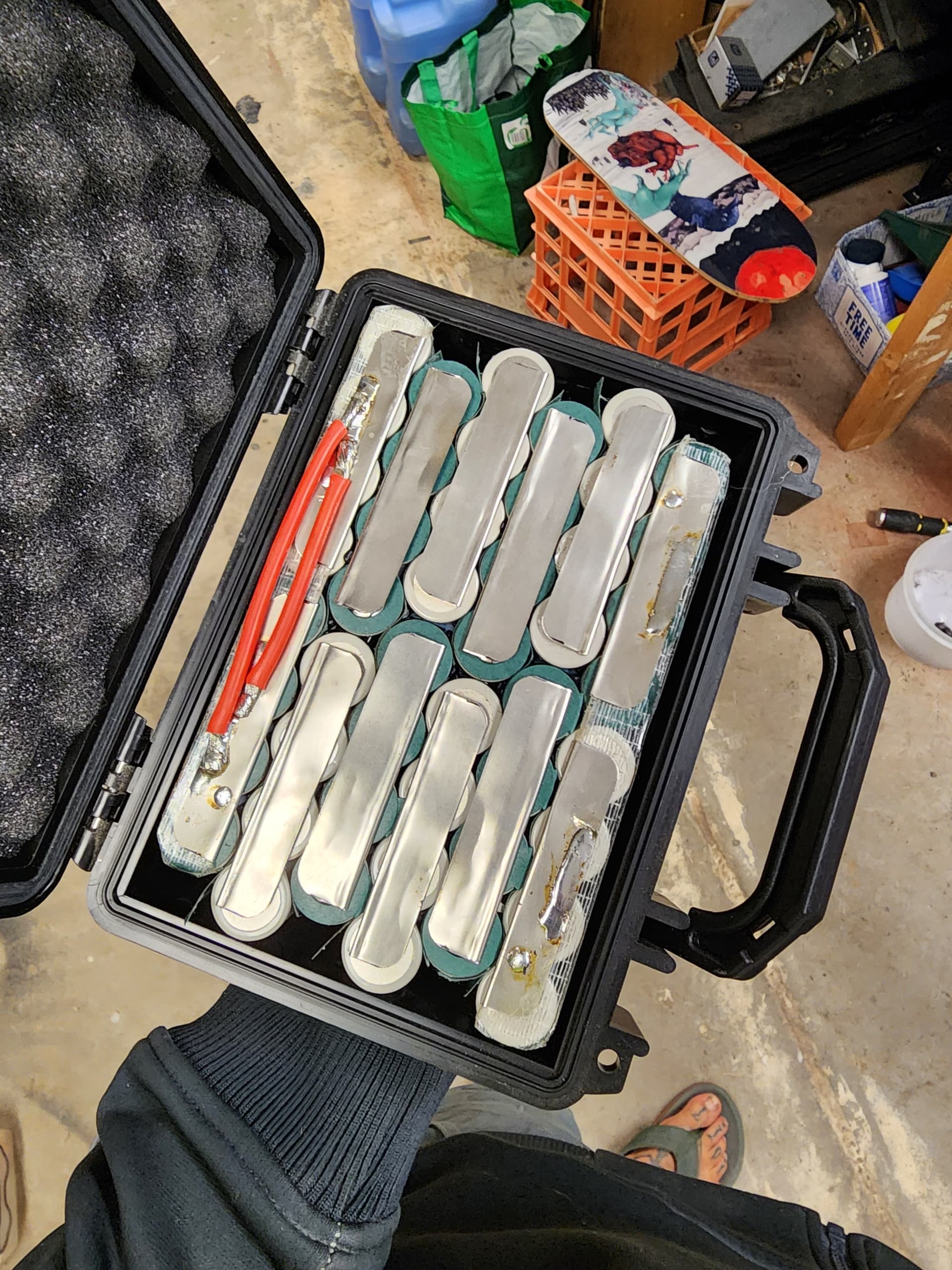

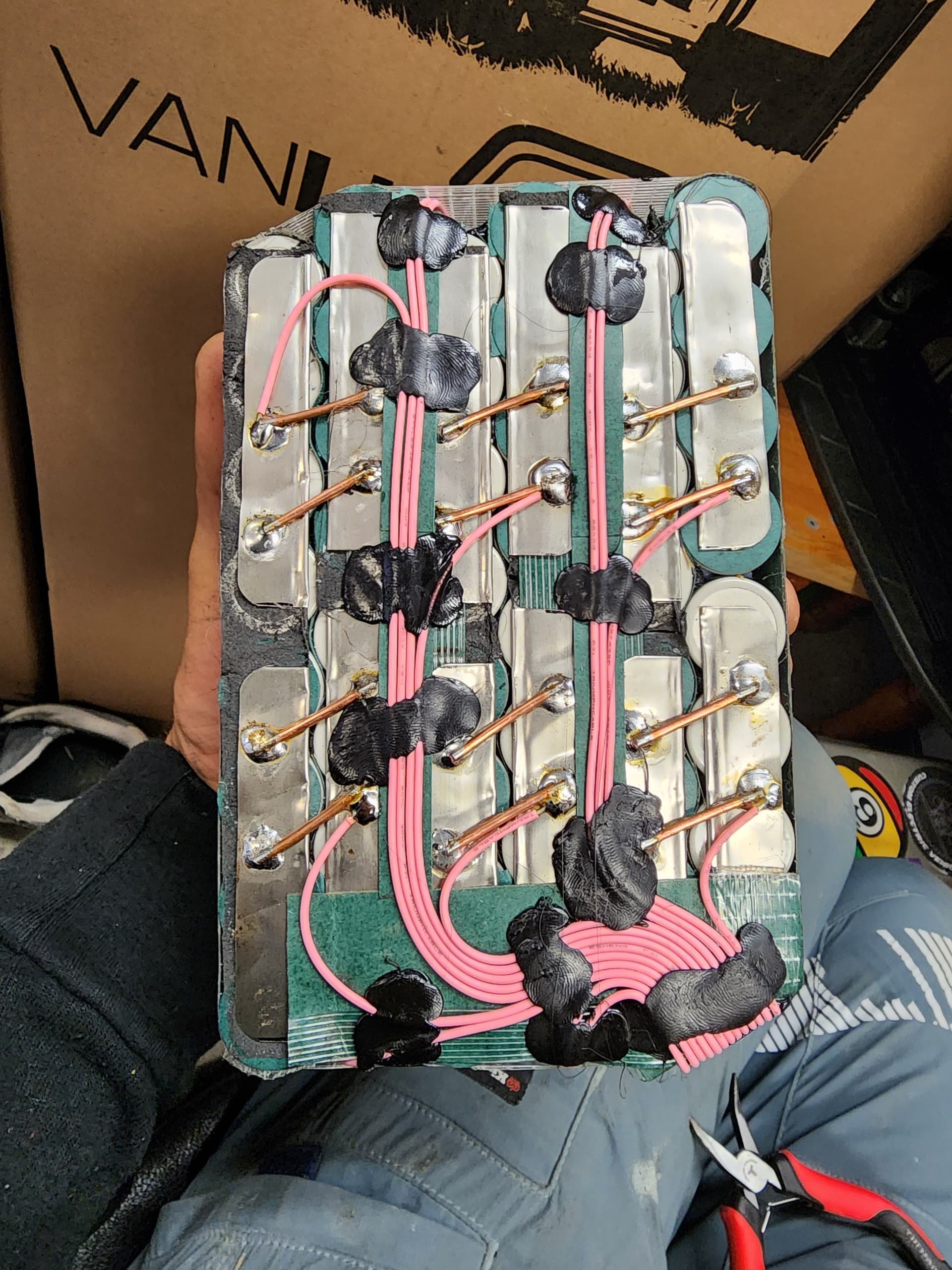

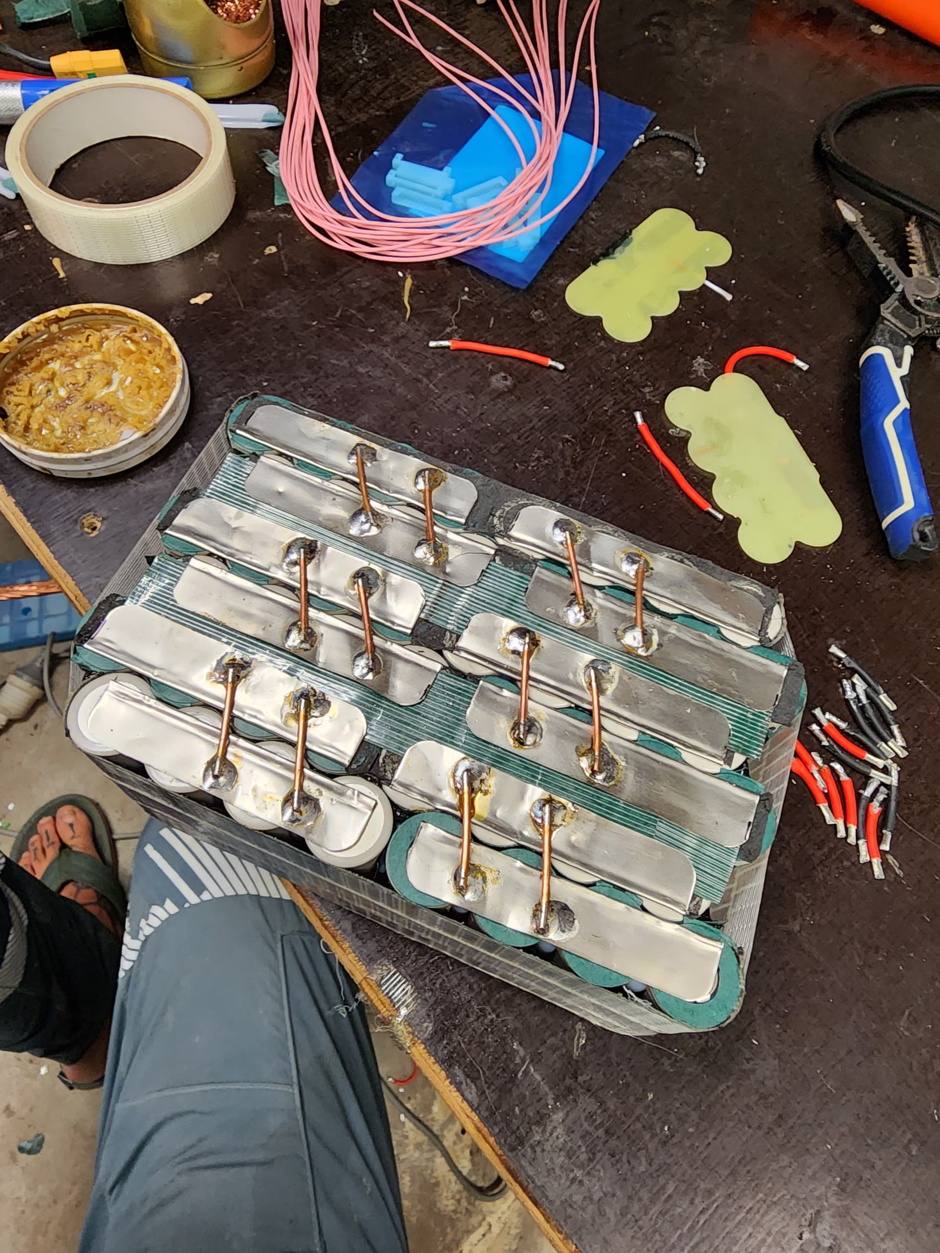

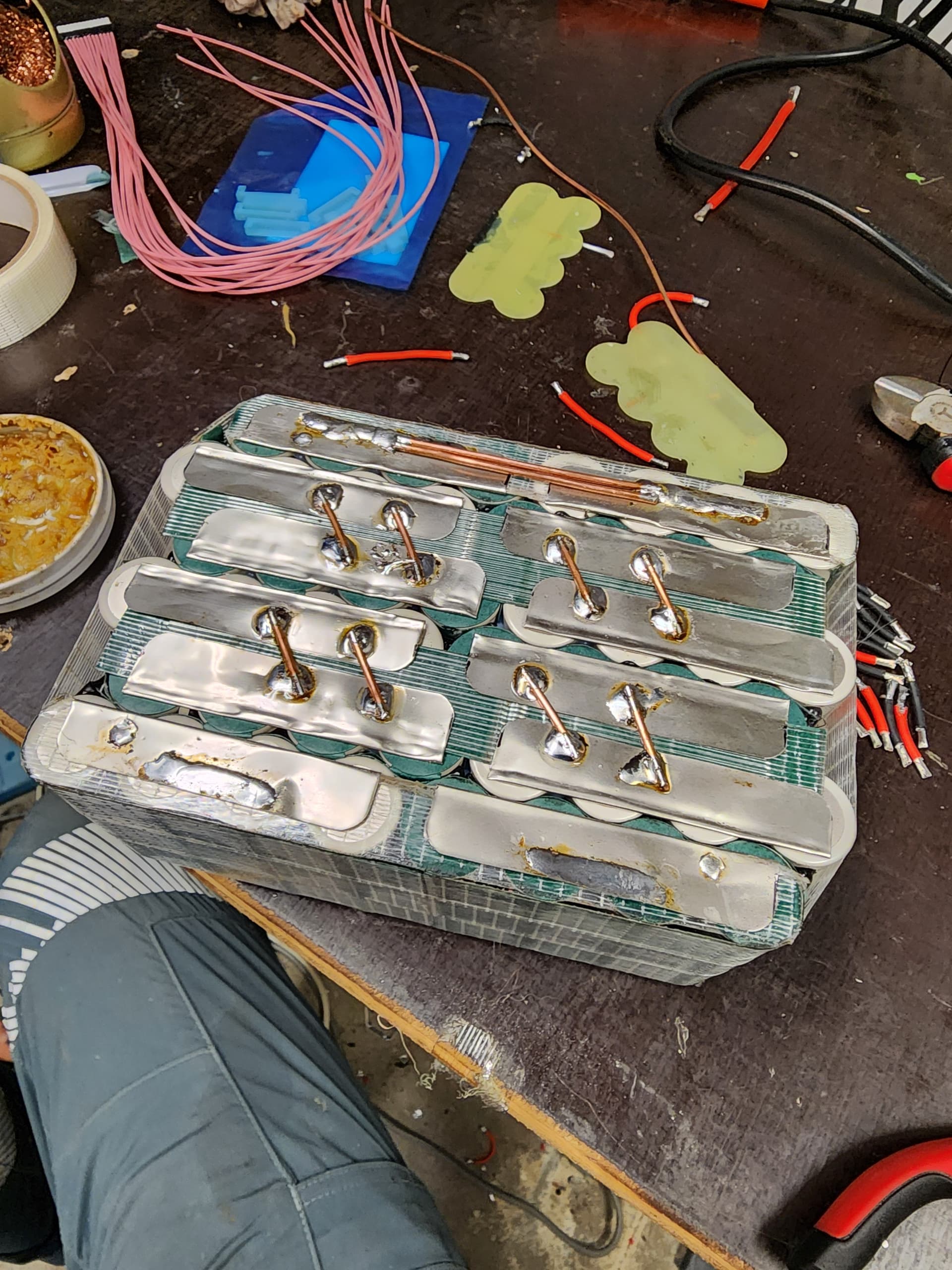

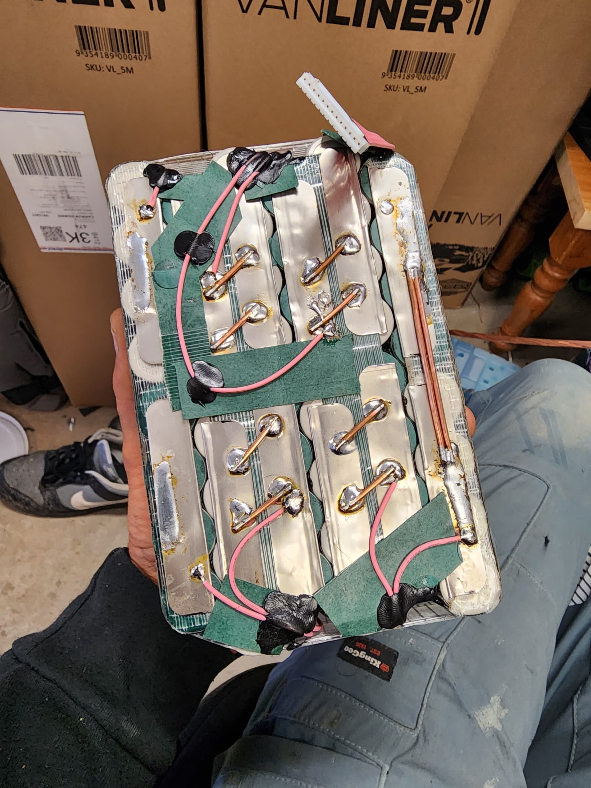

Not my finest work, but making use of what i’ve got!
Its a super tight fit in the box so will be a detached bms setup .
Getting close now!

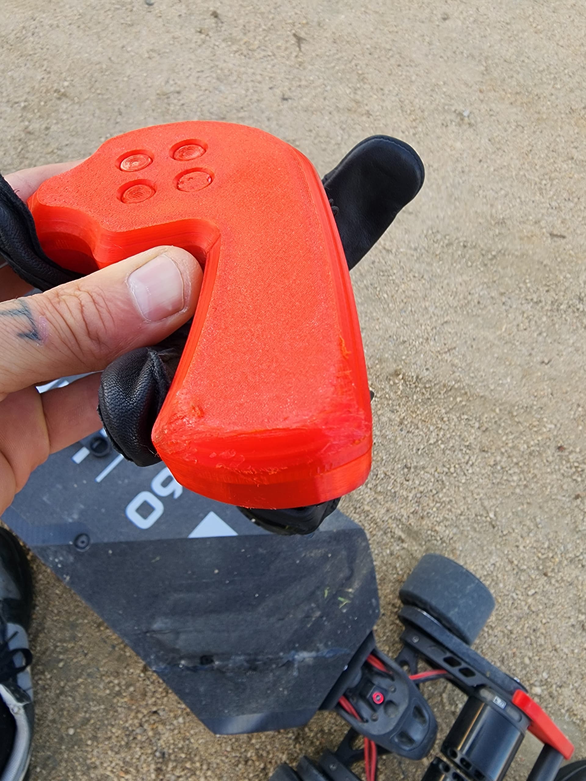

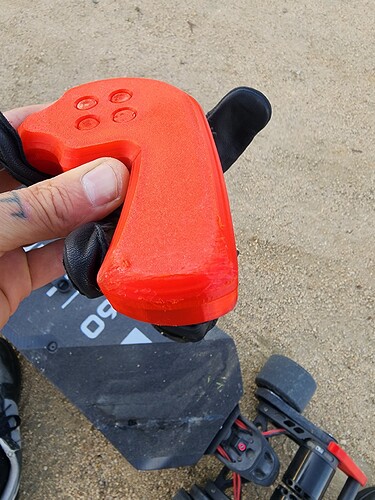

Was also the first ride with DeeP BeeF! Super happy with how it performed, the finger loop is a total game changer :ok_hand::ok_hand::ok_hand: also put it through a little stress test, bottomed out on a gutter and smacked the remote into the ground… scratched but other than that all good :partying_face:
Should probably keep track of how many rides i get in on it before the battery dies :rofl:
