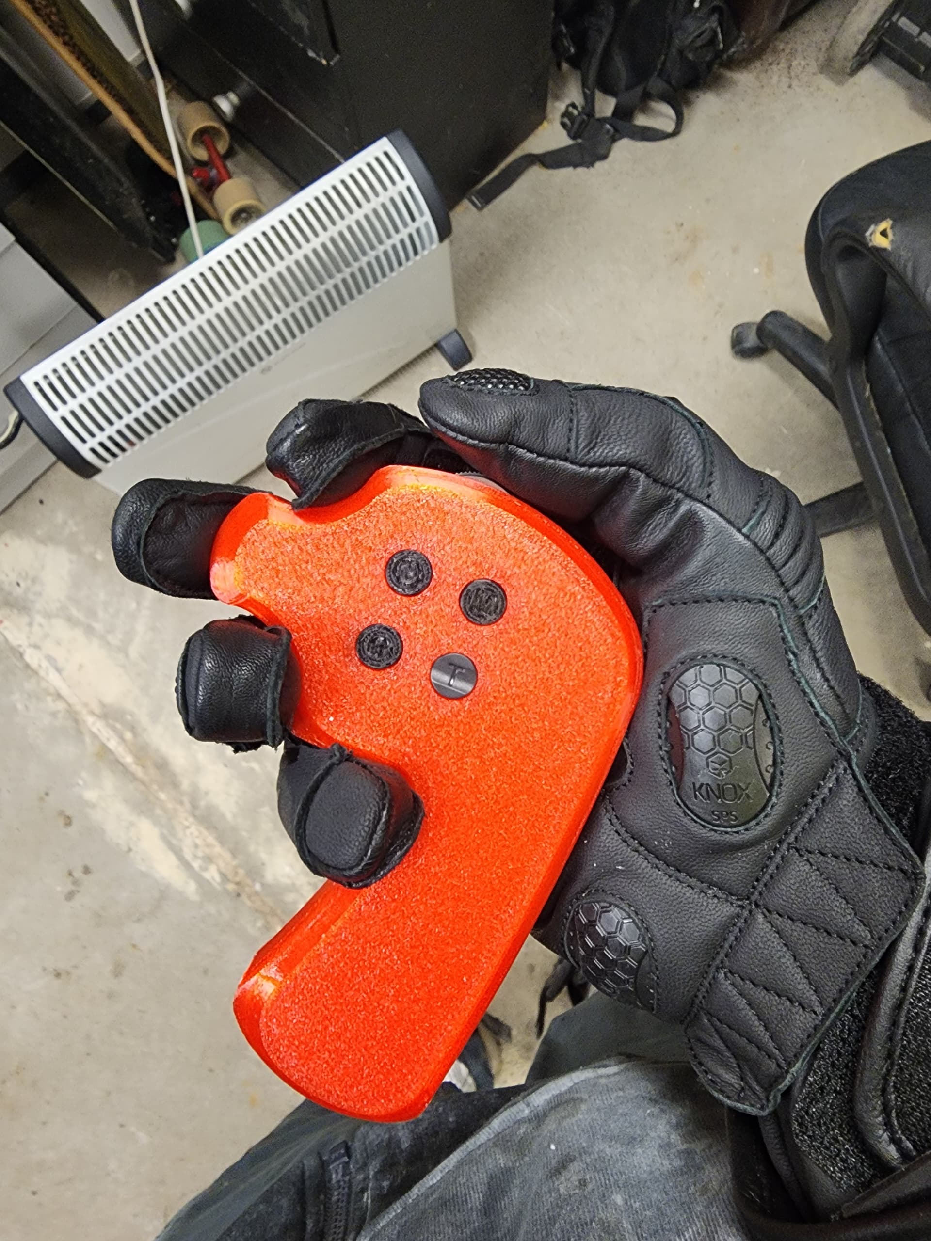

Seriously tho, the bruce shape lends itself so well to gloved use, @DerelictRobot did a great job. I’m just making it better now :rofl:

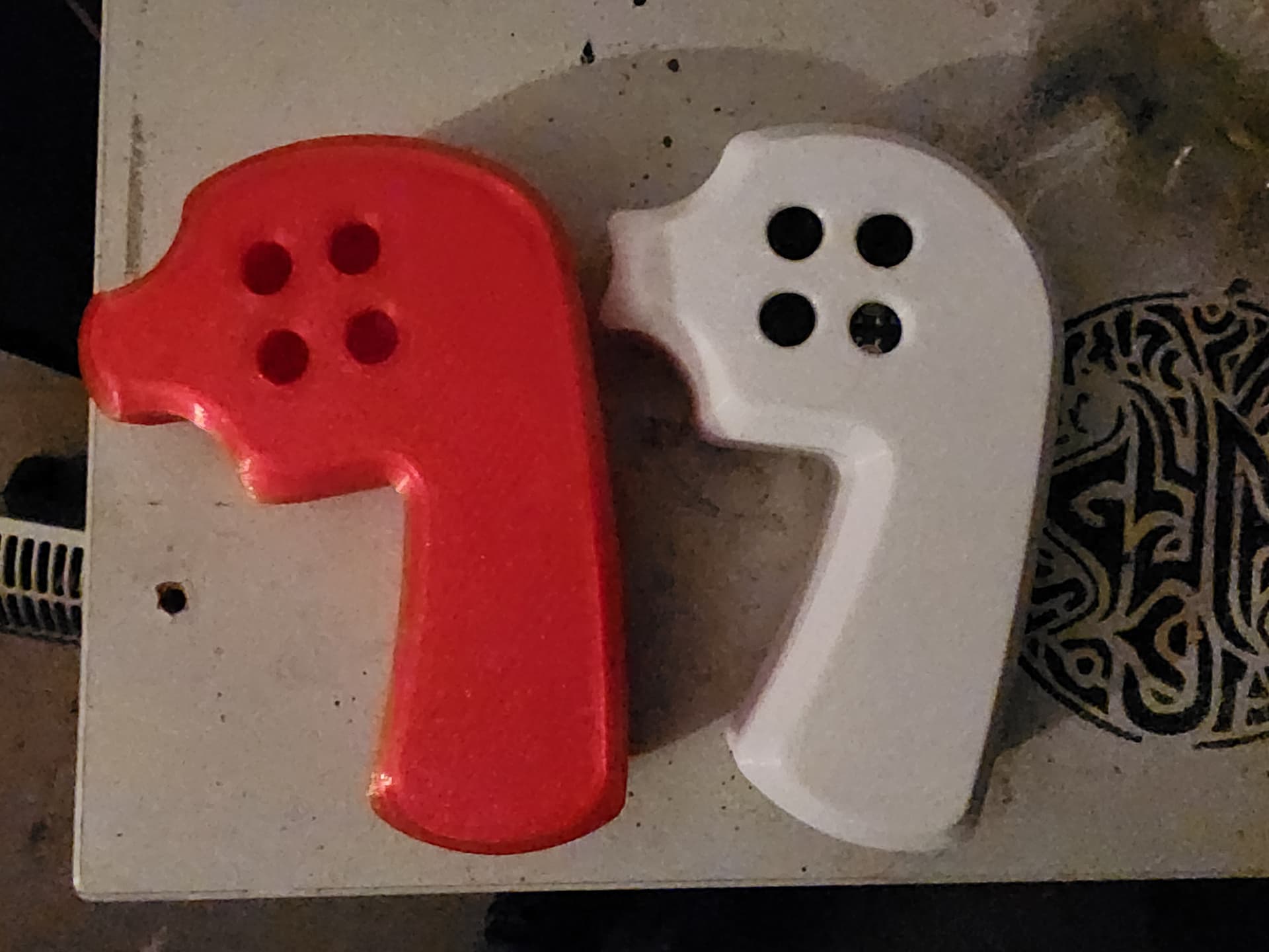

Printing a dummy to test the shape before i go any further with this one
New title please
This is exciting. DuckPuckBruceFuck AKA DPBF AKA and hereforth known as DeeP BeeF has been born into the real world and shows promise!
Tweaks were necessary, the bit for the middle finger was too long and didnt feel right, the shape of the corner that sits in the palm didnt feel good, and it was a little too deep at the back…
But in general it felt a LOT better than the first attempt, so progress is being made :partying_face:
The tweaks have been made and DeeP BeeF v2 is in the bambu oven.
Will see how this one feels and then i have one more idea i want to try with it before finalising and adding screw holes etc
DeeP BeeF v2 is a winner :partying_face:
Not even gonna try the other thing i wanted to do (put a small pinky rest on the bottom shell), it feels great for me as is.
Will add the rest of the details to the design tonight and hopefully have a functional version tomorrow :partying_face:

I feel like DeeP BeeF is ready for action, will give it a once over in the morning before printing it.
