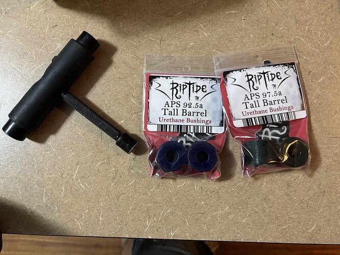

Mach got new (old) shoes courtesy of @BillGordon :pray:
Also got new bushings to tinker with, for now i just put all the new ones in, will play with swapping some of the krank ones into the mix as well.

The double barrel in the front lasted less than 50m until I swapped the roadside back to the krank cone that was previously there :rofl: I’m not convinced on the APS tbh, my past experiences have been good but I don’t think it vibes with this board… will keep playing with bushings.
