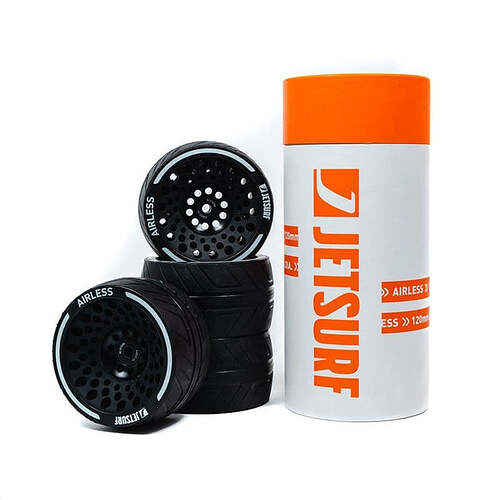

Ah good to know before I ordered, damn. I want free ride wheels so bad ![]()
Rebrand of Flash Airless 125mm

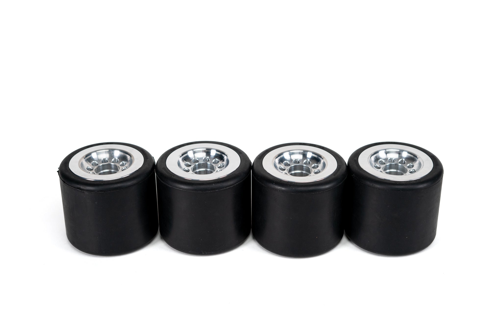

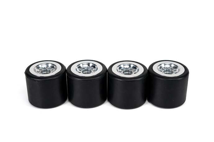

I wonder what these are like
They look harsh… like riding around on 10mm of rubber ![]()
Hub motor vibes for sure lol
