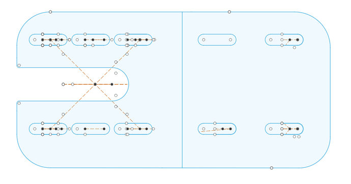

Trying to make a new caster in sheet metal.
Motor mount.
Whats the materials thickness?
Looking good
:heart_eyes: Good job! Love how you did the offset motormount to get the belt inside the U-bracket!
I was gona ask something about bearings but they will be in the wheel as normal…with this design you’ll also be able to throw in every kind of wheel and pulley. Really nice!
Already liking this design more. Is the motor mount connected just by that one bent flange at the top? I’m concerned that could act as a springy pivot point, to let the motor swing inwards when it puts drive forces on the belt. That would lead to a lot of skips.
Just very briefly skimmed this thread as my youngest daughter recently came across a summerboard and wants me to make one. :face_with_raised_eyebrow:
I was thinking 4mm steel
Yes it’s the flange that holds the motor in place, if the 4mm steel is to week and causes some movement I have to think of something to stabilize the design
The belt tension when the motor is powered will be on the same order of magnitude as your body weight, so imagine whether the steel would bend if you stood on top of it
