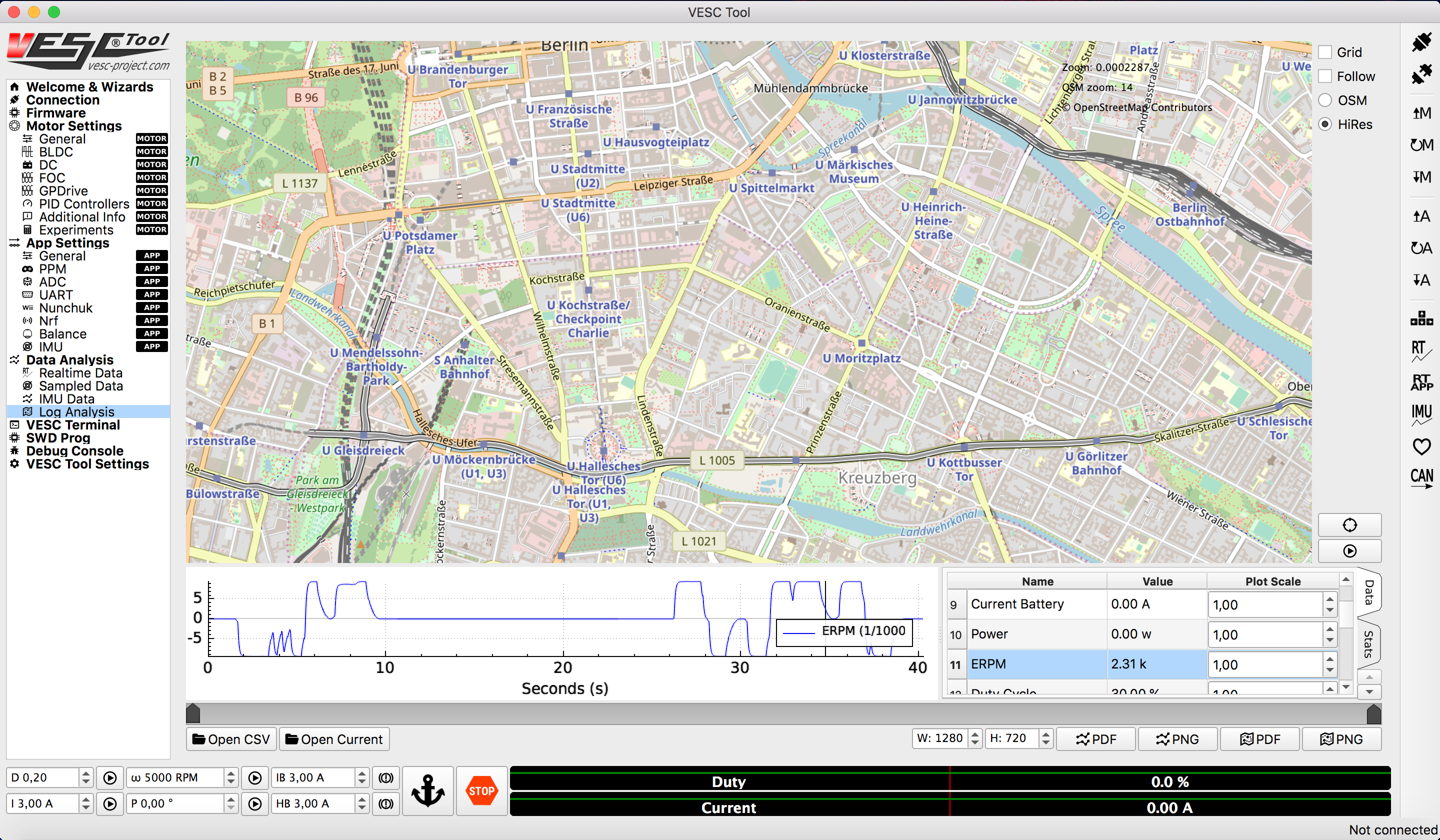

All new 2019 vesc-tool
Looks like you create a csv file with your phone and then load it to your PC and open it in VESC Tool afterwards. So no mobile network connection needed.
