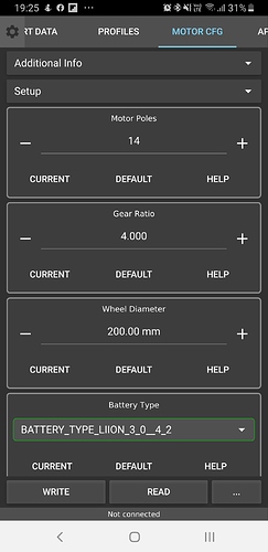

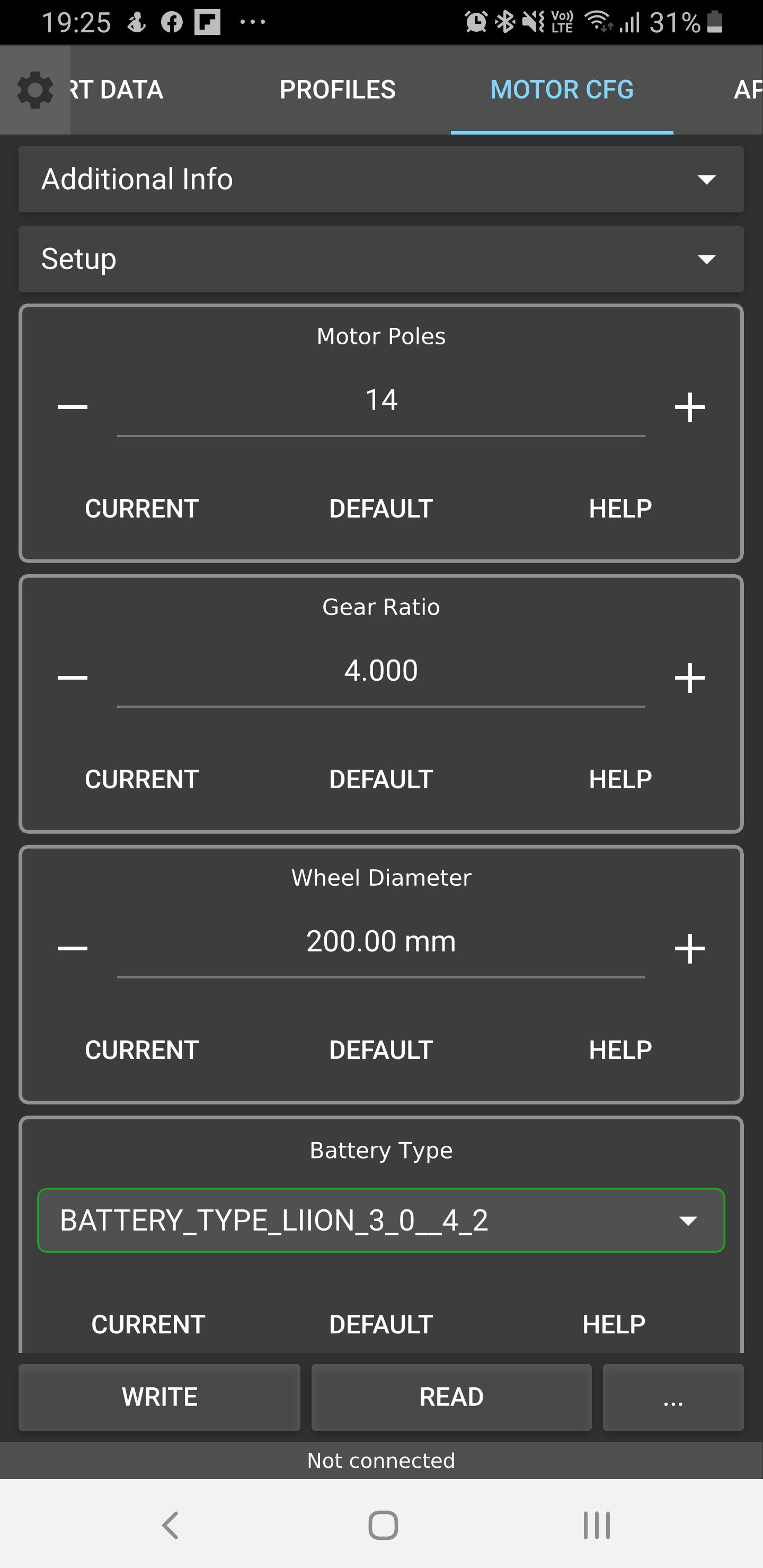

Doh! Of course. He calls it a Direct Drive so I got confused.
https://www.e-toxx-shop.com/trampa/mini-direct-drive/mini-direct-drive-blue/#cc-m-product-9947421470
The gearing is 1:4 but I don’t know the exact size of the gears. @NoWind?
Yeah, there’s a lot of that cross-naming.
Just realised I can set it directly if I know the ratio.
I guess 4 would be the right setting for 1:4 ratio?
Yes, 4 is correct in that case.
Thanks.
I feel like I just reverted to ‘noob’ status.
